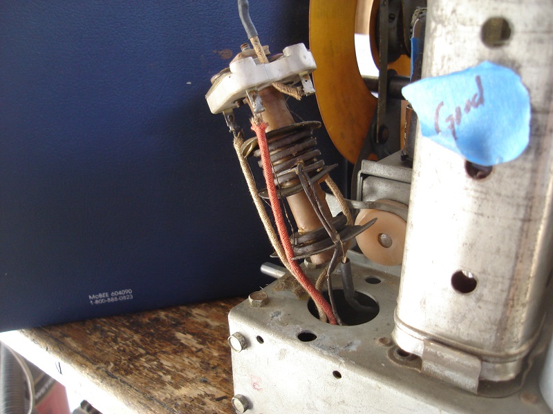

I am getting low volume on this radio with the volume control turned all the way up when tuned into a very strong local station.  I have gone through this radio and replaced all the electrolytics, paper caps, some of the micas, and out of spec resistors.  All the antenna, RF, oscillator, and IF coils show continuity.  In the process of aligning this radio I noticed that I could not get the secondary of the 1st IF to peak no matter how much I turn the adjusting trimmer screw.   I took the cover off of the IF to see if there was anything obvious and noticed that there is a black wire that makes one wrap around the secondary coil between the third and forth windings.  Here is a picture of the IF.  The top coil with four windings is the secondary coil and you can see the black wire with some of the insulation flaking off.
One end of the wire goes to chassis ground and the other end attaches to pin 5 of the 6K7 I.F. amp tube.  I see nothing on the circuit diagram that indicates this.  Circuit diagram is at http://oldtech.net/Philco/37-630p1.gif.
Any ideas as to the purpose of this wire and if it relates to my problem of not being able to peak the secondary of the 1st IF and low volume?

The black wires are a negative feedback winding which was added in later production. It applies an out of phase IF signal to the suppressor grid of the 6K7 tube and serves to stabilize the IF amp. I guess Philco had problems with the IF stage oscillating and came up with the extra winding as a fix. Don't think it has anything to do with your problem unless it is obviously shorted to the secondary winding itself.
It seems that the secondary of the IF trans is not resonating with the associated trimmer and that will definitely cause low sensitivity. Have you measured the actual resistance of the secondary and how does it compare to the value noted on the schematic?
There is not much there to the tuned circuit, so there is a problem with either the coil, or the mica compression trimmer which tunes it to resonance. You can disconnect the coil winding from the trimmer and test each individually.

Thanks for the comments and the purpose of the black wires on the 1st IF.  I replaced all the insulation on this wire.  There was no short between it and the secondary coil.
I isolated the secondary coil.  Resistance is 15 ohms.  Circuit diagram indicates 11 ohms.  No change after connecting to the trimmer.  Primary measures 13 ohms and circuit diagram indicates 7 ohms.  The trimmer and mica piece looked good.

My guess is there is a problem with the mica trimmer. If you loosen the screw and it still does not peak, it seems to have too much capacitance to tune the coil to resonance.
 You can try connecting a mica or ceramic cap in the range of 220 pF to 470 pF to the grid cap terminal of the trimmer (remove coil wire and grid cap wire)  and connect the coil winding and grid cap wire to the other lead of the added cap. This will effectively place the added cap in series with the trimmer, reducing its capacitance, and you can see if the secondary coil will now peak.

It does seem the capacitance of the Philco trimmer is quite low, but if you notice the secondary coil has a lot more turns than the primary and as such will need a smaller resonating cap.
My feeling that you may need lower capacitance is based on your observation that you had the greatest output from the secondary when the trimmer screw was backed out all the way, corresponding to minimum capacitance. Since you never achieved a definite peak, it is possible that even lower than the minimum trimmer capacitance is necessary to bring the secondary into resonance.
My guess is that the trimmer cap plates could have lost some of their springiness and therefore are unable to increase the spacing between them enough when the screw is fully loosened.
