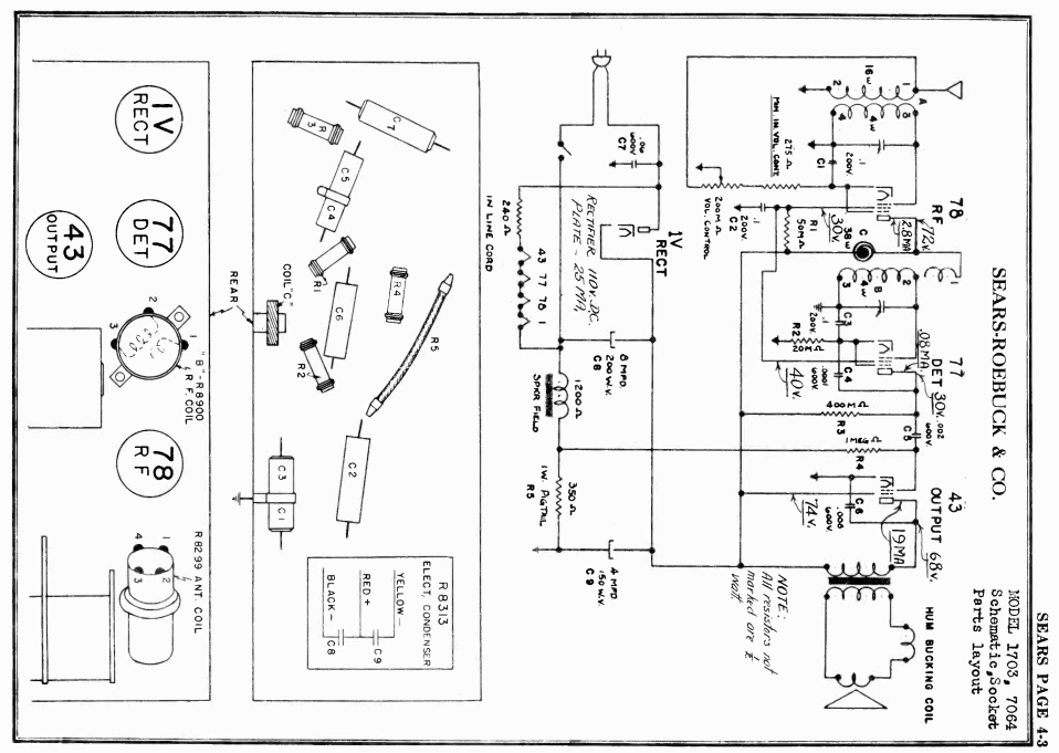

Please ID Cannot find any info or schematic on this..

Sears Silvertone 1764 in riders 4-3
It is the only one with a 1v tube in the lineup.
See link
http://www.grillecloth.com/sylvania/tube...ubmit&db=3
Riders 4-3
http://www.americanradiohistory.com/Arch...34-STU.pdf

Hope your resistance line cord is good! If not you'll need to scare up a 7.4mf non polarized cap to drop the heater voltage.

Where do I find a 7.4uf Cap?

8uf will work,,,,can,,, I ,,have a hall pass to the Shed,,,,I can help clean it out ,,,lololol,,,

Insteadi of finding a 7.4 non polarize cap you could use a 140 ohm resistor @20w or better, and 1N4007.

Terry, I heard that Diodes seem to fail a lot..Maybe that's not true.. Could you draw where in the circuit they should go?
