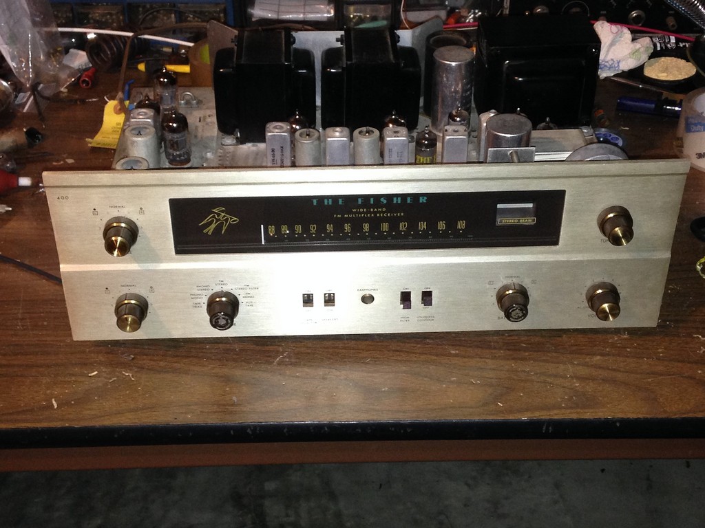

I found mine in May 2016 at Kutztown. Here's a picture I took of it as soon as I brought it home.
[Image: http://www.philcoradio.com/images/phorum...00_001.jpg]
Since I took that photo, I have replaced the two missing brass knob brights, but had not done anything else to it. In spite of knowing better, I did try it out with headphones...and was thrilled to discover that it worked!

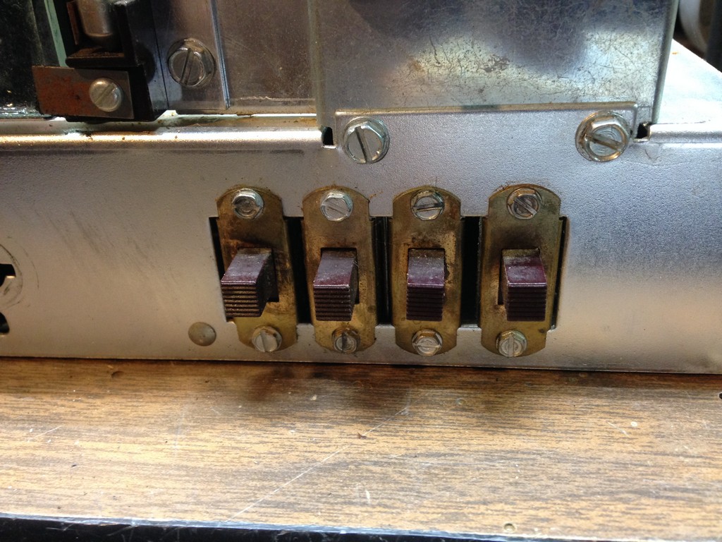

Did you notice something wrong just to the left of the headphone jack, just left of lower center?
Here's a closer look:
[Image: http://www.philcoradio.com/images/phorum...00_002.jpg]

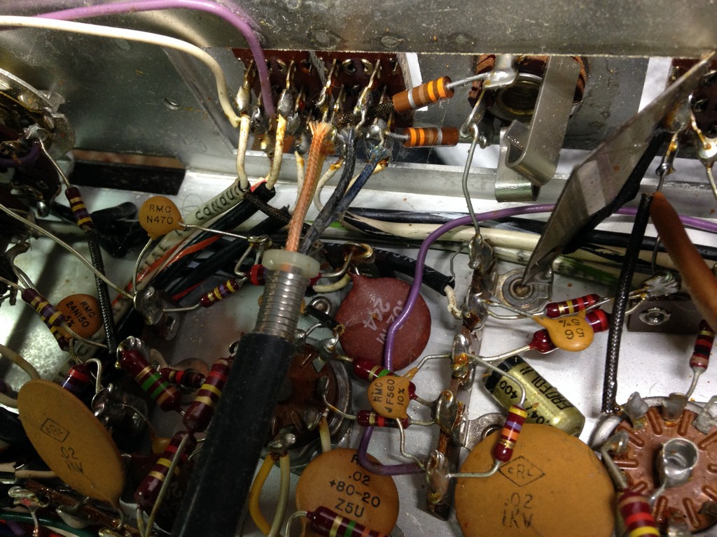

And a look inside at the same broken switches:
[Image: http://www.philcoradio.com/images/phorum...00_003.jpg]
So the challenge was...what to do about those broken switches?

[Image: http://www.philcoradio.com/images/phorum...00_004.jpg]
This is a 1969-ish Fisher 175-T solid state receiver. Notice those four slide switches on the right?
[Image: http://www.philcoradio.com/images/phorum...00_005.jpg]

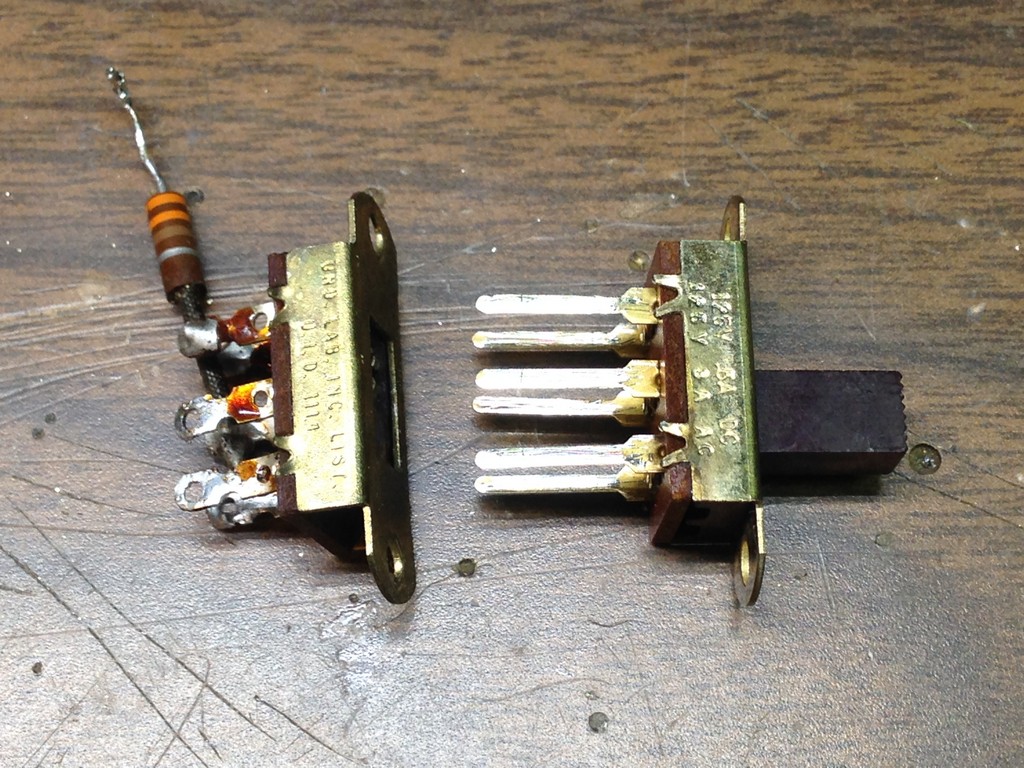

I decided that since I had the junker chassis, I would utilize two of its switches in the 400. They are all DPDT, just like the 400 switches. They are the same size as the original 400 switches. Their outward appearance is the same as the original 400 switches. There was one difference, however...
[Image: http://www.philcoradio.com/images/phorum...00_006.jpg]

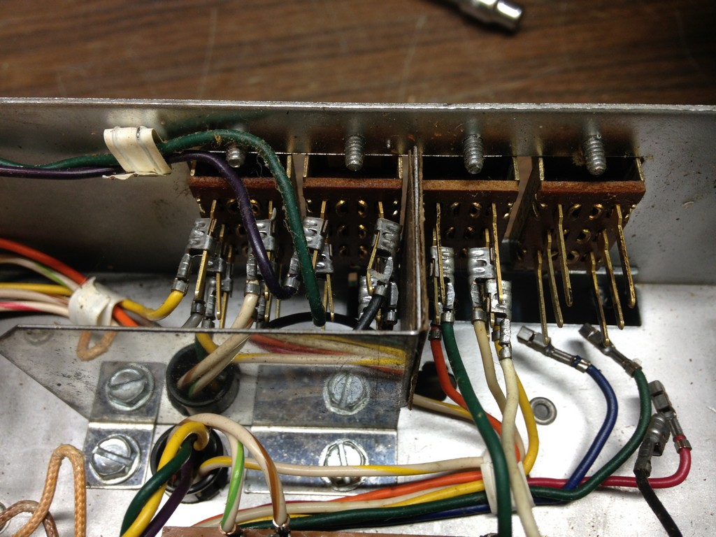

...the 175 switches do not have solder lugs - they utilize push-on terminals.
A better look:
[Image: http://www.philcoradio.com/images/phorum...00_007.jpg]
Other than the connections on the back, they are identical to the original 400 slide switches.

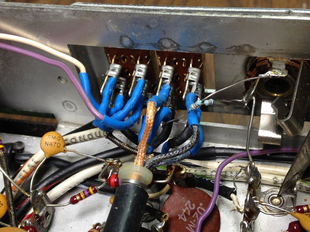

I carefully unsoldered all of the connections from the two broken switches, replacing one switch at a time. I then made lots of splices and utilized those push-on connectors in the 400 as you can see below.
[Image: http://www.philcoradio.com/images/phorum...00_008.jpg]

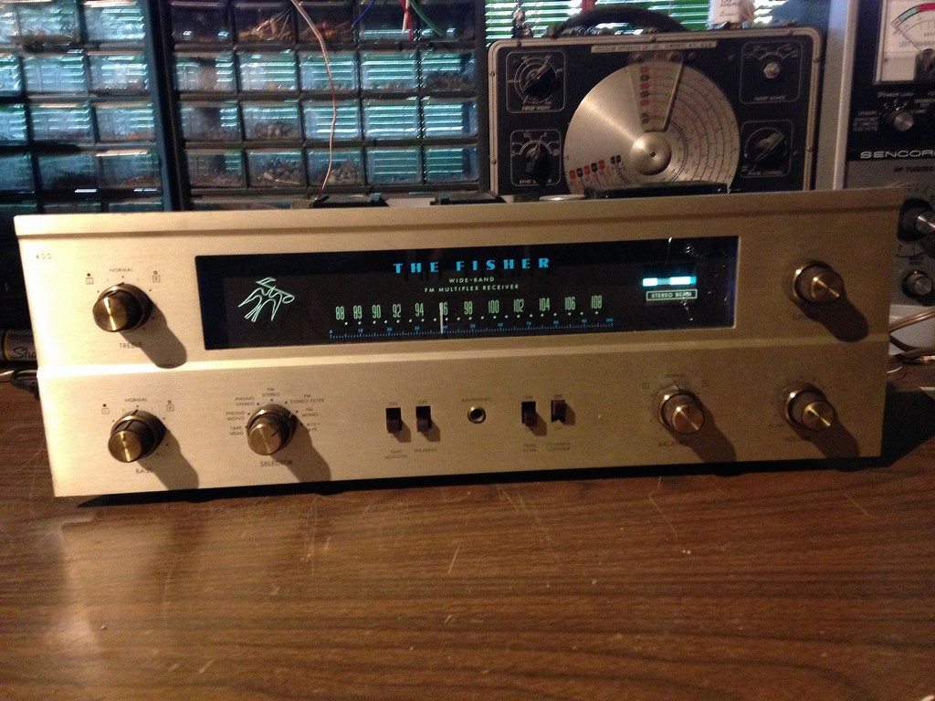

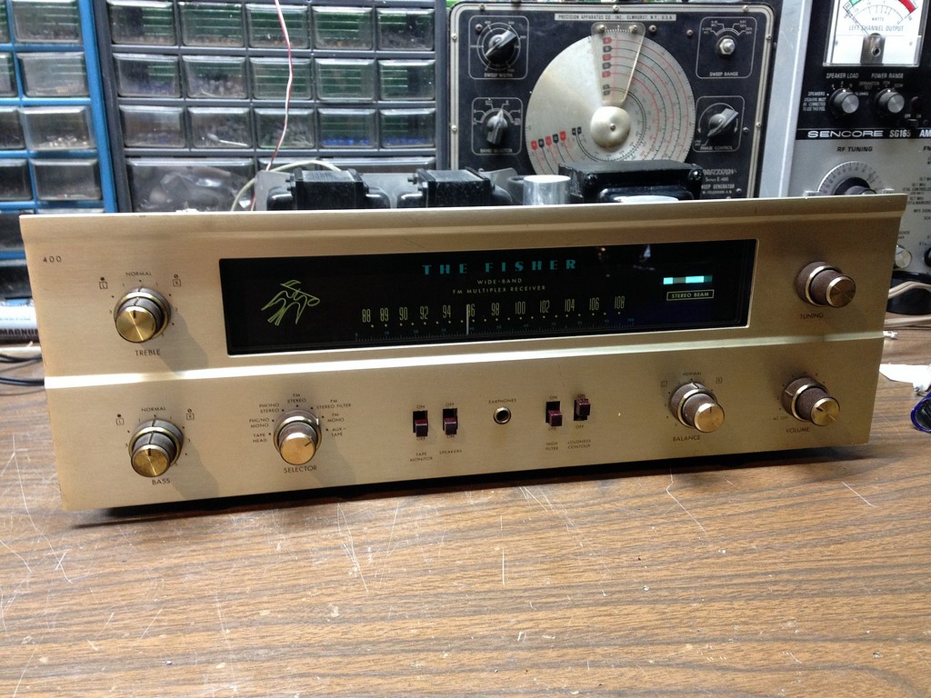

Once I finished installing the replacement switches, I put the face plate back on, hooked up a pair of speakers, and tried it out.
It sounded great...
[Image: http://www.philcoradio.com/images/phorum...00_009.jpg]
Here's another look, with the overhead workbench light turned off:
[Image: http://www.philcoradio.com/images/phorum...00_010.jpg]
It looks much better with the Fisher 175 switches in place of the broken switches.
And if anyone looked at this receiver from the outside, they would never know that two of its slide switches came from a Fisher 175-T solid state receiver. All of the switches look identical.  And the replacement switches function the same as the originals.

You know, if I had to do it over again, I might have tried what Arran suggested. It was probably more work to add those push-on terminals to the 400's wiring than it would have been to switch (no pun intended) the terminal boards, or to put the 175-T switch sliders into the 400 switches. That is, assuming the sliders and actuators were compatible with one another. I've seen two different types of Fisher actuators and they are not compatible with one another.
