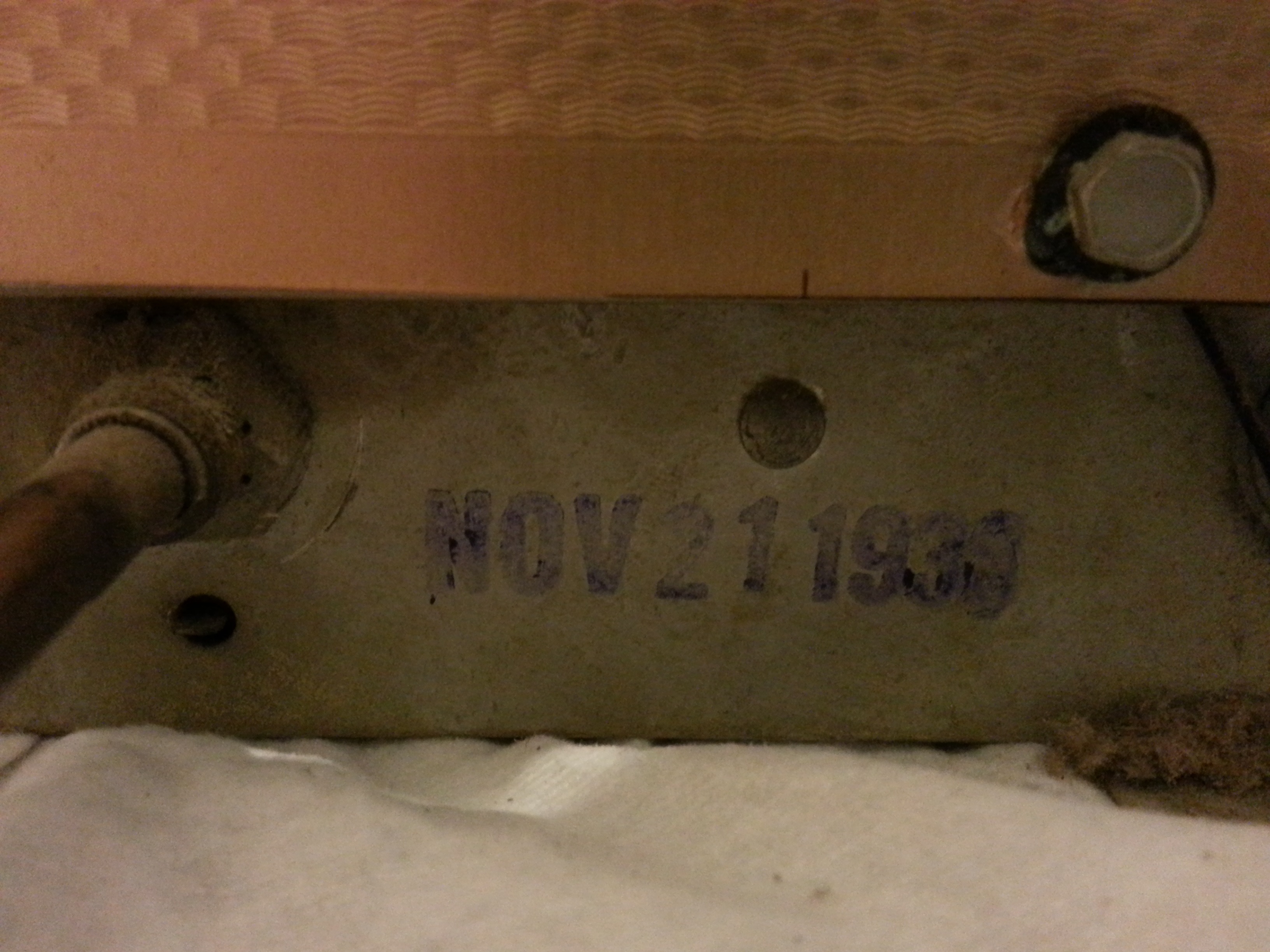

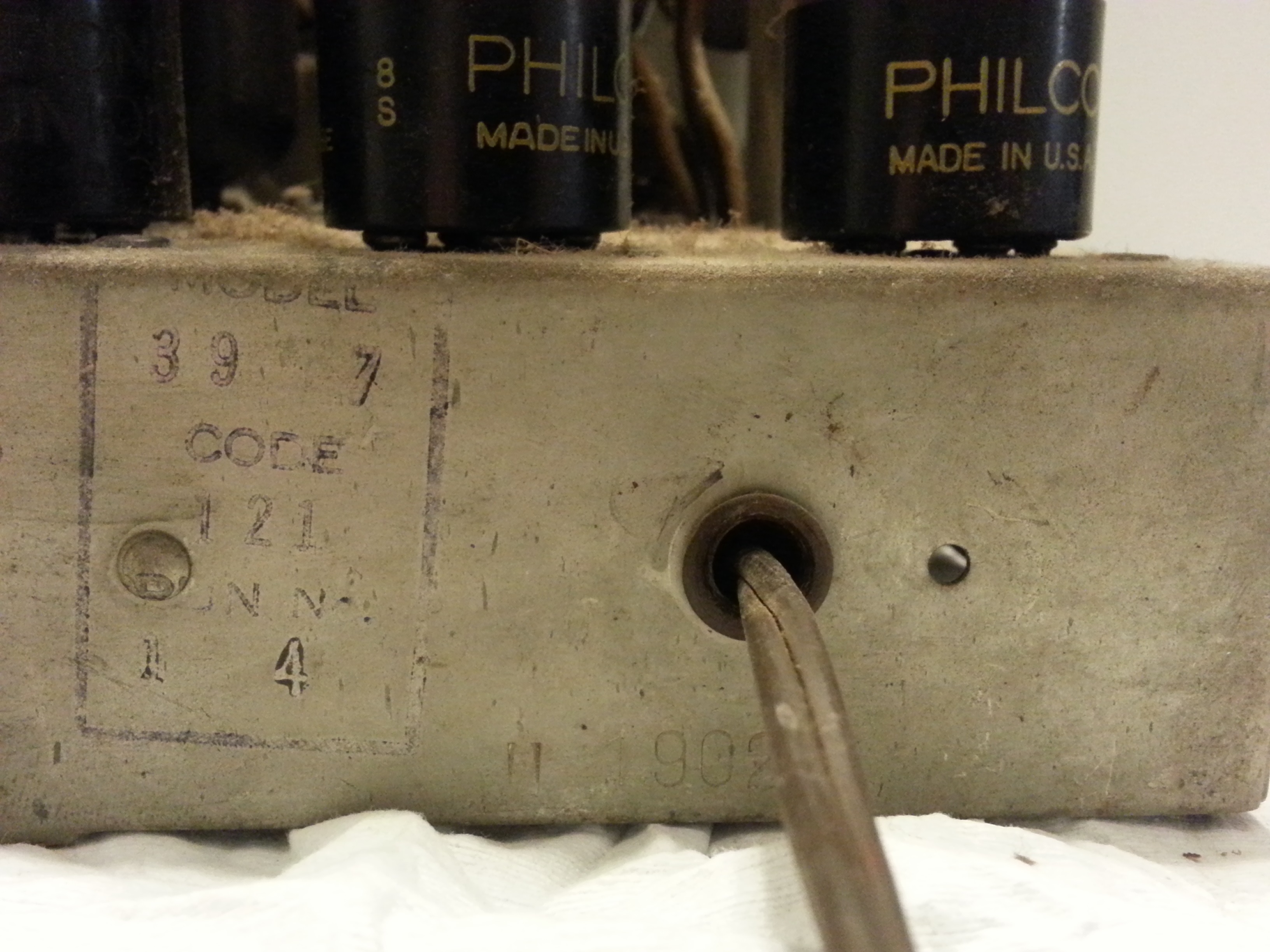

I have a philco 39-7 radio with two purple rubber stamp on the chassis that is are a little faded. I was wondering if anyone has experience in restoring those rubber stamp so they look original. Thanks.
Welcome to the Phorum!
Icon_wave
Actually those look pretty good to me. If it were my set I'd probably just leave them alone unless you lose them in the process of cleaning the chassis.
I had a 39-25 that was very rusty so I did lose my rubber stamped image. The process I used is described in this THREAD. It was just OK, there may be better solutions out there.
I was about to say the same. Would not touch it. Looks good enough.
Thanks guys. I guess the next question that comes to mind is how to protect these stamps while cleaning the chassis? Sorry I am just too new at this and I need to learn some before I go and start cleaning this chassis. Thanks again.
I do not think there is any way to protect them. when I clean chassis I use GoJo (without the pumice) but that will take the rubber stamp off, so for the area of the stamp I just lightly use a damp cloth and get as much of the grime off as I can without take too much of the stamp off.
Thanks for all your advice. I'll really appreciate.
I don't think it needs protection. Just think of it, it survived this long. Just don't clean it with anything aggressive. It'll be fine.
