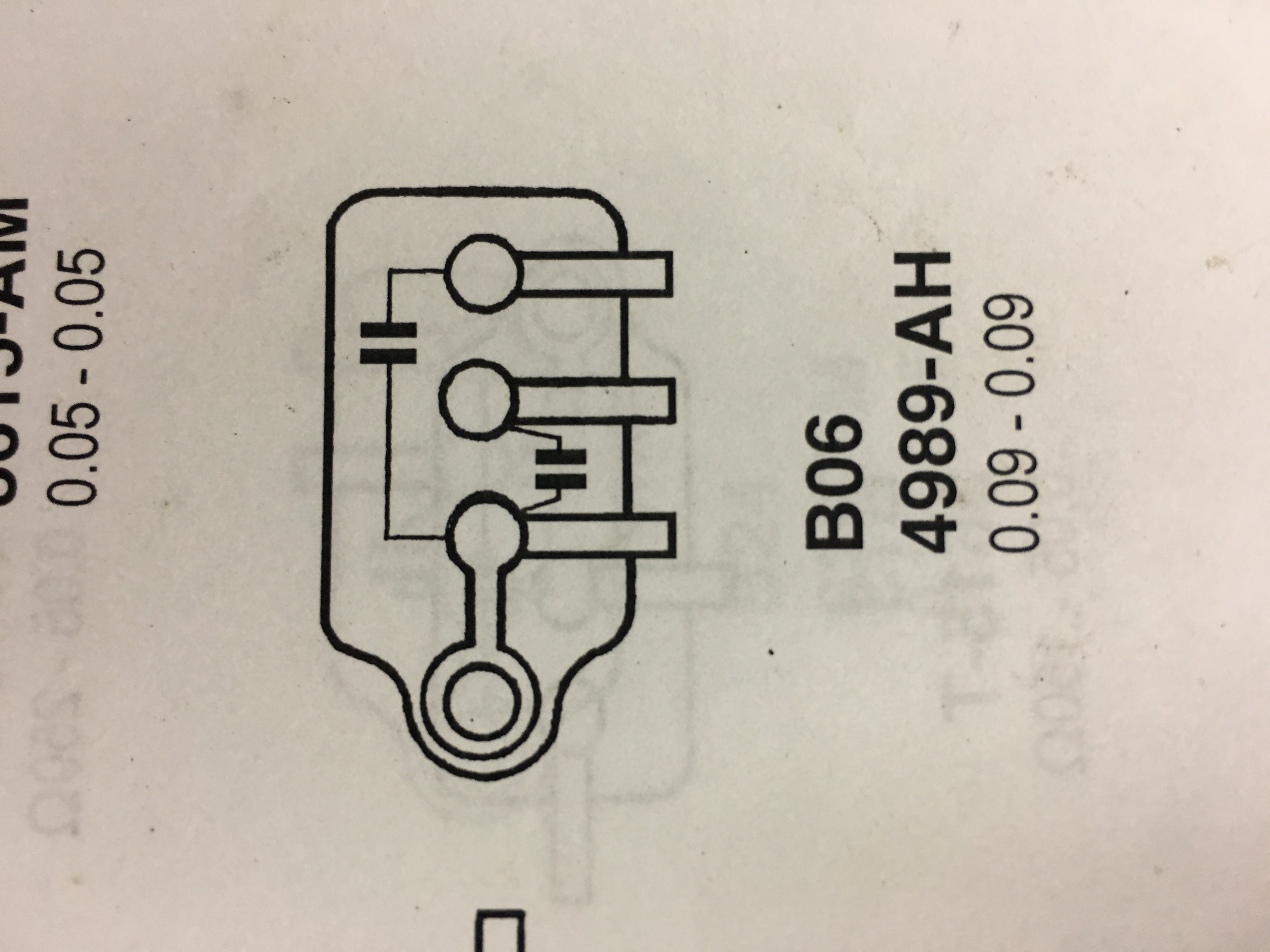

For now, I'm trying to find out what's inside bakelite block 4989-AH. On my chassis, one lug connects to a pin on coil #2 and is (I think) a .09.  The other lug connects to the junction of resistors #42 (1 M) and #41 (99K).  That's called out as 7D (.05 mF) on the schematic but definitely does not go to 7D (all connections to that can are verified).  The third lug is ground.

Here is what Ray's book shows:
Thanks, Nathan, appreciate it! Philco must've gotten a real deal on those .09s ...
