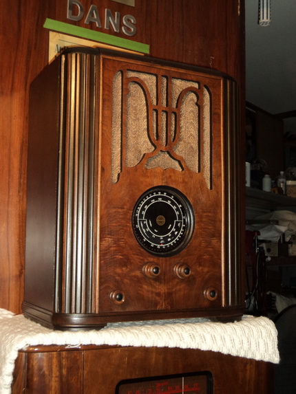

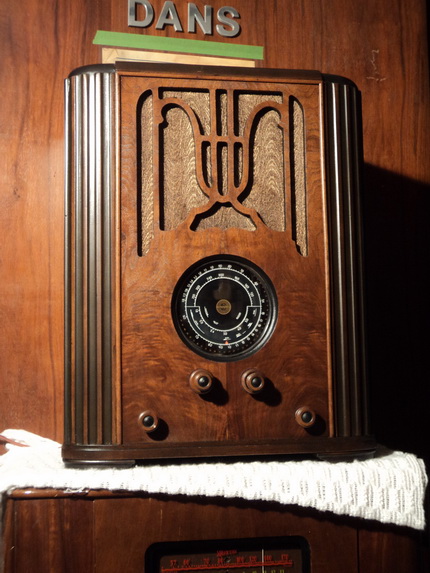

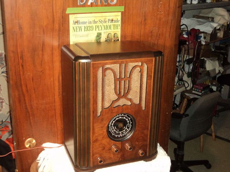

I bought this Northern Electric tombstone radio about three weeks ago and now it is all finished.
   I found that the transformer had a shorted secondary, so I used a new one I had bought for my rogers 10-12 .
 then I found  that the choke somehow got a hole in it and about 20 wires were broke. I got another one from a good friend of mine  and after all that work, the radio plays very well.

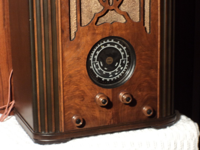

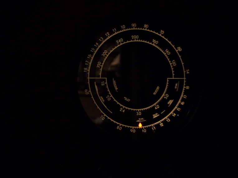

 It does not have a dial but rather a backlighted dial that rotates as you turn the knob. For a different band, a different color rotates around
  The cabinet  took the regular amount of work , stripping ,staining and toning.
Now it is a keeper.

Beautiful Radio Dan, and your interview was really good. Thanks for posting it.
Very nice looking piece, Dan.
I love it...
Super job on the cabinet... A++
Icon_smile
That's a beauty. I love the dial, very classy.
