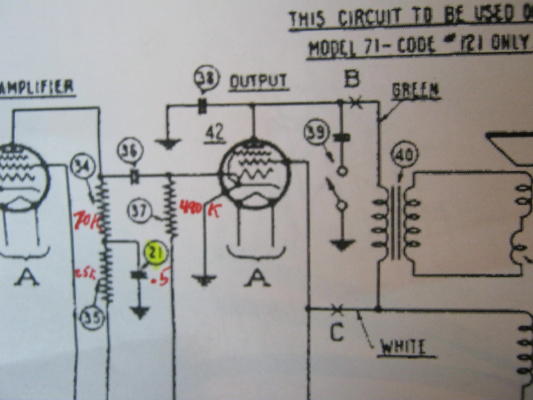

If there is one single cap that the mfr could potentially make to be of higher voltage, that would be the #39. Or, rather, both of them (one is permanently grounded, the other is wired via tone ctl switch).
But I always use 600V caps there.
Just don't unplug the speaker during operation.

If you like for #39 you can use two .02mfd @ 630v in series for the .01, this will equal .01@1260v. For the .02 you can use two .047's @ 630v to equal .0235mfd @ 1260v.
In some circuits that cap is wired across the primary of the output transformer so if it shorted it doesn't really do any damage. In this one if it shorts it take the transformer w/it.

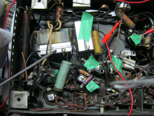

Thanks guys for replying. Just to be clear , which #39  is the .01  and which one is .02uf?  Here's the pertinent part of the  schematic.  I added a shot of what I'm facing with this chassis. It was worked on in the 60's with the capacitors you see that have been added.  You might notice the two yellow Aerovox electrolytics . They  are the 8uf filter caps.  Strangely they didn't disconnect one of the  old filter caps completely and left  some of its connections still connected and the only source of filtering for those connections.  I have been going over the circuit from point to point to make sure that all the connections conform to the schematic. UPDATE: Looking around the forum I did find a post by Ron Ramirez that provides a schematic that has the values written on it.
