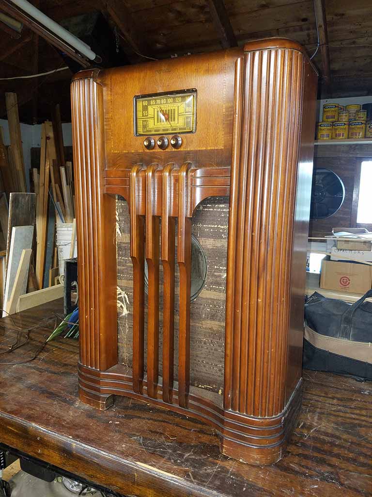

Greetings!  I have a 41-258 floor-standing console that I'm just starting to restore.  Here's my plan so far:
Electronic restoration -- it's 95% original, so I have a big job ahead of me.
The wood cabinet is, to my eye, in great condition.  The finish has a little aging to it, but I'm more than happy with the way it is.
Grille cloth -- I'm attaching a picture of the few scraps that are left. It's metallic gold vertical weave with bulky white cotton horizontal lines.  I've looked around and haven't found this cloth.  Can anyone recommend a source or recommend an appropriate alternate grille cloth that would be appropriate for this model?

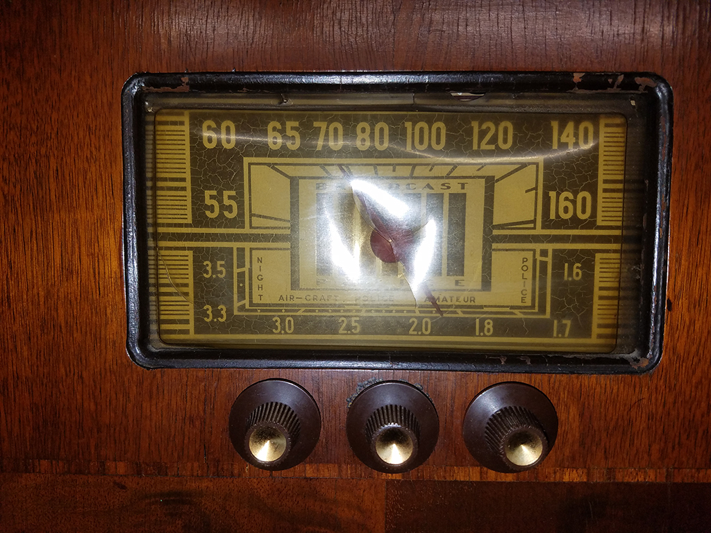

Knobs -- I'm not sure.  My knobs are not original.  I can't even find a clear picture of what the original knobs are supposed to look like.  Can anyone help there?
Dial plate -- The paint is crackled, but adhering strongly to the metal plate.  I like the aged look so I'm not planning to do anything to it.
Speaker -- The cone is cracked all over and the paper is brittle.  It really needs to be reconed.  If I can't recone it I'll just replace it with a modern full-range from Parts Express and save the original driver.
And that's where I'm at.  Any advice or comments would be appreciated!

heres one in gallery  looks to have bullet knobs on it
http://philcoradio.com/gallery2/1941a/#Model_41-258F
cabinet looks to be in very good condition Icon_thumbup

I haven't been able to match the original grille cloth fabric, and I don't like it anyway.  So I went a different route. I found a decent sized remnant of a very handsome upholstery fabric at the fabric store and decided to go for it.  I couldn't be happier with the results:
It's nice to be make a little progress now and then.
It looks decent. (Meaning the cloth).

Knobs look like they are from a 60's Silvertone set. Try Mike Koste or Julie McCall from the Resource section: http://philcoradio.com/phorum/showthread.php?tid=14950
