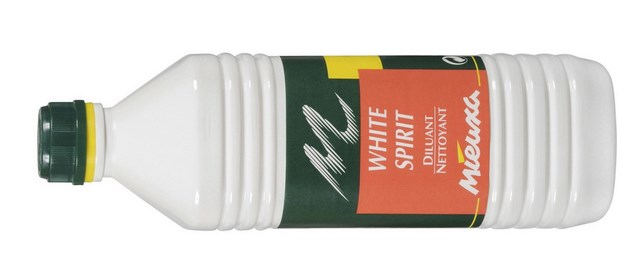

Hello Vinzer , Good morning from France Everybody
Indeed , everybody has , on time , encountered the problem of disparition of the inscriptions on a dial , when trying to clean it .
Please which kind of " mineral siprit " do you recommend to use ???
best regards

I use whatever is cheapest.
Claude,
I'm not sure what product this would be in France but a typical mineral spirit product we would buy in the local hardware store would be something like this one:
http://www.rockler.com/klean-strip-odorl...4XEALw_wcB
I like to use the low odor type just to keep from stinking up the house.
The Material Safety Data Sheet for this can be found here:
http://go.rockler.com/msds/klean-strip-m...ts-sds.pdf
Claude
It is Naphta Lourd in your case (also White Spirit).
thanks mike! I thought you might have an international translation for that product... Icon_thumbup
Hello Friends
Thanks a lot for détails  !
Indeed , White Spirit is a well known product , used for dilution of most of paints or cleaning art brushes  !
I wish you nice week end  Icon_smile
Same way it is known in my language, "уайт-спирит", a transliteration of pronunciation of "white spirit" (oo-eye-t spee-reet). Though we stress the last syllable.
