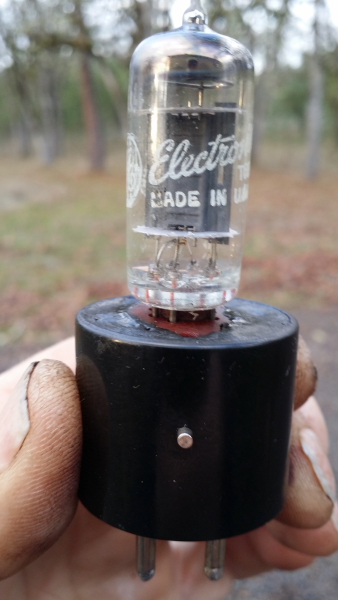

I have thought about this for a while and it is a sure thing that I am not the first. Here is how it goes - build a replacement for the UX201/01A for less than $2.50.
You are gonna' need a 4 pin base like off of an 80. Depending on your radio, this base may or may not need to have the side pin for the Bayonet/UV base - depends on how old your radio is. Then a standard 7-pin miniature socket. These should both be available from your junk drawer.
Then look in your tube stash for a 6C4. I picked this tube for it's characteristics - basically it is 1/2 of a 12AU7 and it is called a power triode by RCA. If you don't have one, E-Pay has some for about $1 some NOS. I just bought 15 about half of them NOS for an average of $1.10 - Sorry, there will be more.
Then 4 wires and a jumper will connect the 2 sockets/plugs. Connect the 7 pin socket, pins 3 and 4 to the big pins, pin 6 goes to the small pin on the right (Pins up, big pins closest to you) and the plate to the remaining small pin. Then place a jumper between pin 3 (fil) and pin 7 on the 7 pin socket. This is the cathode connection.
To test as a 201 use the same settings as an 01A but you will need to lower the bias from about 48 to near 0.
In testing this tube works great as an audio amp including a 171 or 112 . I tested it in my AK 20 in all positions with setting as they were for the 201s and it worked great as a detector and audio amp improving tone and level some and about the same as the 201 in the RF amp sockets.
BUT, BUTTTT it is a 6V tube. Yeah, it doesn't matter. It takes about 10 seconds to warm up. BUT, BUT, BUT the cathode will be damaged - well if it goes to "sleep", just run it at 6V in your tube tester for a while. In reality these tubes were often run at low filament voltages to keep noise down in audio circuits and as a way to get bias for finals - look up some of the Fisher amps using the 12AU7 and 12AX7. It will be fine.
Also it only draws .15A of filament current. This will make your power supply/battery happy.
I potted this one in tar, but I think I'll use resin on the next one.
Not sure how a radio with 5 of these will work.
I'm going to post this on my blog soon, so get your 6C4s before the run.

I seem to recall that 6C4s were used in TV sets, so that may explain why they are cheap and easy to come by. I'm not sure what the specs are however, I will have to look them up in one of my tube manuals. You are right about the heater voltage not really being an issue, though I'm not sure how an indirectly heated tube will respond to being operated through a rheostat. Along these same lines I wonder if you could use another common, though slightly more expensive tube such as a 6K6G/GT, with the plate and grids tied together, those are 300 ma tubes as opposed to 250 ma for a 01A, though they might not work dues to the B+ in a 20s battery set being capped at 135 vdc.

Instead of using a 6c4 a 6J6 maybe a good choice as they are plentiful and cheap.

Guys, the 6C4 is really cheap, around $1.
As I said it is 1/2 of a 12AU7.
One of my objectives was to equal or reduce filament consumption since most of these radios are being run on power supplies. The 6J6 draws .45A. Five of these are gong to be rough on the rheostats.
I have run this conversion through every position and setting on the small box AK20 and it works very well. The only thing I have not tried is running 5 of them in the same radio. It may be a while before I make 5 of them.
I just completed adaptors for the UV and UX-199 as well as the UX-120. These use a different tube(s). To me, this adaptor is much more useful. Most UX tubes are not that hard to get but the UV tubes are becoming expensive - and I would not want to blow one up while testing a restoration.
I do not intend to make any of these to sell but I thought some of you might need some for the same reasons that I do.
(This post was last modified: 12-06-2017, 12:24 PM by Phlogiston.)
I like the idea.  Thanks for sharing, Russ.
Years ago I found that a 1G4GT worked great as an 01A substitute, with a suitable adapter. Only thing is, they require far lower filament voltage (2 volts), so you have to make a complete set of adapters for a five tube radio.
I have a few three dial sets including an AK 20 Big Box, Super-Zenith VIII and a Slagle, so I would like to try the 6C4 tubes (with adapters) sometime for myself.

If it is possible to run the 6C4 on AC filament voltage it would require all 5 tubes to be replaced. This would probably still result in some hum since the cathode is jumpered to the filament.
I agree on the looks. I would not display a radio with these in it. My intentions were to use them for testing. The fellow that made similar substitutes a few years ago had some test tube glass to cover them with - even silvering some of them to replicate the getter. Maybe somebody could find some at a lab glass vendor. I haven't looked.
