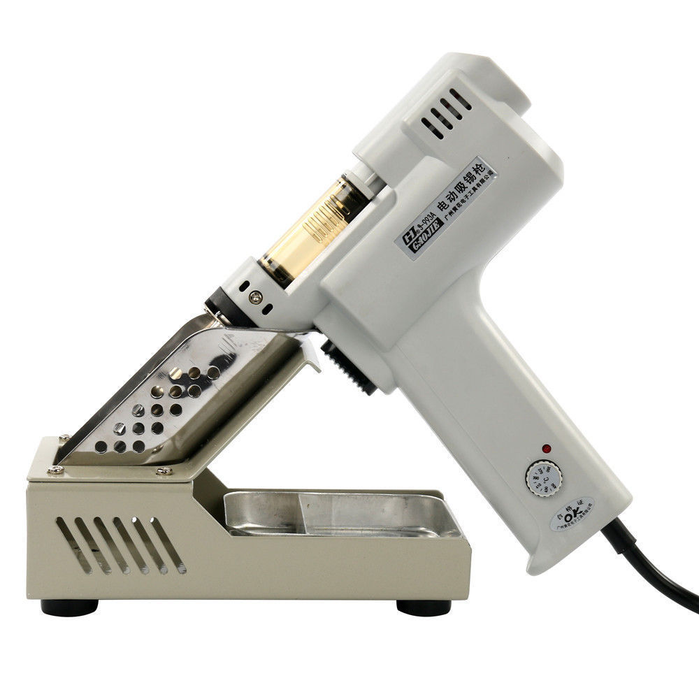

I found this on Ebay. Has anyone used this or something similar? I went to replace a solder sucker that shot across the room in about 3 different directions and found this. It looks it would work nice on our electronic repairs and restorations. Any thoughts either way?
https://www.ebay.com/p/US-Local-Ship-S-9...0005.m1851

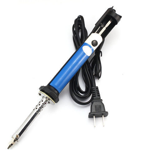

Also found this smaller desoldering tool: https://www.ebay.com/itm/30W-Electric-Va...0005.m1851

I don't know what the heck that first dohickey is, but the second is a perfect way to ruin a PCB pad.
I could see it doing that. Normally I use solder wick on a PC board unless there is some big blob. The 1st is a pistol grip version, like a soldering gun vs a pencil iron. I was thinking it may be nice for those wads of solder we get into on some of these hand wired chassis.
