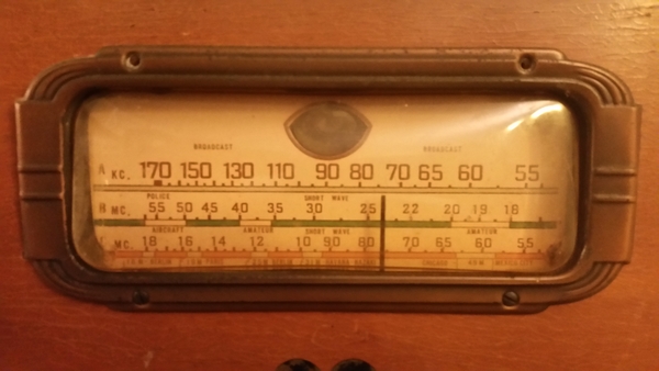

The web offers very little on this 3 band AM + 2 SW set. It also has presets. I found only 2 clues so far. Vintage info was helped by the valves carrying shop test labels dated 1941, and I suspect these are only a year or two post manufacture.

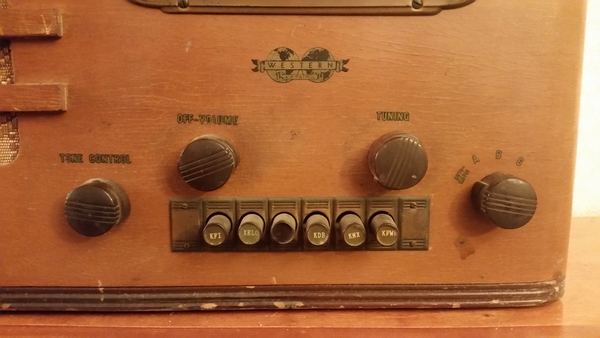

They do seem rare, and the trail I found on the brand suggests sets commissioned from several manufacturers, rather than being a radio "house" in their own right. Parent company seems to have been based in Los Angeles, where we obtained the set. Google reveals some spectacular consoles.
This one has modern styling for the time (if I am correct about that). It also has a push pull output stage, magic eye indicator and good sized power transformer. On that basis, not a bargain basement design, but good quality. I will check the valve lineup later.

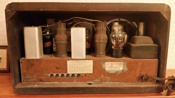

Tube lineup of the Air Patrol's valves is:
6A8, 78, 75, 6J5, 42 (2 off), and 80

Judging by what I see of the cabinet, I'd say it was a candidate for a cleanup with GoJo and a rub down with Howard's and then a wax job..... Refinishing, for me should be avoided, unless absolutely necessary. The world has enough unnecessarily refinished radios already! (and yes, I have refinished radios)

I completely agree Steve. Originality is valuable to me, and I like to retain it if at all possible, especially unique details of the cabinet such as decals. I might touch up the toned/darkened areas.
Rust, on the other hand is of no value, and I'd like to stop it in its tracks. The whole top surface of the chassis is in similar condition to what can be seen above. If the set shows promise electrically, I shall want to deal with halting the rust, removing it and possibly painting over. The condition underneath is not yet known. And no - I haven't plugged it in ;)

That chassis looks kind of like a Packard Bell one, do you know who made the speaker?

Let me get in there and take a look... I promised myself no tinkering until I'm suitably finished with the Philco Console, and there is still a little work to do there to get it back together in the cabinet, check to see if there is any more regluing needed, make a back for the speaker compartment etc. If I start pulling this set apart, next thing the soldering iron will be switched on and, well, you can guess the rest...

Ed if the set is pre WW2 when you get into overhaul check to be sure the short wave bands are still hooked up. Sets on the West coast during the war may have had these band made inoperable. David
