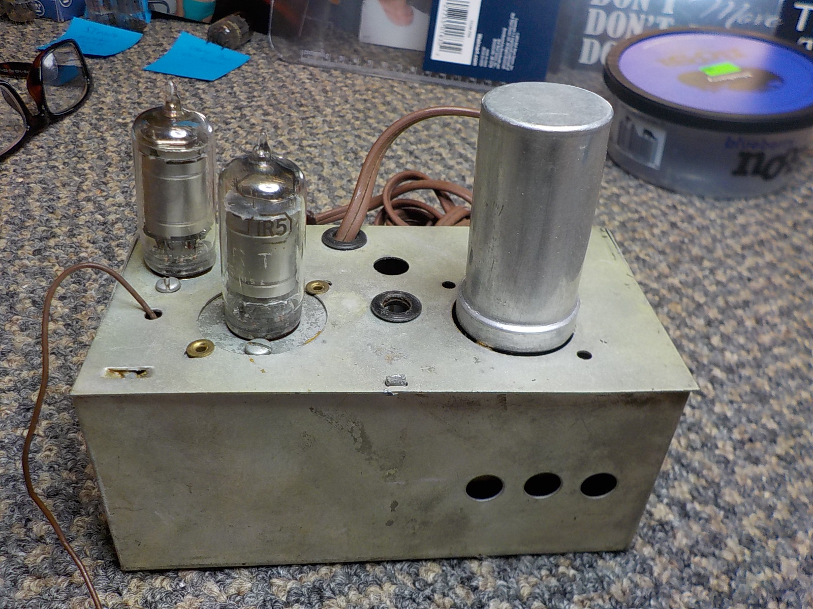

Mike Osc AM radio transmitter?

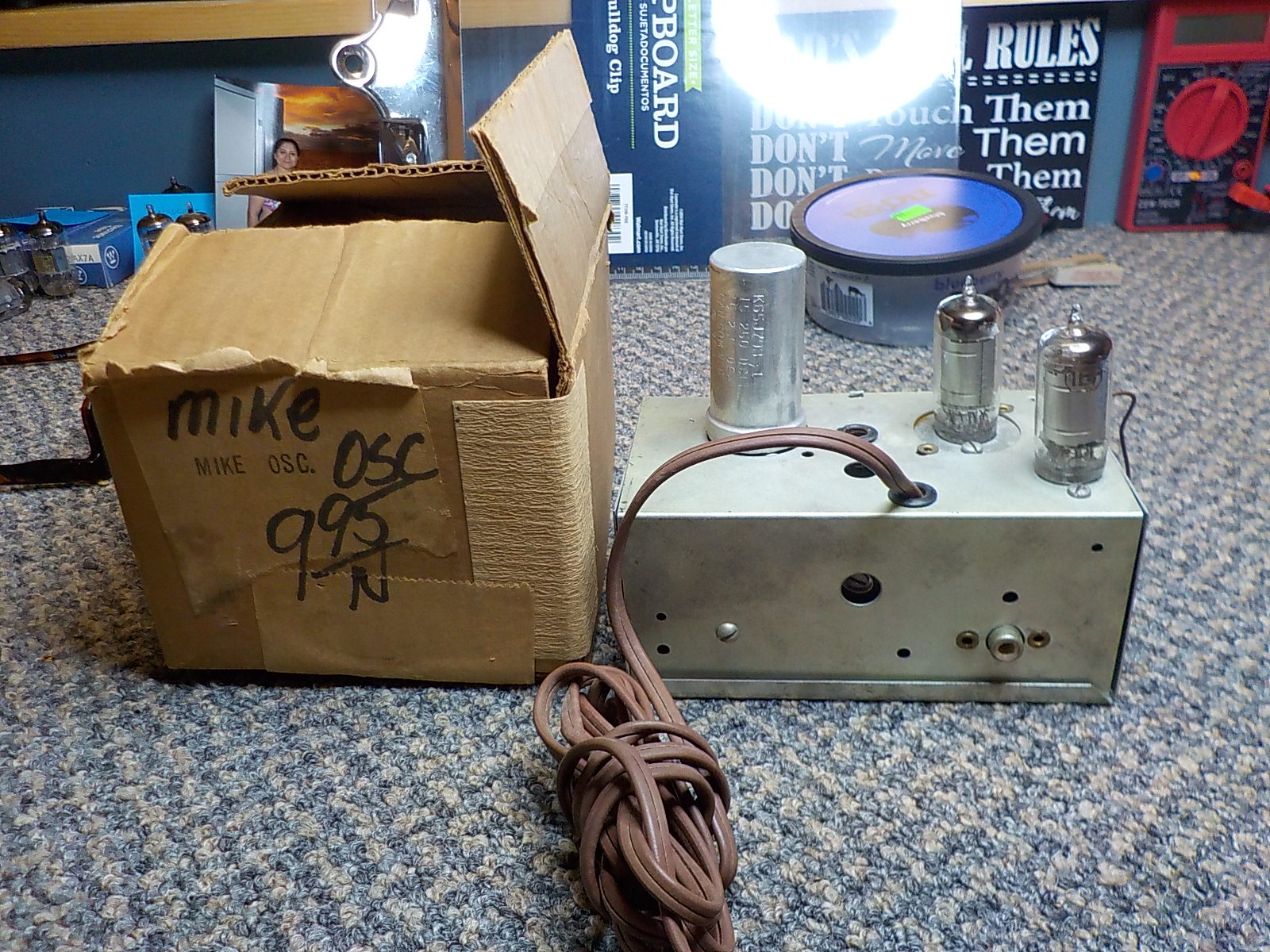

Ok, so I am full of projects over the last month or so, and this guy is another attempt at something different. An Ebay find while bidding (and losing Icon_neutral ) on a Heathkit AM transmitter. This one was a lot less $$$. I am guessing made in 1953, judging from the markings on the box. It has 2 tubes, 1L4 and 1R5. Both test good. I am sure this is not a powerhouse, but something to play with. What I don't like is that this is a live chassis set. I will put a polarized plug on it to help. I make a cabinet for it if I like the way it works. If not, I may use it for parts to make something else.

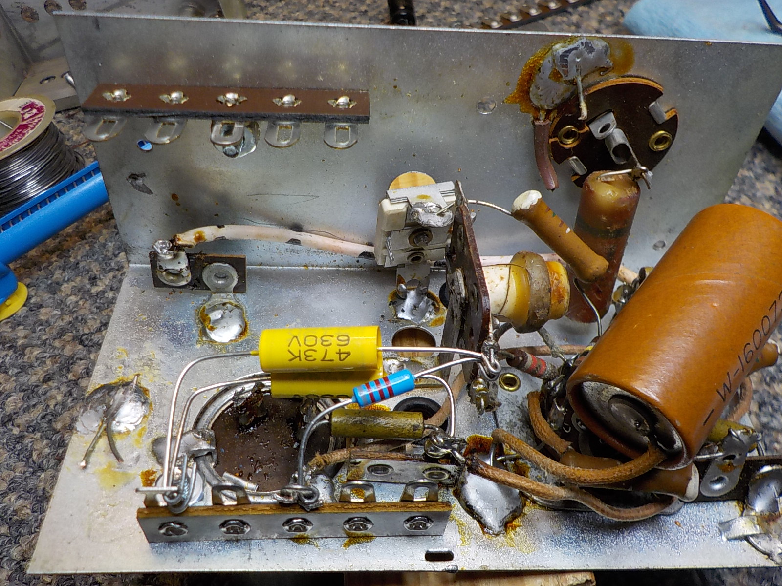

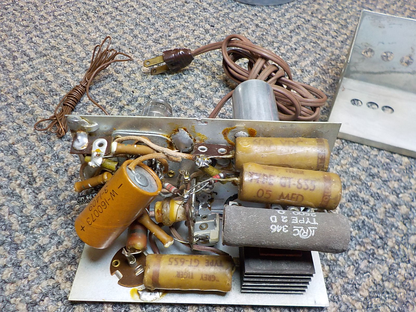

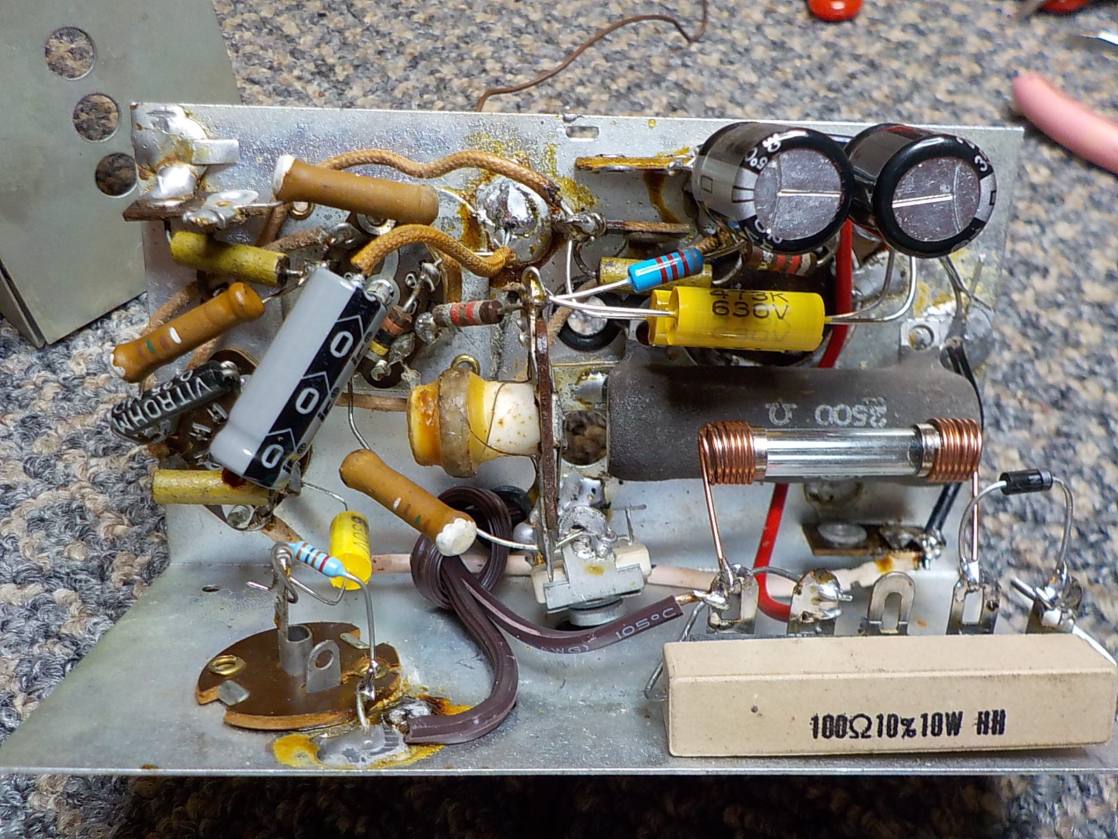

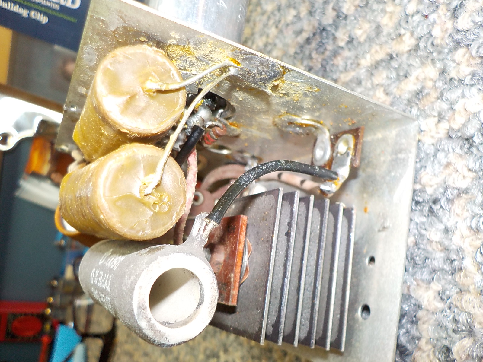

I started the recap by getting a lot of stuff out of the way and checking the fittament if a couple of terminal strips. The can was bad and had some fluid that had bubbled out. I am sure that the previous owner had 'tested' it.

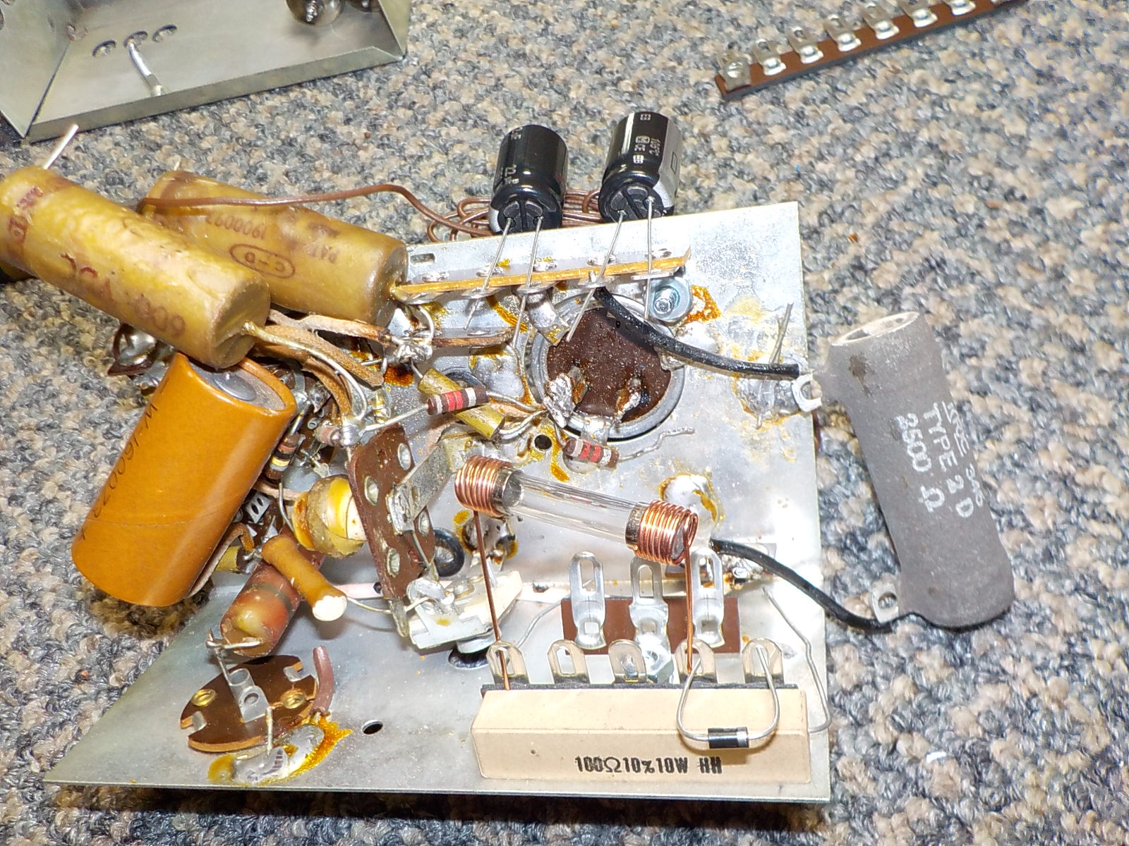

Here I set the new capacitors in place, trying to follow the original  layout. I found one 8.2 k resistor up to over 9k, so I replaced it.

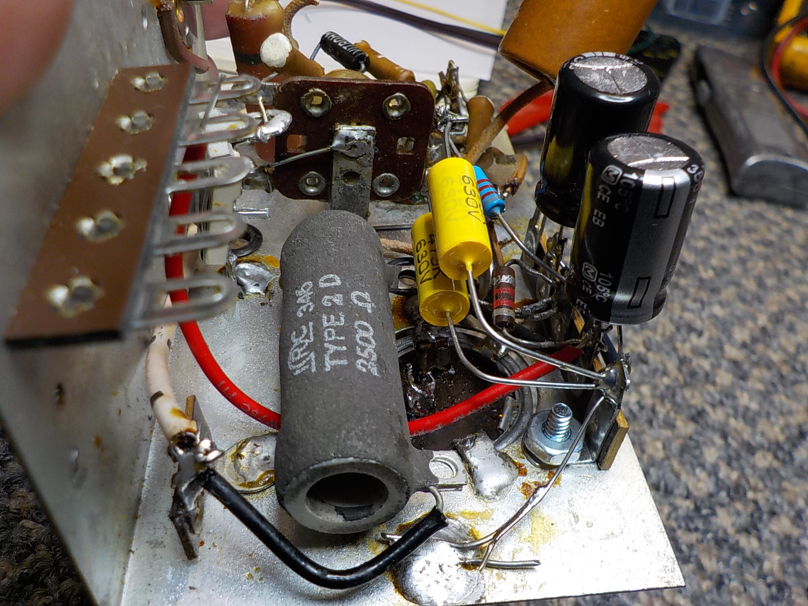

Soldered everything in place. That big resistor is in the filament string coming of the raw B+.
Tim

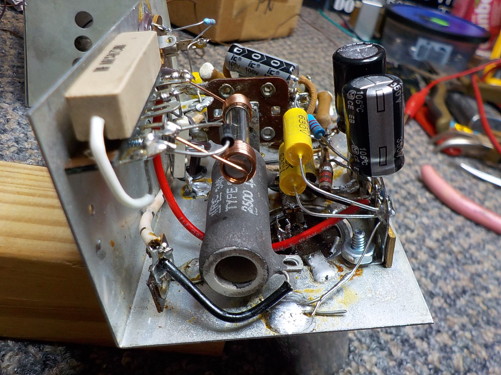

Here are a couple shots of the finished recap. I added a 1a fuse in case the diode shorts. After a couple of tries with different dropping resistors, I settled on a 100 ohm 10w. Runs barely warm. This put my B+ at 95v and the voltage across both tubes filament at 2.8v at 120v line. The tube filaments are connected in series.

Been experimenting with this some. I don't really note any change in sound quality by changing the value of the input cap. I am getting some kind of drift tho. I think that 2.5k resistor is heating things under the chassis and causing something to change, so I connected a sub outside of the chassis. This is keeping things much cooler inside, but now I have this really hot resistor hanging off the chassis somewhere. Any thoughts of subbing a zener or series of those to drop the B+ from 130v down to around 3v? Need to find something workable, but with some kind of protection for those tubes filaments.
