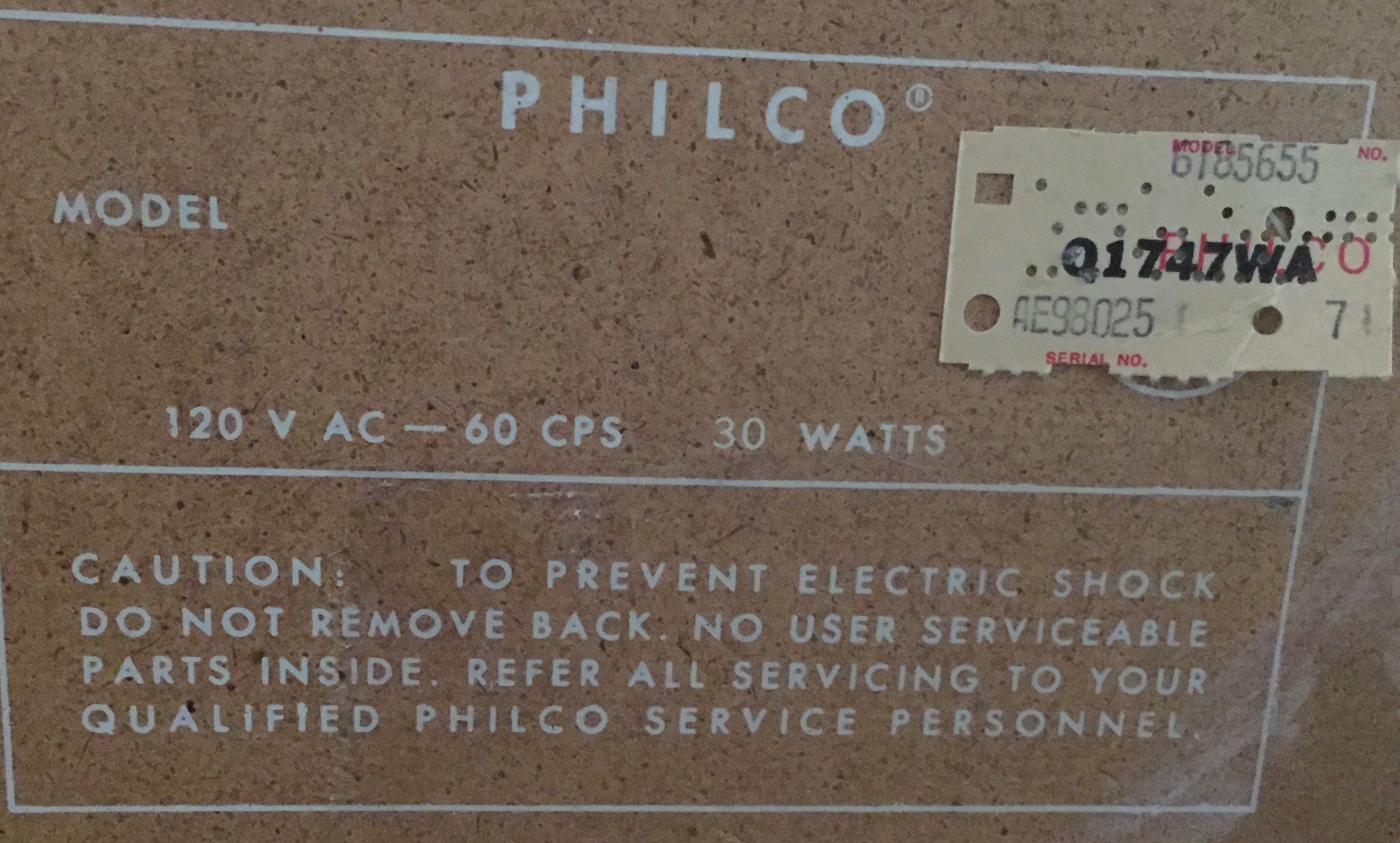

Hi new here. I have inhareted a beautiful Philco consol/radio from a family member and I’m having some problems with it. First when I power it on I can here a hum but the turntable will not move or play and the radio will not play. What could i be missing? Also I can’t seam to figure out what’s model I have. The sticker on the back states that it is a 6185655 model but I can’t find anything on the web with that number. Any help would be great thank you.

That sticker doesn't sound like a model number. Have a look at this guide to Philco identification and see if there's any other info you can provide:

Thanks for the reply. This is what’s on the back of the cabinet.

It'd be probably better if you have just shown the radio itself.
It is most likely a mid 60's console combo.
