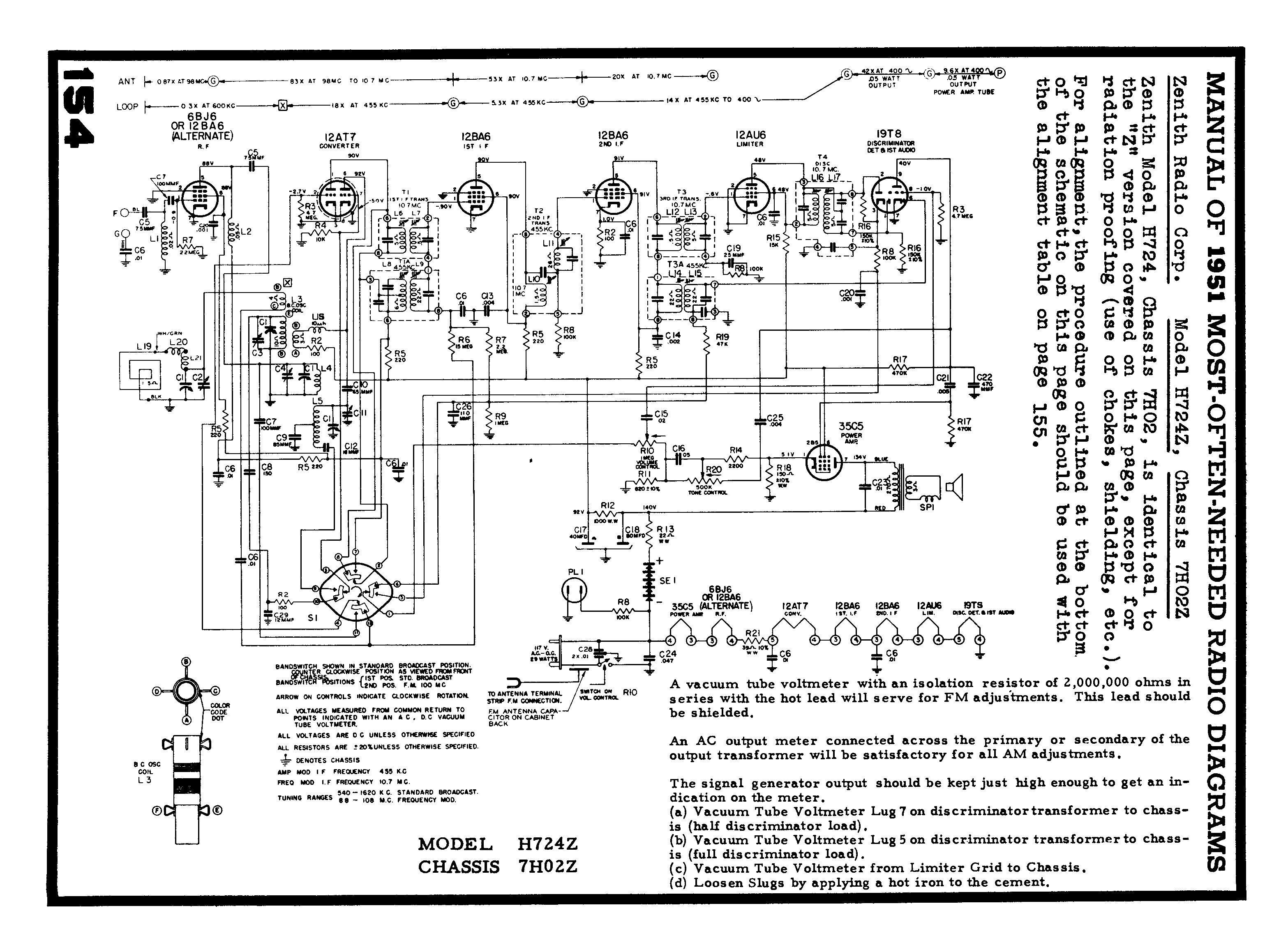

Sorry I can not answer your question, but living in the country 30 miles to FM station I notice some drift over time without AFC. Here is one I restored a few years back. Have several Z sets very much alike some with AFC some without.
Perhaps Signal strentgh is a contributor?
Generally speaking it wasn't till the mid 50's that afc was incorporated. If you are looking for good performance stay away from the late 40's/early 50's fm sets.
If one would like to compare the different circuits this has AFC. this set is one my Late father in law owned which I was able to restore.     i
Thanks for taking the trouble with the Diagrams, I have several later model AM/FM Z's and they are good players even some cheaper ones from just before they stopped making them.
