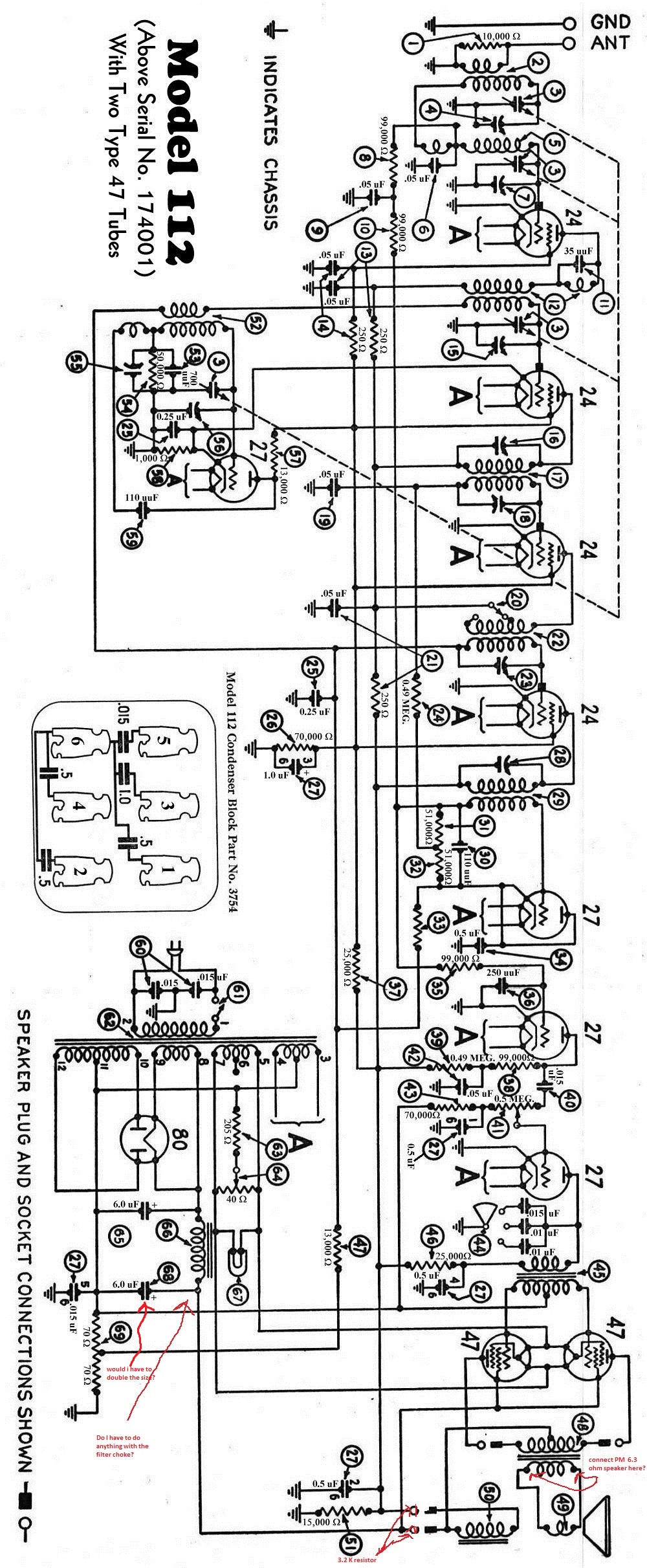

So to get this right all i need to do is connect a 3.2K 10 watt resistor to where the field coil was connected ( female connections at plug)?    Then connect my pm speaker to the output of the output transformer?
what about the field choke?  would i have to do something with that?   Would I need to double the size of electro cap #68 to 12 uf vs 6 uf to cut hum?   Please find attached drawn up schematic regarding the above.   any help would be appreciated!
You have 10 times the VC impedance. This is not good. You have to use a new output transformer.
thanks for your reply Morzh!  as per this attached chart for Philco speakers My original speaker was an H-4 , the chart shows that the output transformer has a primary dc resistance of 800 ohms,   so what output transformer would i be looking for then to properly drive my 6.3 ohm voice coil in my PM speaker?   sorry I'm new to this and appreciate your help!

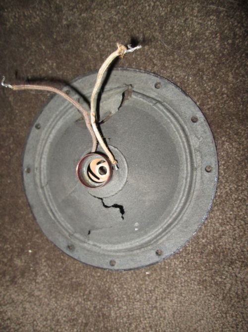

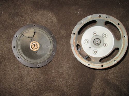

On a lot of the early Philco spkrs the cone with the voice coil can be removed pretty easily. Unsolder the vc wires at the terminal strip. Remove the screws around the perimeter of the spkr frame and the one in the center. Remove the cardboard ring and gently lift the edge of the paper cone, it isn't glued in just held in by the screws and ring.  You may find that wiggling or giving the cone a gently twist to get the vc freed up from the pole as yours is stuck (center piece). Once you get the cone out you'll want to clean out around the pole. It maybe just be dirty or it may have some rust which can be removed w/ some 400G sandpaper. Stick it down into the pole and frame gap and give it a light sand. Vacuum out the pole and reassemble.
Here's a couple of pics of a spkr from a model 80. Cone is badly torn.

Thanks for the replies folks, I'm going to tackle removing the cone as per Radioroslyn suggestion when I have time here.  But getting back to my original question and the first post with my attached drawn up schematic,  IF i had to replace the speaker, say with a PM speaker, Would I have to A) Change the output transformer to one that will be able to drive a 6 ohm PM?  B) Replace the field coil with a 3.2 K resistor? If so what wattage?
C) Increase the 2nd Electro cap from 6uf to 12 uf?  D) Do I have to do anything with the filter choke?    am I on the right track here ?

(03-24-2018, 07:49 AM)dirkbuddy Wrote:  Would I have to A) Change the output transformer to one that will be able to drive a 6 ohm PM?
Yes.
Quote:B) Replace the field coil with a 3.2 K resistor? If so what wattage?
Yes. The formula P = I squared * R will find your total wattage. In this case, we know from the speakers.zip file that the original speaker was rated at 40 mA (0.04 A) of current and has a DC resistance of 3200 ohms. So,
(0.04 * 0.04) * 3200 = 5.12
You'll want to double that for safety, so a minimum 10 watt resistor is indicated to replace the field coil. Personally, I would go with 25 watts as that resistor is going to run very hot, but that's your call.
Quote:C) Increase the 2nd Electro cap from 6uf to 12 uf?
10 uF is probably enough, but you can go with 12 if you wish - and if you can find one. It's easy to find 8 and 10 uF capacitors, but not so easy to find 12 uF.
For both input and output electrolytics, I would replace with film for longevity.
Quote:D) Do I have to do anything with the filter choke?    am I on the right track here ?
No, you leave the filter choke alone and leave it in the circuit.
If the primary is ok (not open) it will work ok. Is it a perfect match no but the audible difference is negligible. Typically the Philco spkr is lower abt 2 ohms.
Yes it does has to have either a choke or a resistor there. Wattage would be determine be the current flow thru it. Doing some quick calculations the current flow thru the field coil and #57 (they are in parallel w/the hv) it comes to 5.4 watts. You'll want to double that so the resistor doesn't get flaming hot.
I would leave it unless hum is an issue. The field coil isn't doing much if any filtering.
No.
E) am I on the right track here ?
Depends some of us like to keep things original as possible so repairing the spkr would been top on my list rather than replacing it w/a pm job.
GL
ps started to post and made breakfast but didn't look to see if anyone answered your Q's before finishing the post.
As Ron suggested, I'd go with 20-25W resistor. Field coil is huge and gets warm, but resistor is smaller. Also a 25W resistor is not as big as one might think.
