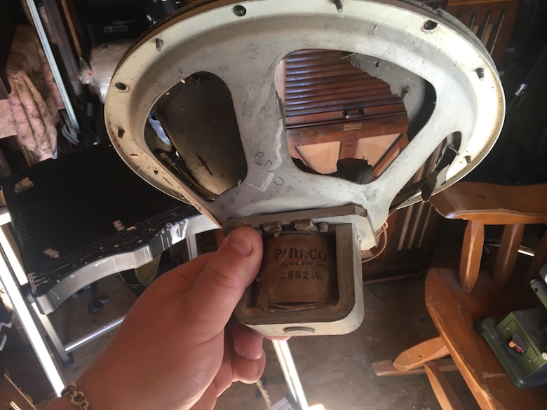

I have a 650 chassis with the speaker but the speaker is not a K-17.
I know Lee pulled it out the the 650 tabletop so what is going on?
It is a 10" speaker.
Was mine a replacement?
Pic below.
If that came out of a tombstone, then someone rigged that H series speaker to (sort of) fit.
The 650B tombstone originally came with an 8 inch K series speaker.

The 650B tombstone left the factory with a K-17 speaker.
650 console models left the factory with an H-13 speaker.
If a 650B tombstone had an H-13, not only would it not fit, someone would have had to rig some way to make it work. Plus those speaker screws (spaced for the K-17 speaker) would be poking the cone of the H-13 unless a thick backing board were cut and installed by someone. It was not done at the factory.

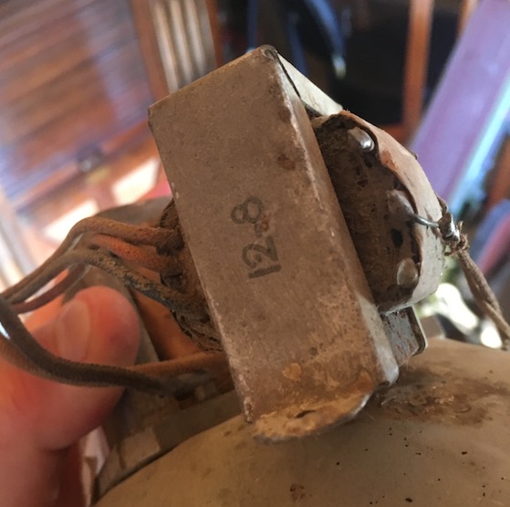

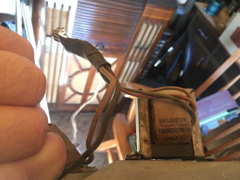

 Im not disagreeing. I was just looking at the number on the speaker I have. It matches the one in that post I linked.
This one has a little addition to the side where it was adapted I guess. Ugh... I cant use this now, lol...
Oh, sorry, do you mean the number on the side of the actual field coil? That isn't surprising to me, both speakers having an 1140 ohm field coil and the same size "pot", it makes sense that Philco would have used the same field coil and "pot" for both K-17 and H-13 speakers. Icon_smile
