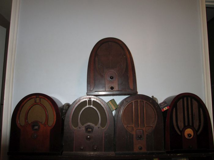

I just need two more to finish up the second row!!!
