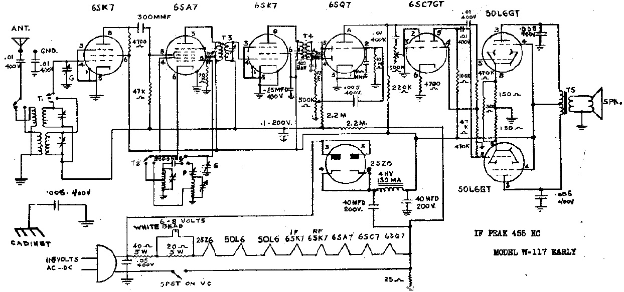

the nostalgia air diagram includes two prints,, my model is the top print "model w117 early" from what i can gather now that i have compared all the caps and a few resistors.
i have no 6sk7's avail,,, i have 6sc7's though but i dont think they will work.
attached is the schematic i am using.
does anyone think my antenna capacitor is wrong?  and could it be causing this?  i highly doubt it myself but just asking.

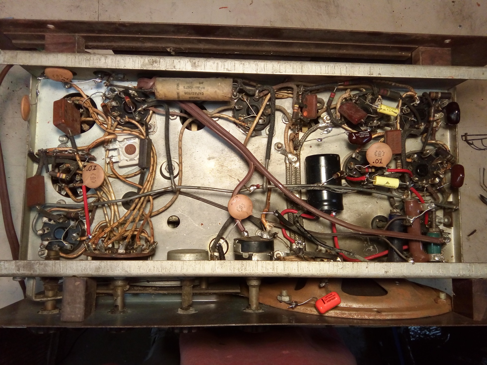

    here is the bottom of the set.
from my research the bare metal bar is what i "think" supposed to be the DC Buss.
right now i have no voltage on this bar.
i have also read that in nearly all cases the 50L6 tubes are wired in parallel,, so when there is a problem with one ,, all current passes through the other one and killing it by default.   This is only what i recall from early this morning reading up.
there is a mod to rewire the 50L6's in series so that when one goes,, the other simply does not operate but it does not get killed.
i am trying to apply all the things ive learned here and from terry,, so tell me if i am tracking this correctly.
(06-07-2018, 08:47 PM)jcassity Wrote:  here is the bottom of the set.
You could rewire the parallel 50L6 to use 25L6 in series, all the tubes would then be 300ma. That's what every set I can remember used. Musta got a helluva deal on 50L6.
A 6SK7 doesn't draw enough current to get more than barely warm.
I suspect the buss is floating ground, B+ usually requires enough resistors to drop for various points that it's just a few wires. You need to check plate & screen voltage on each of the tubes., BUT start by verifying cathode voltage on 25Z6. Ground will begin at negative side of filter caps...

I am posting up a diagram of this "early" Minerva tropic master for our records if thats ok.

on the diagram below,, the tube line downstream of the power plug show the grid power if i am correct.
what pin numbers can i "assume"  are shown.
the print assumes the user is qualified and trained so leaving off the pin numbers  ,,, i dont mind but i want to document them on the print by hand myself.
I am still looking for a very clear version of the diagram but this one will have to work for me.

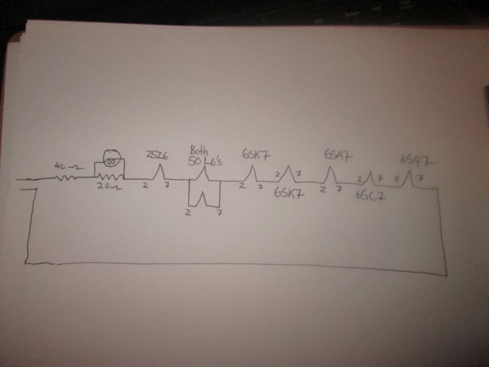

As drawn your schematic is wrong. It will only work if it has 25L6's in it NOT 50L6's Or as Tom sez parallel the two 50L6 heaters like this:

As Terry stated schematic is wrong, radio must be correct or the 150ma 50L6(s) would have excessive heater voltage and other tubes with 300ma heaters just barely lighting. The late version shows 50A5 wired correctly.

In my picture there is a bare tinned copper bar running across the bottom of the chassis.
from what i have read and what i can tell, this bar is supposed to have my DC power, seems kinda hazardous to me but oh well.
