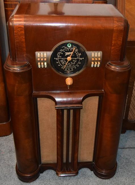

Posts: 676
Threads: 149
City: Elko,MN.
Posts: 3,231
Threads: 59
Joined: Apr 2011
City: Lexington, KY
The Zenith looks great Murf
