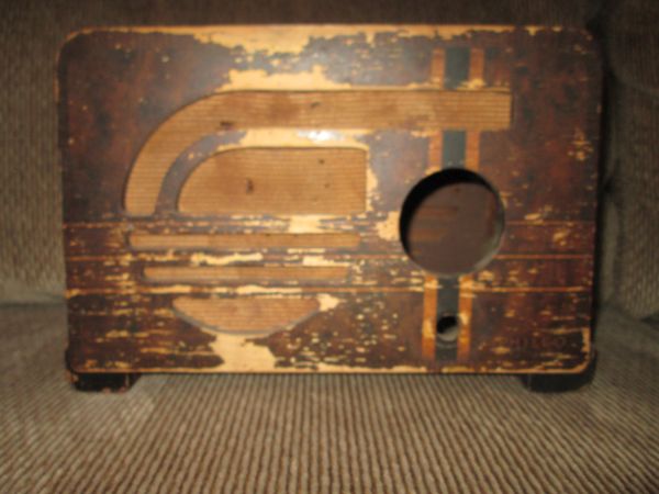

I picked up rough 37-602 cheap a yr or two ago. Most of the Philcote finish was gone. Didn't really want to buy one of those decal photofinish replacements. So a member saw a cabinet on ebay and I got it. Price was good but it has some challenges. Missing abt 10% of the photofinish and a crack in the top. Repaired the crack and re glued the frt.
Sanded the sides as I was a little apprehensive abt using a chemical stripper. Cleaned the frt and back w/mineral spirits and then gave the whole thing a few coats of sanding sealer.  Sanded the p/f lightly w/400g paper. Original it had some crazing and want to level that out. Mixed up some water based acrylic paint to do the touchup work on the p/f. Using a very small brush I went after the little dings. A few more coats of sanding sealer and sanding to level it some more. Once I get the back side touched up it will be ready for toner and clear coat. The toning is for the top only not the photofinish.

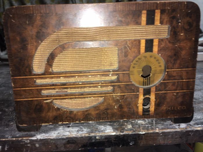

I did leather repair for 27yrs (for work) match color and textures so doing the wood touch up is kinda fun. This is the original cabinet the chassis came in.

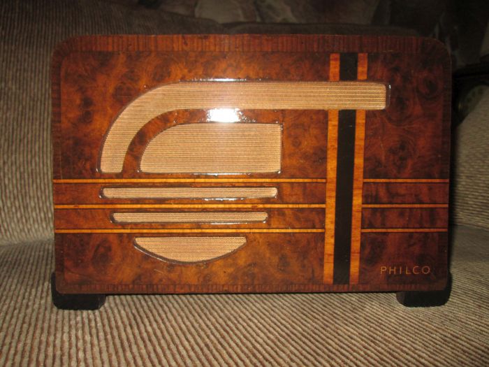

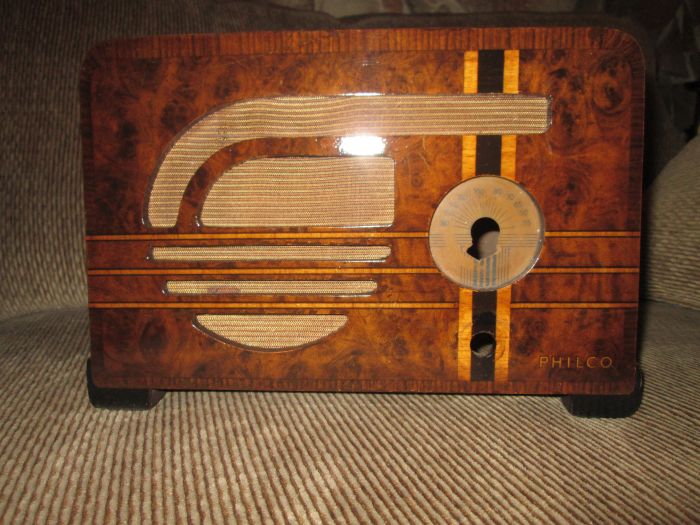

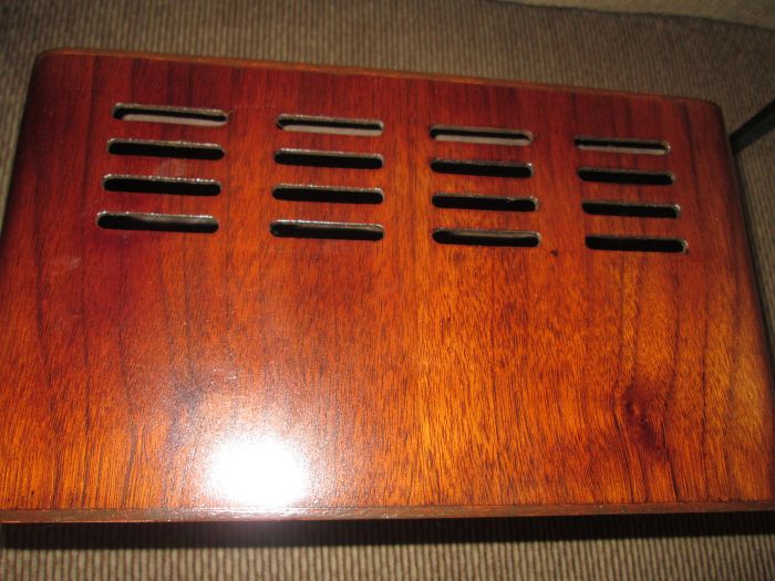

Here's a few pics of the cabinet, I think I'm done except for final buffing in a month from now. Onward to the chassis. It's working but unserviced.

It's not all that difficult but it takes a lot of patience, sanding sealer, very small artist brush, 600g paper, and a little water base acrylic paint.
Basically the object is to just color the small damage areas w/the small brush w/the least amount of paint. To prep I clean the pf with some mineral spirits then spray several coats of sanding sealer. Sand lightly w/600g paper to level any slight alagatoring in the pf. Then touch up color w/sm brush. Scratches or straight lines can be difficult to hide. Sometimes using a couple of colors throughout the length of the line or just color parts of it.
Adding the acrylic paint over the sanding sealer base will leave a slight raised area so a few more coats of sanding sealer and light sanding are in order. I use a rubber sanding block to get a flat surface. Edges wear quickly so have to keep an eye not to sand thru. Repeat as necessary.
This '602 has abt 6 coats of sanding sealer and 4 coat of gloss sanding between the coats. The damaged areas arn't flat and smooth, the lacquer doesn't have a lot of filling power. Some of the damage on this one was pretty deep and on an angle you can see the ding, straight on it looks good.

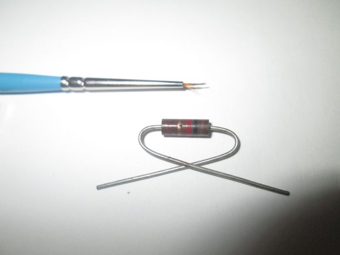

Looks like a 00000 sable spotter. Have used them for fine artwork for years. The restoration looks beautiful.
It's marked 18/0. Not quite sure what it means. Just want to get the smallest one I could.
