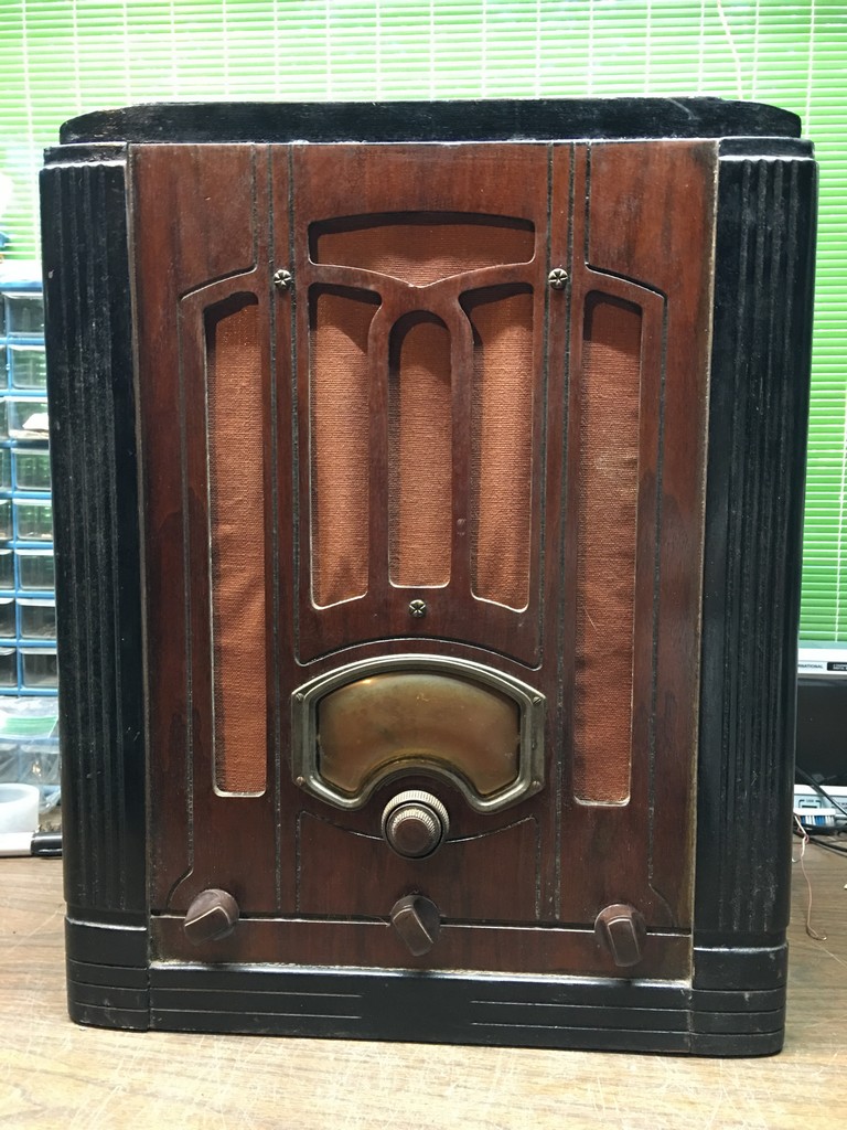

As many of you know, I had purchased this RCA Victor T7-5 tombstone at Kutztown in May.
[Image: http://www.philcoradio.com/images/phorum...-5_001.jpg]

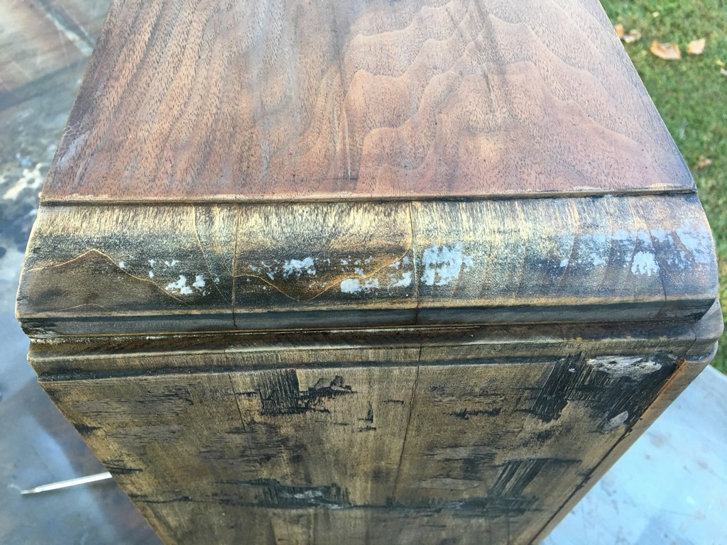

I made fair progress on this RCA T7-5. It was painted in the dark areas. (How did I end up with all of these painted cabinets?)  Anyway, the front and the right side are mostly stripped now. The paint on the left and right sides on the top is very stubborn. I have yet to strip the left side.
August 21.

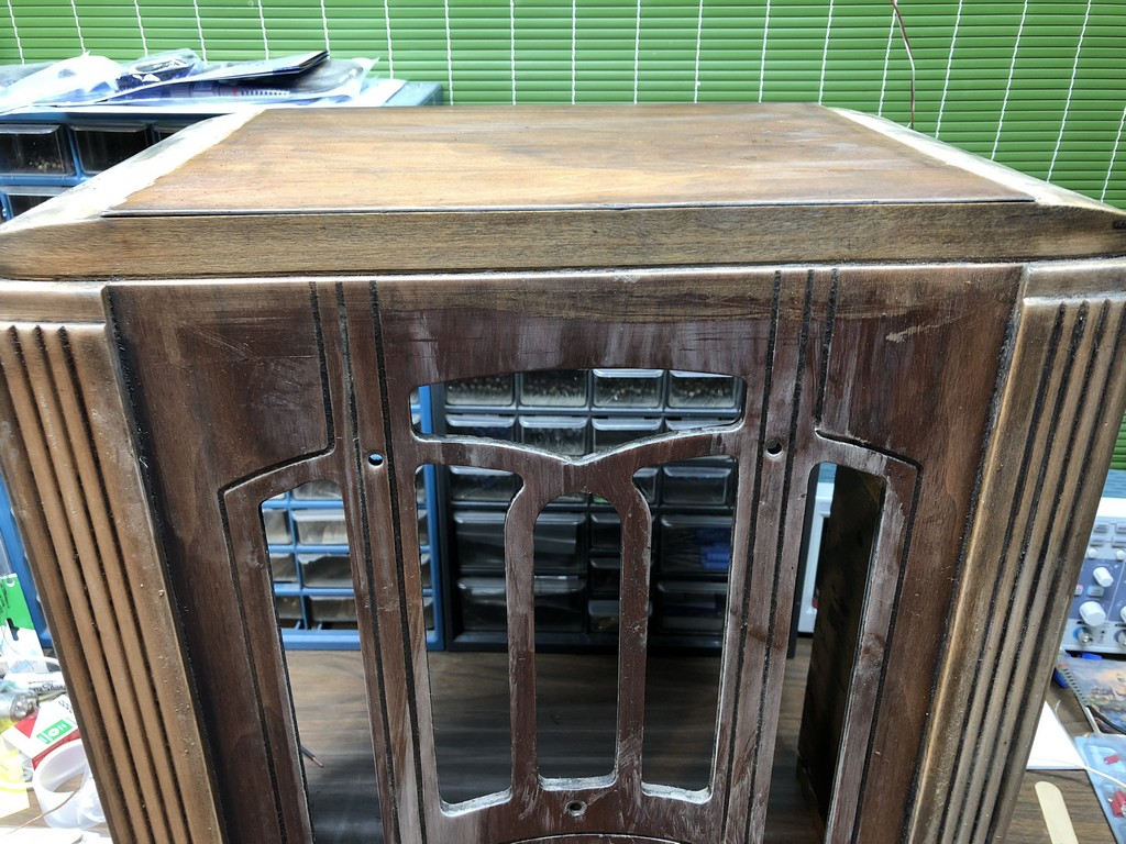

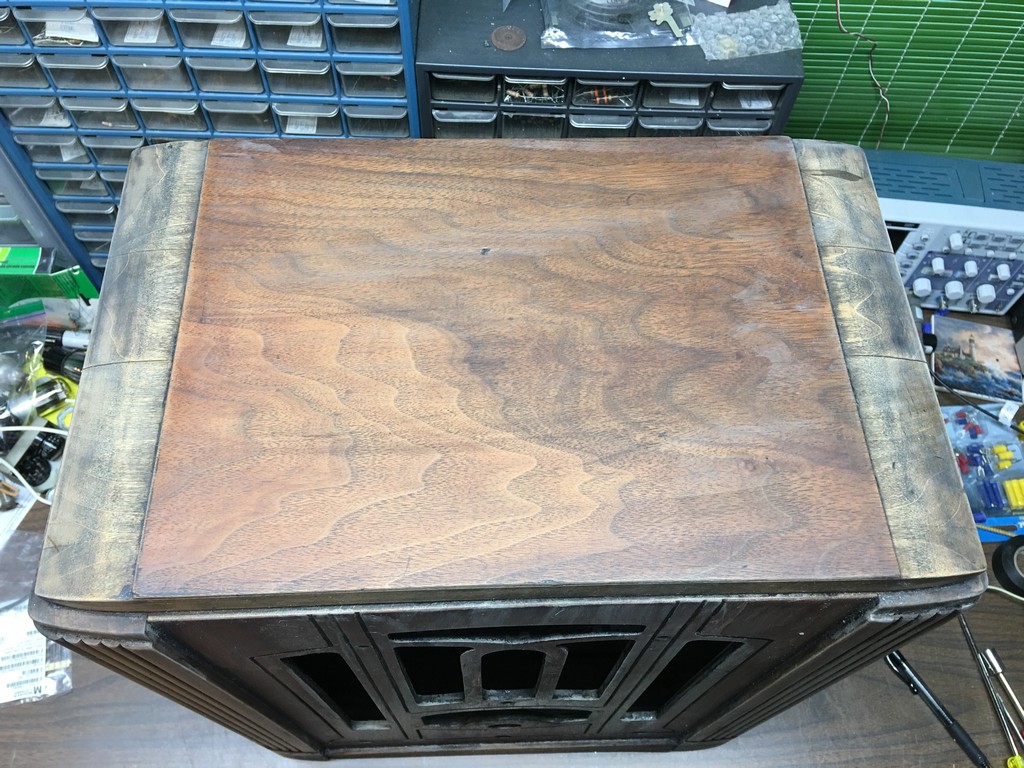

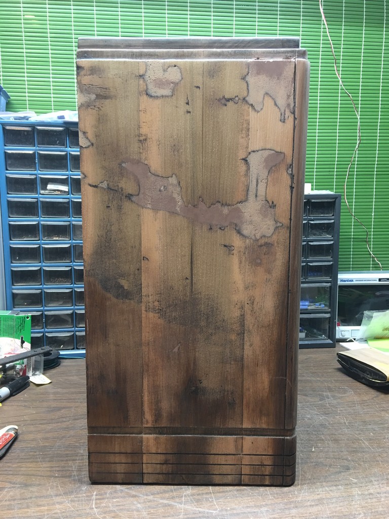

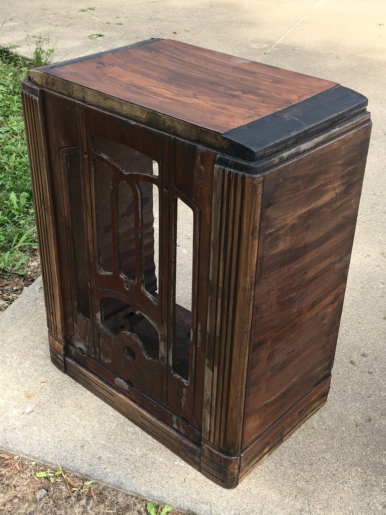

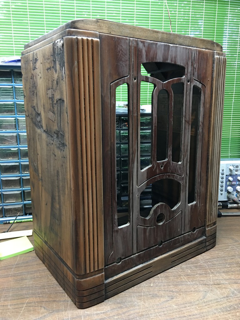

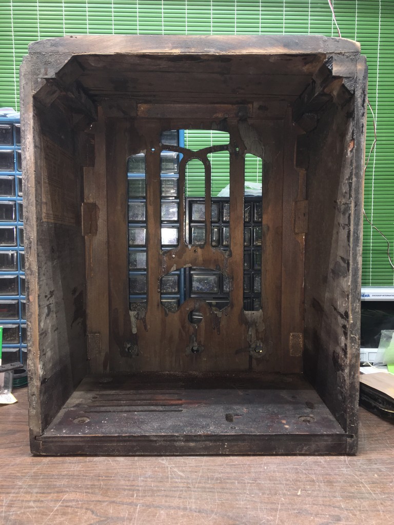

Having experienced difficulty finding the proper gloves to use with an acetone/lacquer thinner mixture, I finally acquired a pair of butyl rubber gloves and was able to more or less finish stripping the T7-5.
[Image: http://www.philcoradio.com/images/phorum...18_006.jpg]
[Image: http://www.philcoradio.com/images/phorum...18_007.jpg]

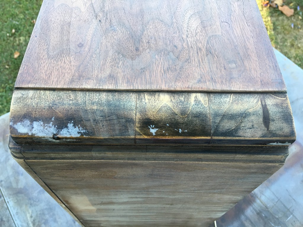

I'm wondering if I may need some wood bleach for its shoulders. The old black paint really stained the shoulders.
I'll need to do some extensive repairs to this cabinet. Summer is quickly slipping away. I'm wondering if I'll get this one done this season, or if it will have to wait until 2019 to be refinished.

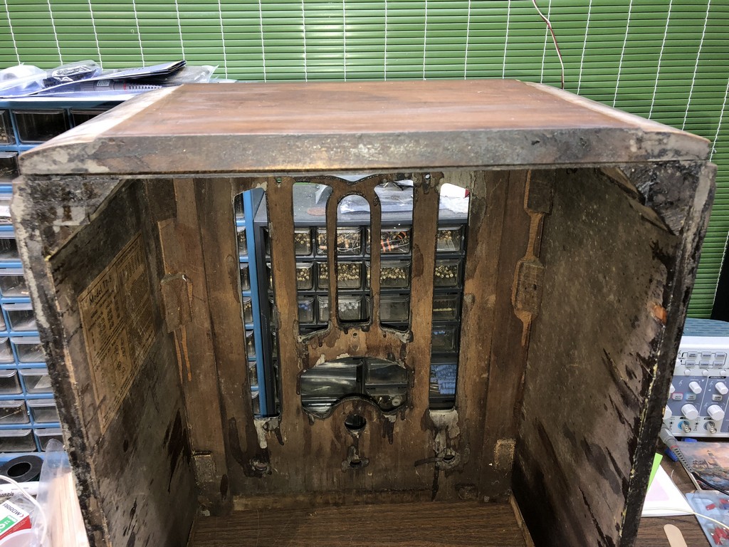

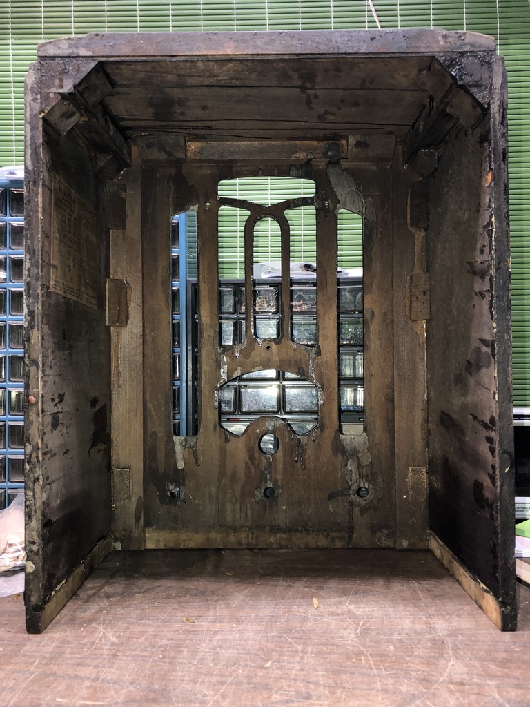

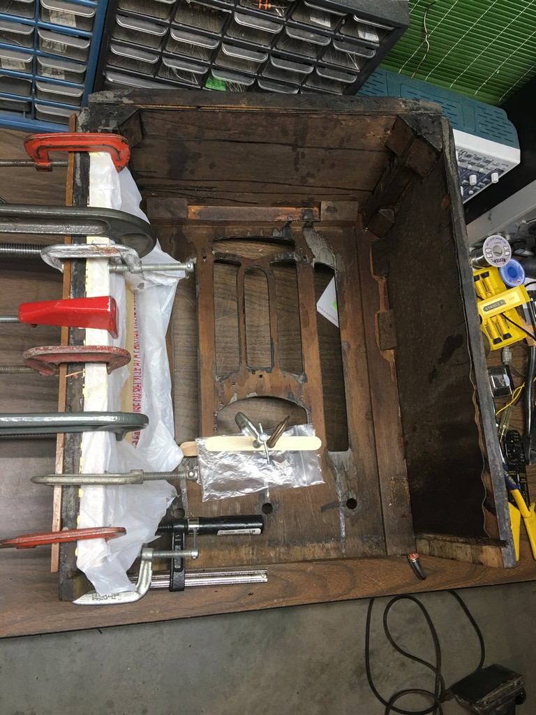

The base of the T7-5 cabinet was very loose. Since the inner sides needed to be glued down, I decided to remove the base to make gluing the inner side veneer easier.
[Image: http://www.philcoradio.com/images/phorum...-5_081.jpg]
A little bit of the inner veneer between the dial opening and tuning shaft hole was also loose, and a small piece had come off. I have glued all that back together as well.
Tomorrow, I hope to glue the other side of the inner side veneer. You can see how loose and curled up it is - the side which is currently clamped down was worse. Once both sides have been glued and dried, the base will be reinstalled.
This cabinet is really in bad shape and is going to be quite the challenge. It is going to need veneer on one entire side, and a couple strips of veneer on the bottom of the other side.
I just removed all of the clamps and the side that was clamped is looking pretty good now. If I run my fingers across it, I can still feel a little waviness, but it isn't visible. In any event, it is much better than it was.
Tomorrow after work, I will glue and clamp the other side.

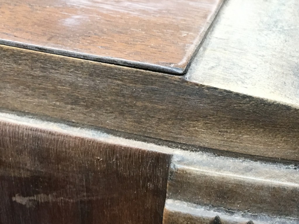

and the top veneer in front which is also peeling away a little bit:
[Image: http://www.philcoradio.com/images/phorum...-5_084.jpg]

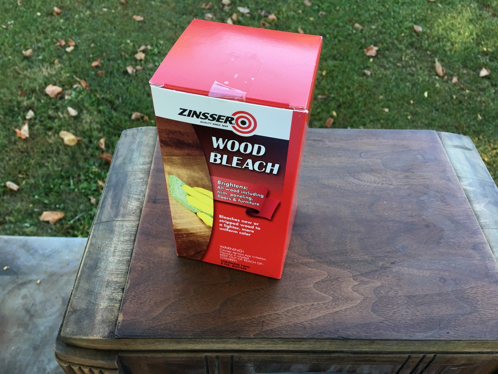

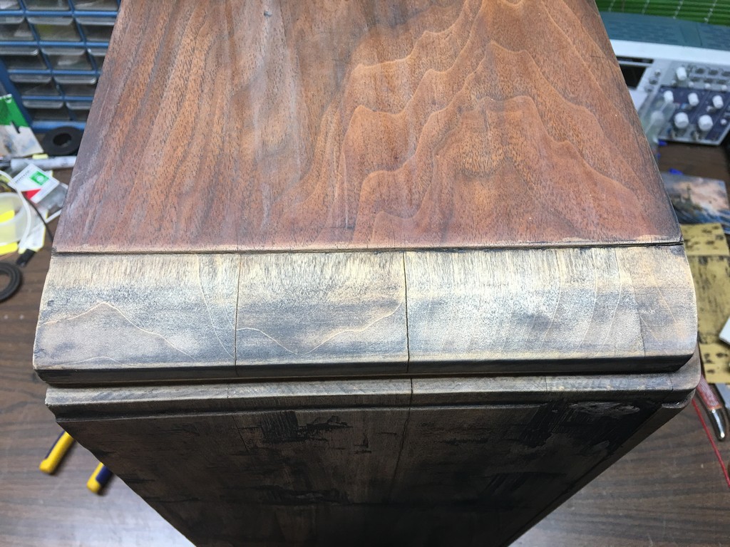

I tried some paint stripper on the top "shoulders" of the cabinet. Most of the stripper merely soaked into the wood. It still does not look good. Wood bleach is now on order.
Wood bleach arrived yesterday. I applied it to the shoulders of the T7-5 cabinet this afternoon.
[Image: http://www.philcoradio.com/images/phorum...-5_085.jpg]
After application to both shoulders of the cabinet:
[Image: http://www.philcoradio.com/images/phorum...-5_086.jpg]
[Image: http://www.philcoradio.com/images/phorum...-5_087.jpg]
The directions say to let it soak in overnight and then sand off the residue the next day. So tomorrow, I shall see if the wood bleach did any good. This is the first time I have ever used wood bleach, so it will be interesting to see if it really works, or not.
I only had time to look at the cabinet today but nothing else, as I was busy with the other two cabinets I'm currently working on. Plus, I had to mow the yard this evening.
But anyway...the wood bleach did lighten the white wood somewhat. Unfortunately it also lightened a tiny strip of the top veneer on each side. I'm not worried about that though, as toner should take care of that.
Photos later, probably tomorrow. I'm considering letting it go as is now, since this area will be covered in very dark toning lacquer anyway.

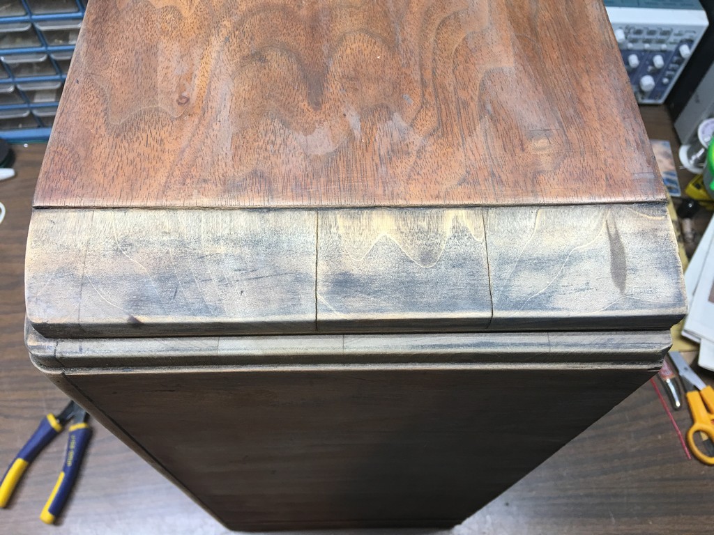

So here is how the T7-5 "shoulders" look now:
[Image: http://www.philcoradio.com/images/phorum...-5_088.jpg]
[Image: http://www.philcoradio.com/images/phorum...-5_089.jpg]
Comparing these photos to the photos in post #6 above, you can see a difference.
But perhaps I did not need to bleach the shoulders after all. Looking at the an original finish T7-5 picture shown here at Wikimedia Commons as well as another T7-5 on Russ' website (scroll about 2/3 down the page to see before and after shots of a T7-5), it is obvious that there was no real need for me to use wood bleach on the shoulders since these areas are supposed to be heavily toned with Extra Dark Walnut anyway. Oh well, it was good practice and I have the stuff should I need it again in the near future.

First, a look at the back of the cabinet showing the end result of all that gluing and clamping:
[Image: http://www.philcoradio.com/images/phorum...-5_092.jpg]

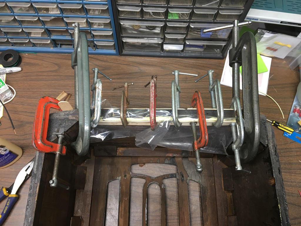

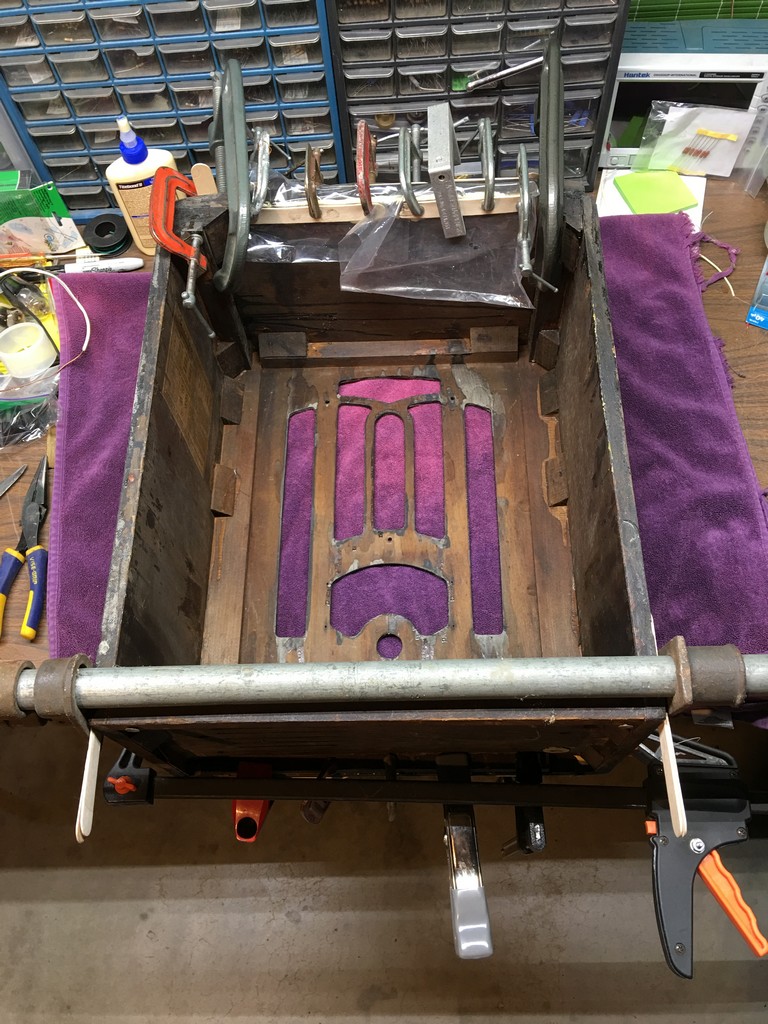

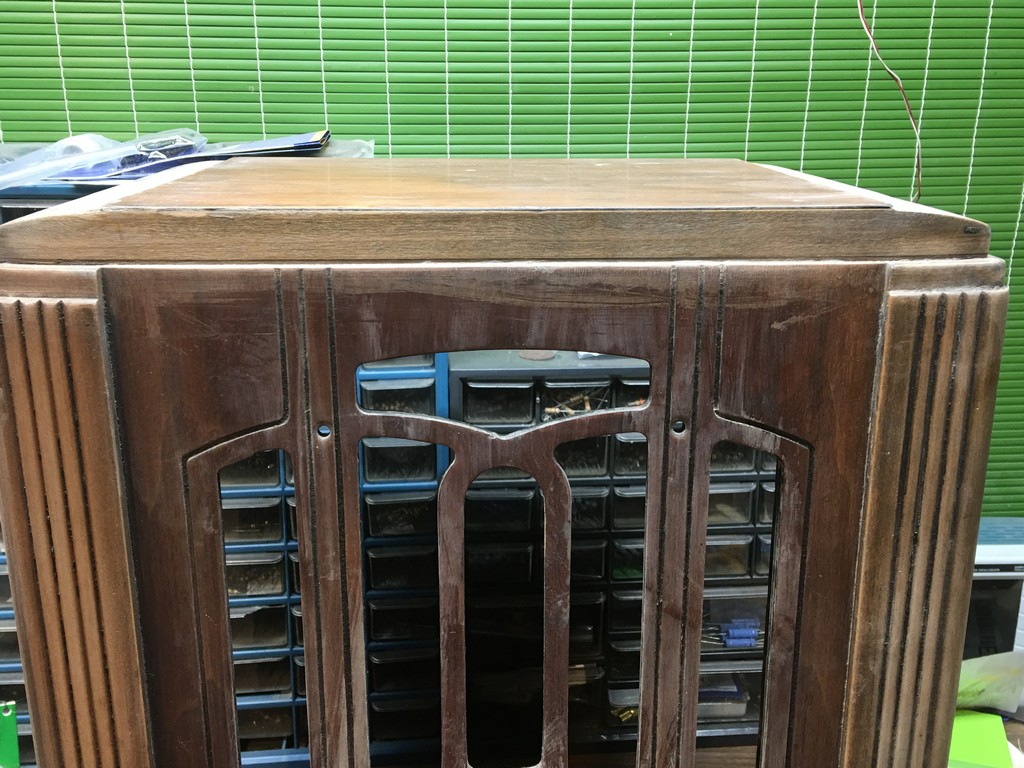

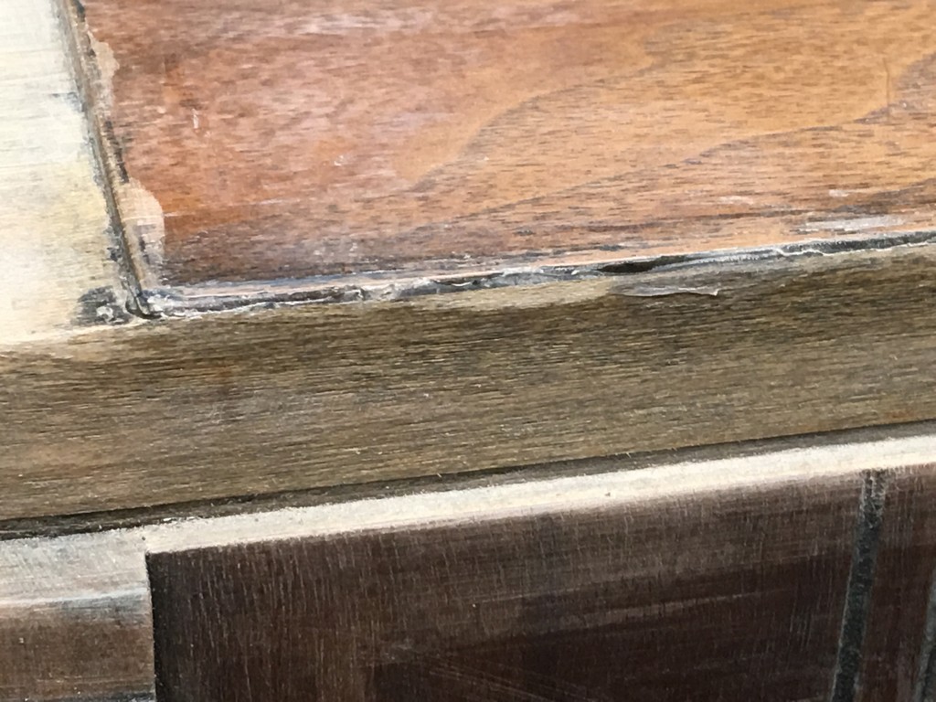

And I figured out how to glue down part of the front edge of the top veneer:
[Image: http://www.philcoradio.com/images/phorum...-5_094.jpg]
[Image: http://www.philcoradio.com/images/phorum...-5_095.jpg]
I still need to remove the remaining glue residue.
This leaves the right front corner of the top veneer which still needs to be glued down:
[Image: http://www.philcoradio.com/images/phorum...-5_096.jpg]
I will use the same technique I used to glue down the left corner: a bar clamp with one jaw against the top right grille opening (well padded with folded up paper to help protect the grille opening) and the other jaw against the top veneer, as close to the corner as possible.
