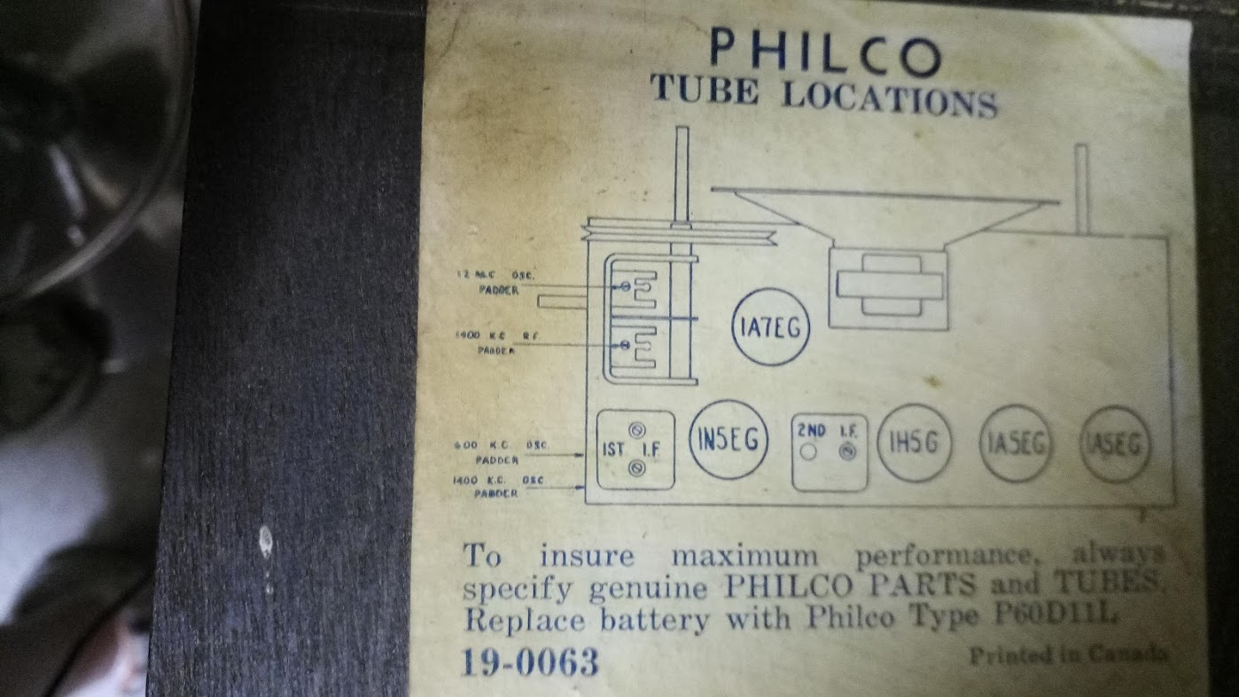

The layout is exactly like the Canadian 48T, but that one uses different tubes and is mains powered. My radio is missing the model tag Icon_sad  it has "model 211" written in pencil on the chassis.  RUN #2.
Updated with the Cabinet Sticker.
