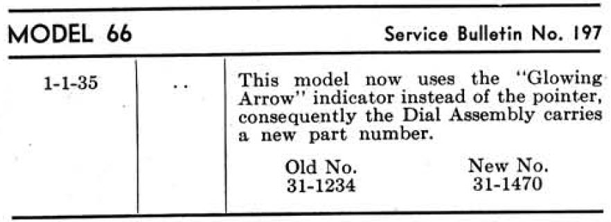

I found a possible answer in the August 1, 1935 Philco Changes in Models Bulletin:
This could indicate the introduction of a larger dial scale and escutcheon as well, which would mean the 66 received it before the 60 and 38 did. Just guesswork here, since I did not find any concrete evidence one way or the other.

Edit: Upon further reading, the same bulletin states that Model 60 received a dial scale with larger figures starting on 1-1-35. It seems reasonable that this could imply that the new scales were larger, necessitating a larger escutcheon for models 60 and 38 and possibly 39 and 66. Again, just guesswork.
