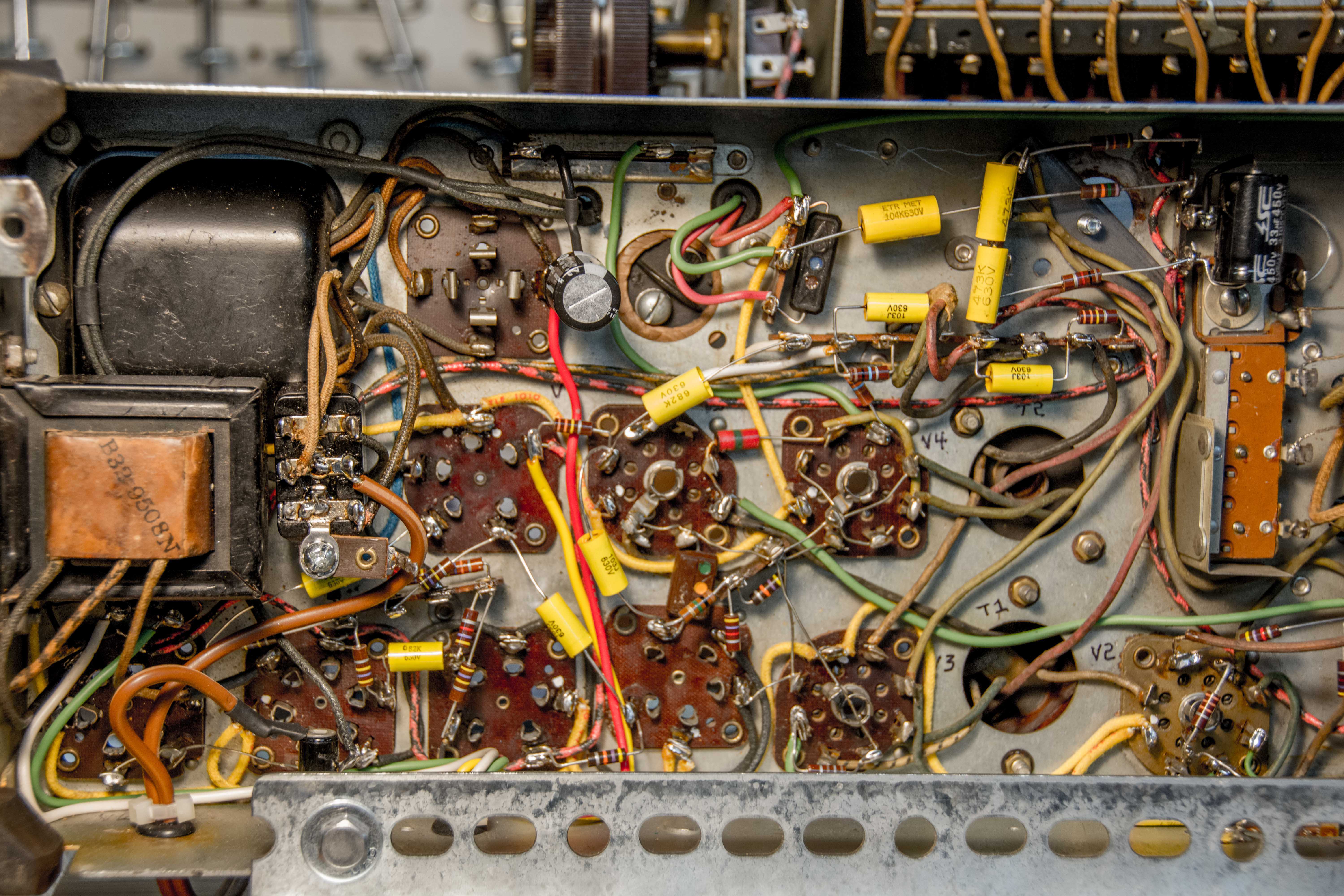

also,,, never seen a skinny domino cap like the one top center of your underside of the chassis!
