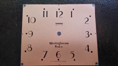

I used that method to recreate the clock face on my Westinghouse Columnaire.
