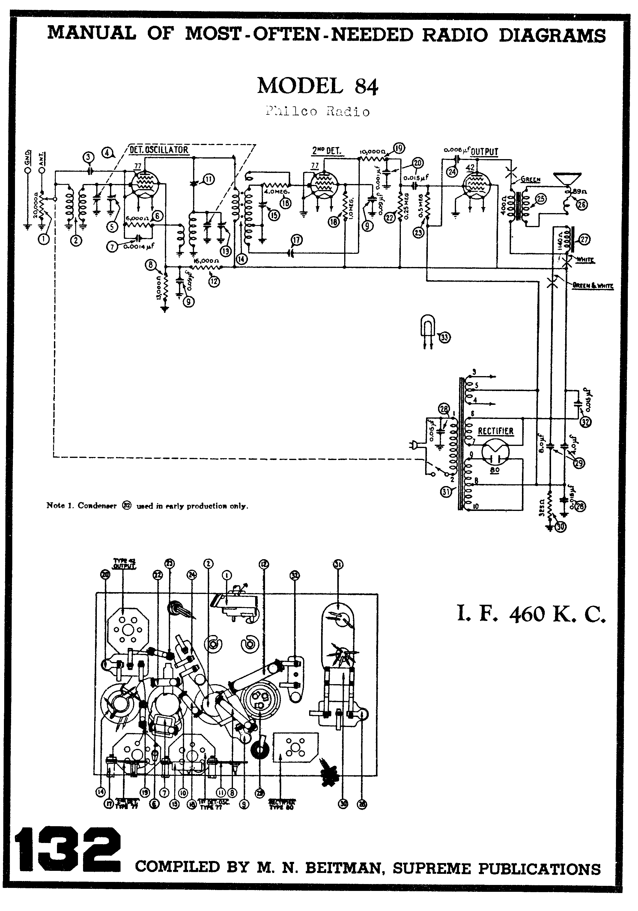

Well....Checked all solder joints, cleaned all tube sockets, by-passed almost all wires with a jumper, one at a time. I found one loose wire, resoldered it, but the only change was prodding the entire chassis now has no effect at all. Thought I'd post the schematic. Maybe there is an error in it somewhere.
[Image: https://i1367.photobucket.com/albums/r79...nbvfhn.jpg]

Maybe this will help Beitmans has the parts layout under the hood.
