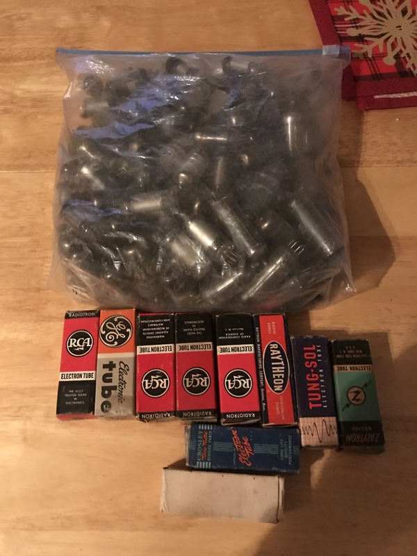

hey mike
if you need tubes  I have a few  you can have
ill never use them all
Sure Sam, thanks. When we see each other Icon_smile
