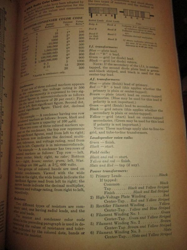

Here's a basic list of the Radio Manufactures Association (RMA) wiring color code for electronics. This is fairly standard among most manufactures. When used it makes troubleshooting easier and easier to follow the wiring. I know that the US built Philco's didn't follow these colors very closely in the 30's. No red, blue, and brown speaker wires they use white, green, and green/white.
