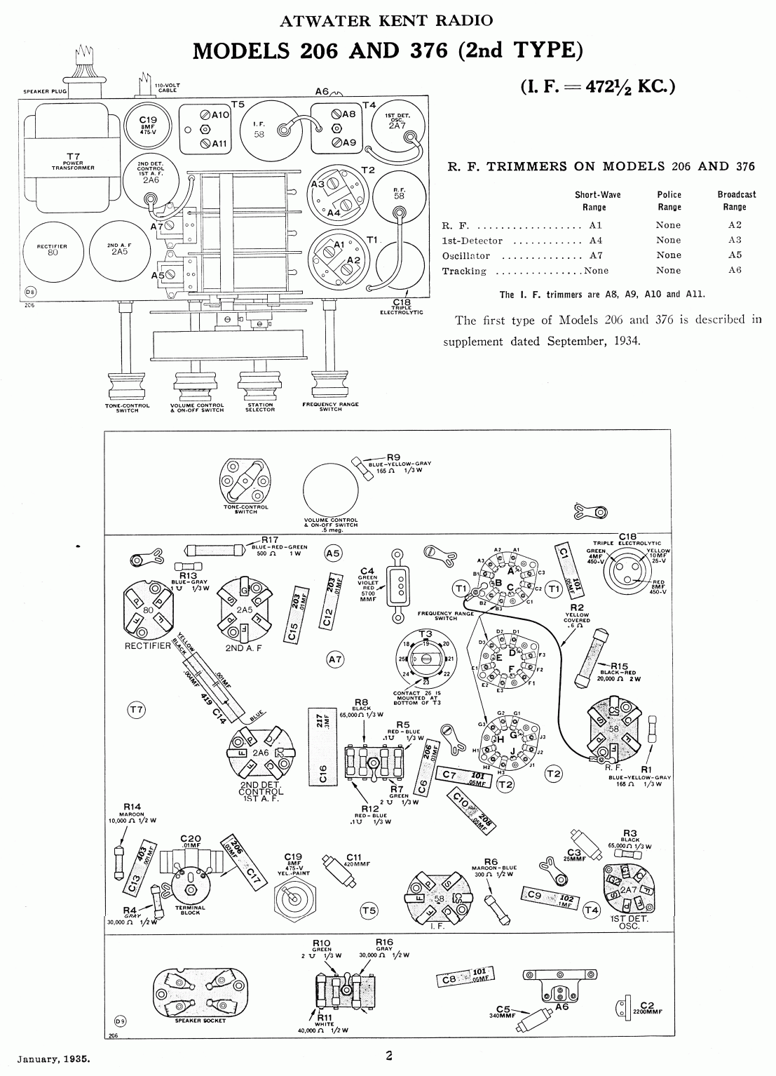

As for your issues, got all the tube shields on?? Did you have to replace a bunch of rubber wire?? Could be a wire placement problem. Check to see if C-6 C9 and 10 are wired correctly.
You didn't mention any about the resistors it's worth checking to see if they are within tolerance. Note they use an odd color code so use the diagram for proper values.

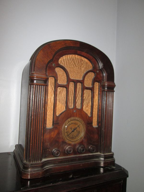

For those following at home this is what the set in question looks like.

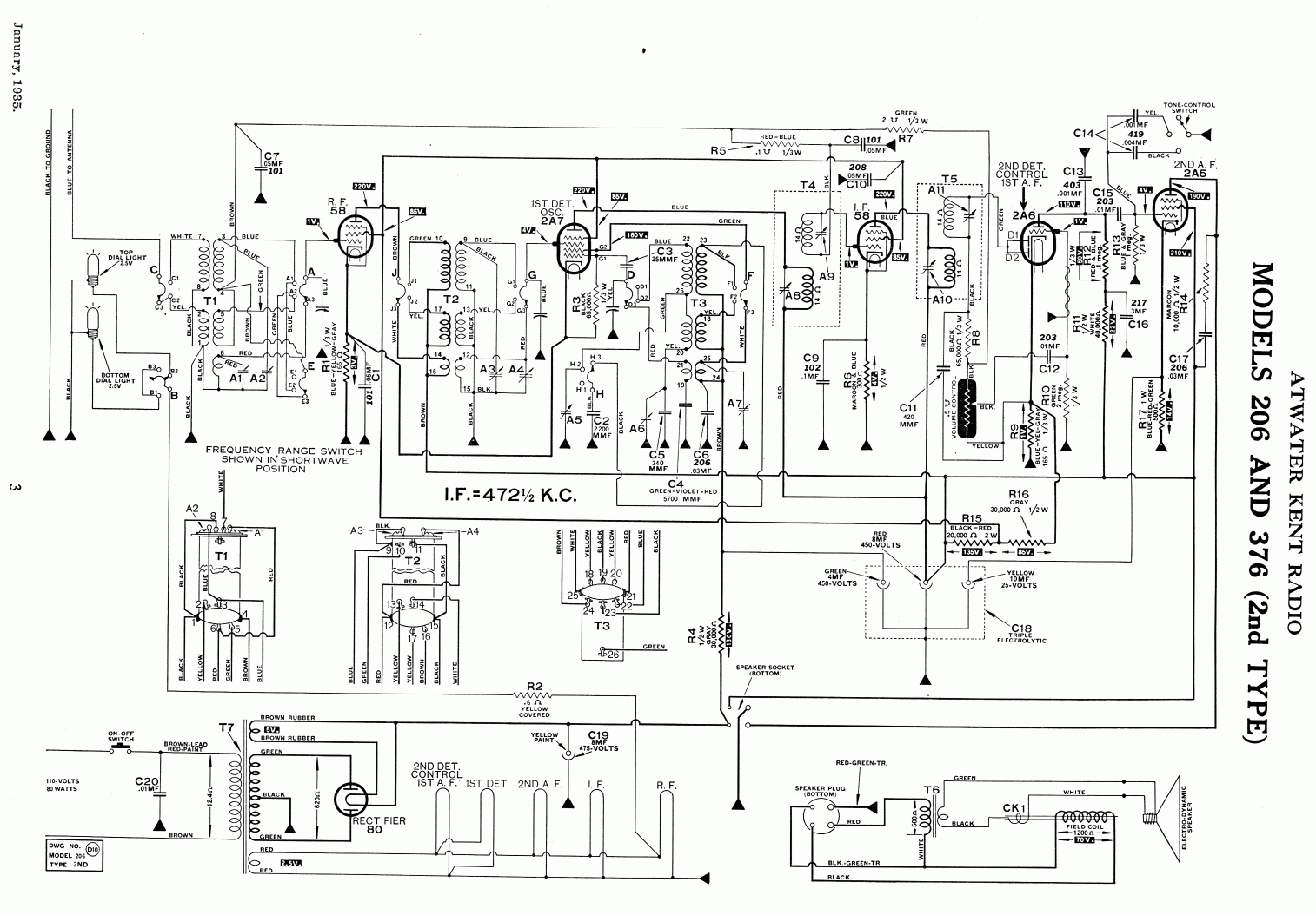

Alas, this one was missing its original speaker. Gary at PTOTP had an 8 1/4" RCA speaker with a 1200 ohm field and an output transformer attached that I've been using. He had an original AK 4 prong speaker plug too, which helped. The only thing this speaker doesn't have is the hum bucking coil that was attached to the original AK speaker. It's CK1 on the schematic. It that critical and if so, what could be used in place of it?
I double checked C6, C9, and C10 and they appear to be correct. The .03 mfd cap goes to #24 on T3, which is at the 7 o'clock position:
Not so much w/o it you may hear a little bit of 60cy hum but that's about it.

Ok try this tune in a station up near the top of the bcb 1400-1500kc then adjust A2 and A3 and see if that helps.
Have a look at the voltages on the rf amp and mixer. Mostly the screen grid and plate.

Ah, the omega symbol meaning megohms! I'd never seen that either. With that knowledge I replaced a few more resistors tonight that were way off. Namely R10, R16, R8 and R12. Didn't make a whole lot of difference, though, in the noisy distant reception.
There is still something going on around that 58 IF tube. When I first turn on the set, after flipping it back rightside up, it will come on motorboating. As soon as I push down on the gridcap of that tube, the motorboating stops. I'm wondering if something could be going on inside that IF can. There's not much in it judging by the schematic.
It seems to receive a few more stations since the resistor changes, more below 1000 on the dial, but that's where most of the stations are in the area. Adjusting A2 and A3 while I have the strong local station noisily playing at 1470 didn't make any difference. I even tried my SStran AM transmitter, which should blast at low volume and it too sounds distant and noisy. It broadcasts at 1450. I didn't have time tonight to check the voltages but will tomorrow. Any other ideas? There are a couple of original micas I left in place. I'm wondering if the mica-mold style C4 would make a difference?

You said that you aligned the IF stage did the trimmers A-8 thru 11 have a definite peak @ 472 1/2kc ? Have a listen for the local oscillator @ 472 1/2kc above the dial setting. If you have a spare 2A7 (bit of an odd tube) I'd give it a try too.
