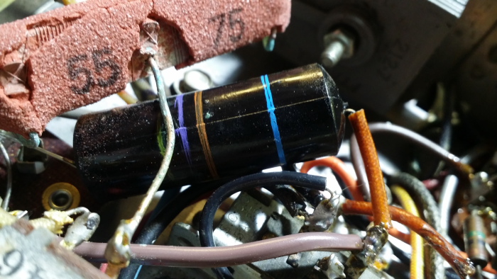

  I have seen two ways of restuffing a plastic molded paper cap, bumblebee, black beauty, Little Chief, including yours, the other way was to cut one end off and bore out the innards, and then replace the cut end. I found out something interesting about the Sangamo "Little Chief" caps though, for years I thought that they were molded out of polyethylene or some similar plastic, but whilst cutting one open I found out that they are molded in something resembling either Bakelite or melamine as the produce a fine dust when you cut them. I crushed the shell of the same cap whist trying to clamp it in a vise and the pieces were all rough and jagged, just like a phenolic plastic. I think I may try the line boring method should I restuff them, since I do have a small lathe.
I cut one. It is clearly not a polyethylene. It does behave like some backelite.
They are easy to crush once you begin to make a cavity.
The plastic smells like Bakelite which makes me wonder. The foils and insulators are not inserted in the tube like I am doing but it appears that the tube was molded around them. If it is Bakelite they must have had to heat up the whole assembly. Maybe this accounts for the poor performance. Either the insulator is damaged in construction or it is a material that can stand up to heat - but not years of service. When I drill it out it is just flakes.

Well, sort of. Using that method, of the 3 I described, I cut the wire off of the end without a ferrule(which is the foil/ground side). Then grind a small area flat so that the drill won't wander and drill through the end - through the foil and paper - until I hit the above mentioned ferrule. Heat the solder blob on the remaining end and the wire will fall out. Tap the body or blow out the solder to leave the hole in the ferrule clean.
Insert the new cap in the cleaned-out hole so that one lead passes through the ferrule (end). Seal the open end with epoxy or Bondo and paint black.
BTW, here is a picture of a CAST replacement (not made as above but cast in the red mold). This is the "death-cap" replacement and is rated for Y2 or X2.
Yeah, my sanded resistor needs new sand, but, is otherwise OK.

Do you add a note anywhere noting the caps have been rebuilt?
I would probably cut that cap out you show, thinking it was old and had to go.
I put a business card into the battery area stating that it has been recapped.
On larger (expensive) projects, I will sometimes tape a card to the chassis - sometimes.
