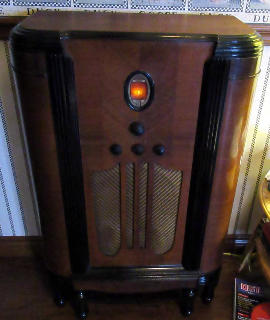

Thanks to all who responded to my question about refinishing the top of my Philco 3650. An application of Wise Owl Furniture Salve brought back the original colour and I have completed the cabinet. Picture attached.

Thanks Craig-problem has been solved by an application of Wise Owl Furniture Salve which brought back the original finish just fine. I have posted a picture to the group.
