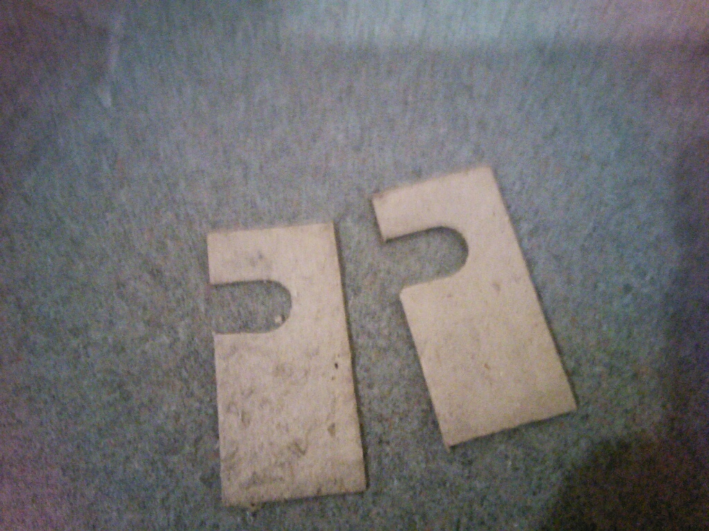

Here's something that I also found in the previous radio:
Those were disintegrated so I tossed them, however these seem good, so I wonder what those are and where they go.

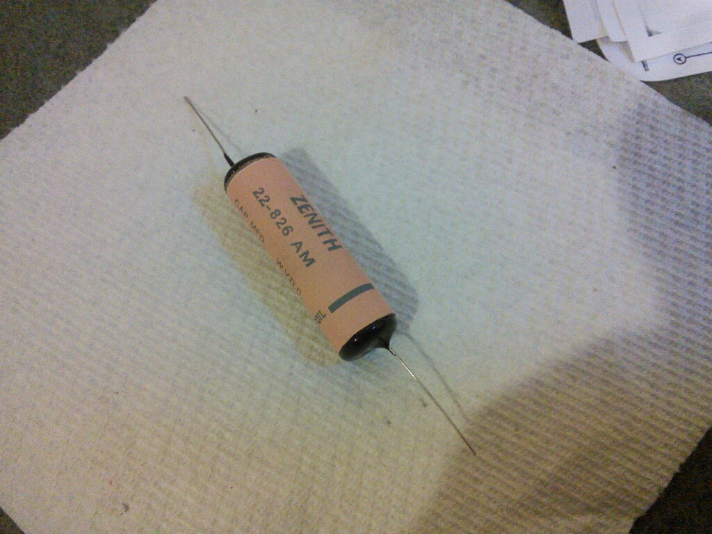

Hmm, somehow, this seems familiar from my recent Zenith project. It had obviously been kept all together since new, including odd bits and pieces, user manual, promotional literature for the FM system etc. It came with cardboard pieces like this, marked "Remove before use" or similar wording. I wonder if yours are similar transport packing/protection pieces?
I suspect those are spacers between the chassis and the cabinet. On ARF there was the same opinion.
Plus they seem to have appeared after the chassis was out.

Good point - if they only showed up on disassembly - perhaps something to make assembly easier & quicker at the factory?
Could be.

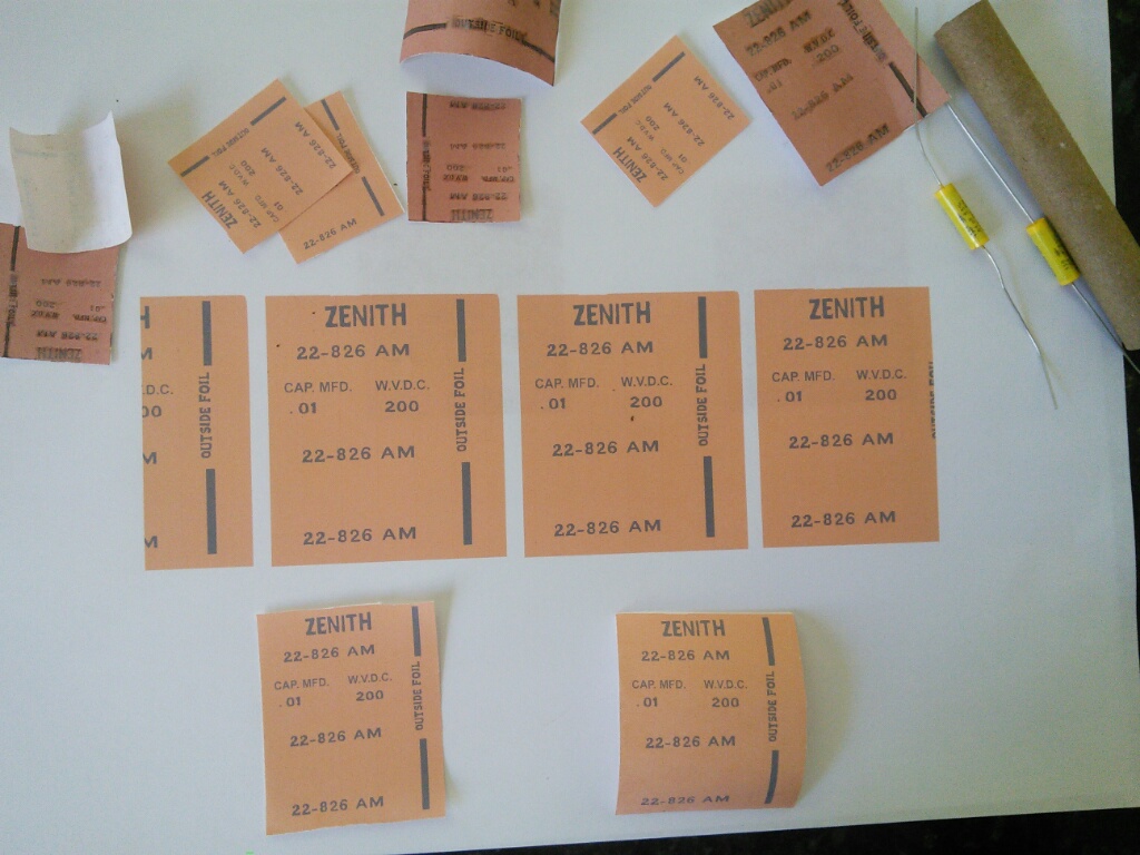

So I scanned what was left, photoshopped it and created my own caps.

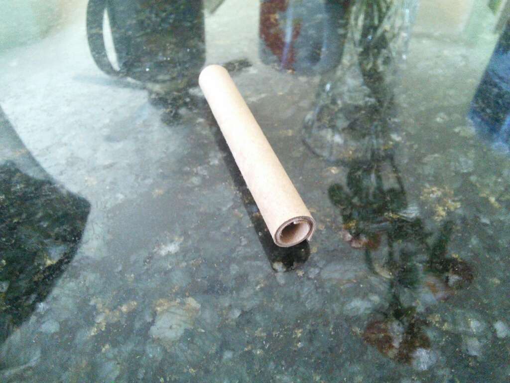

I needed a paper sleeve, and having none available created my own from a backing of a notepad.
One mistake I made was making the walls to thick but it wasn't too bad.
Here it is:
The sleeve. Made by spraying glue and rolling around an exacto knife handle.
The labels. I made several sizes as well as photoshopped more or less.
Then in the same way spray the glue and roll on the labels.

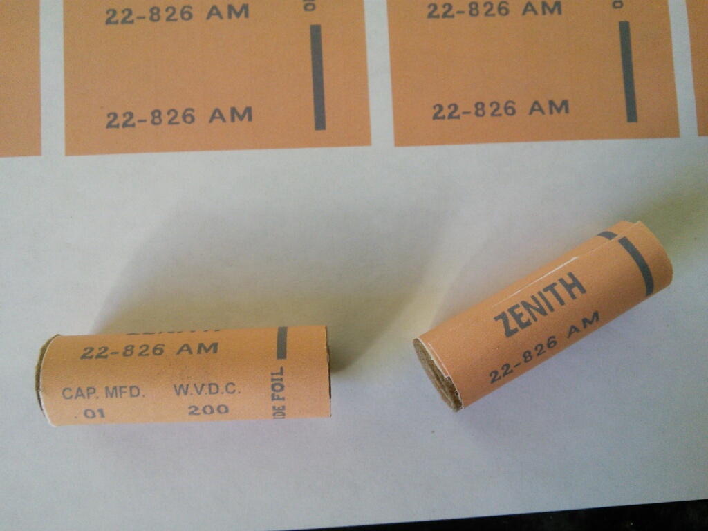

And finally, put the cap insde and pot with hotglue.
As I sad, the walls were too thick so the glue had to pour over. It's ok but next time I will know to only use 2 layers.

They look pretty good Mike.
(This post was last modified: 03-23-2019, 06:17 PM by Eliot Ness.)
They do indeed look nice. Bigger than original but still....this is my first time building it from scratch.

For the first time not bad indeed. Next time (if there will be next time as this is the last 7G605 I have) it will be better.
Btw I just thought of an easier way to reproduce Bumblebee caps, as restuffing them is onerous.
Same thing: cardboard tube, photoshop wrapping, layer of whatever lacquer that doesn't dissolve the print (I used fabric glue this time) and potting with black glue (if exists).

The originals were kind of glossy. A quick spray with some semi-gloss lacquer might achieve this as well as protect the paper.
