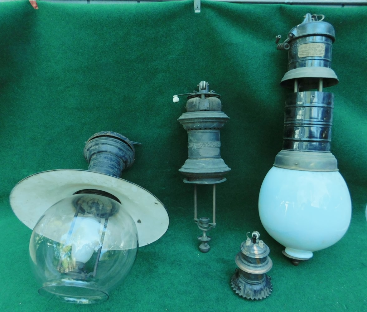

I collect carbon arc lamps and I have run into something id like to share. I dont know much about old radios and im not sure if ive posted in the right on the forum but some may want to see this. About two months ago I purchased four arc lamps and in this collection is a very rare Helios lamp. As many here may know, Helios Electric Company was the very beginning of Philco. I have never seen nor heard of a Helios arc lamp in existence until one popped up online in a small collection.
The lamp is an open-arc (meaning no inner globe; only the large outside globe) series AC lamp. This lamp was used in 'series' with other lamps on the circuit being regulated by a constant current transformer running at usually 110-220-volts between 25-110 cycles. It dates to about 1890 and is it beautiful condition with almost every part intact. A few of the interior parts such as the asbestos-covered wires, now-uninsulated coils, and nickel-electroplated pieces will need to be refurbished accordingly. I am missing a vital part and maybe more; the lower carbon holder! How this lamp operated, which is electromagnetically interesting, is by maintaining the distance between both the lower and upper carbon rods rather then only the upper. This extended the life of the lamp up to twice that of moving only the upper rod. The opalescent globe on this original and in perfect shape!

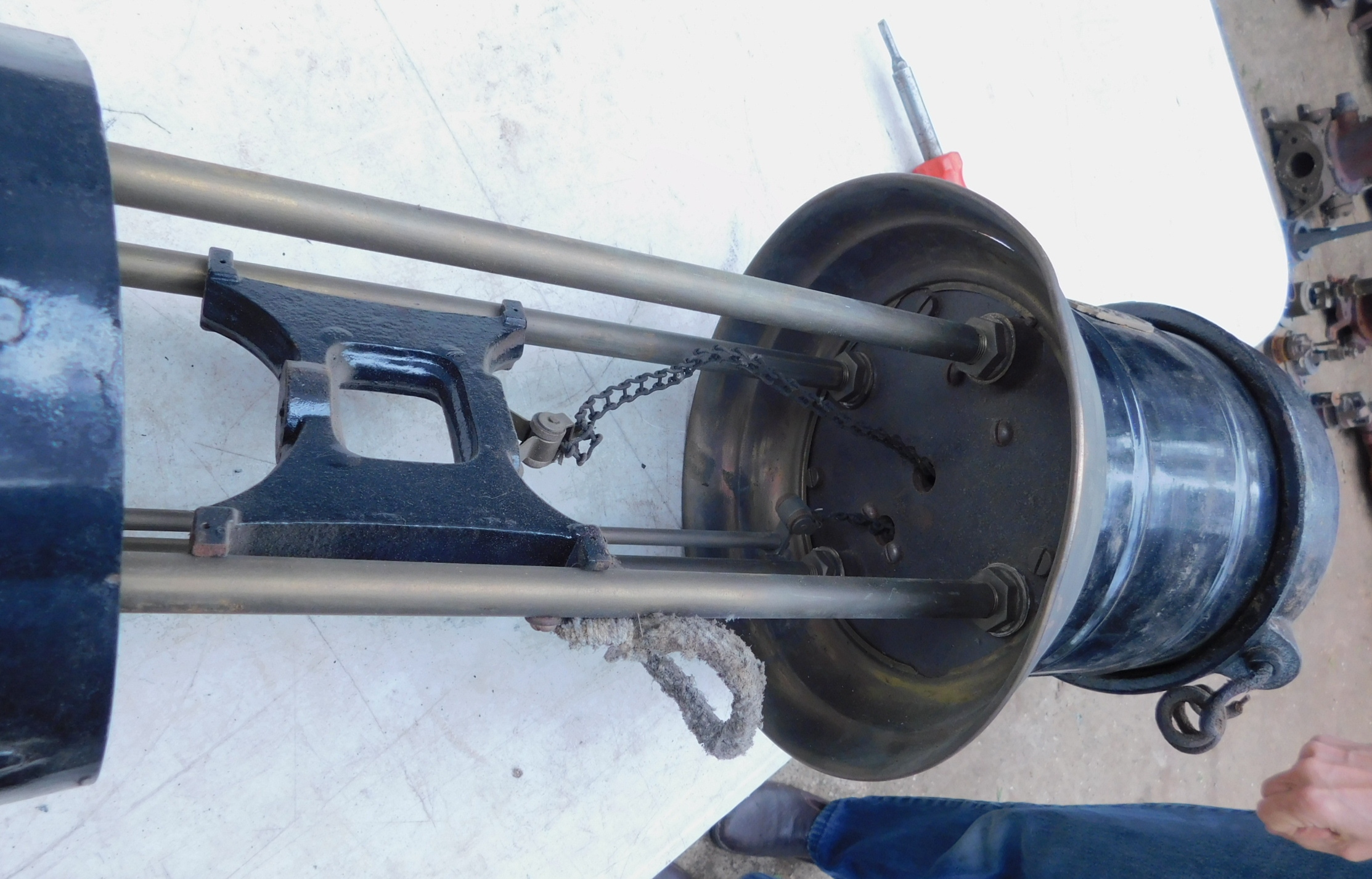

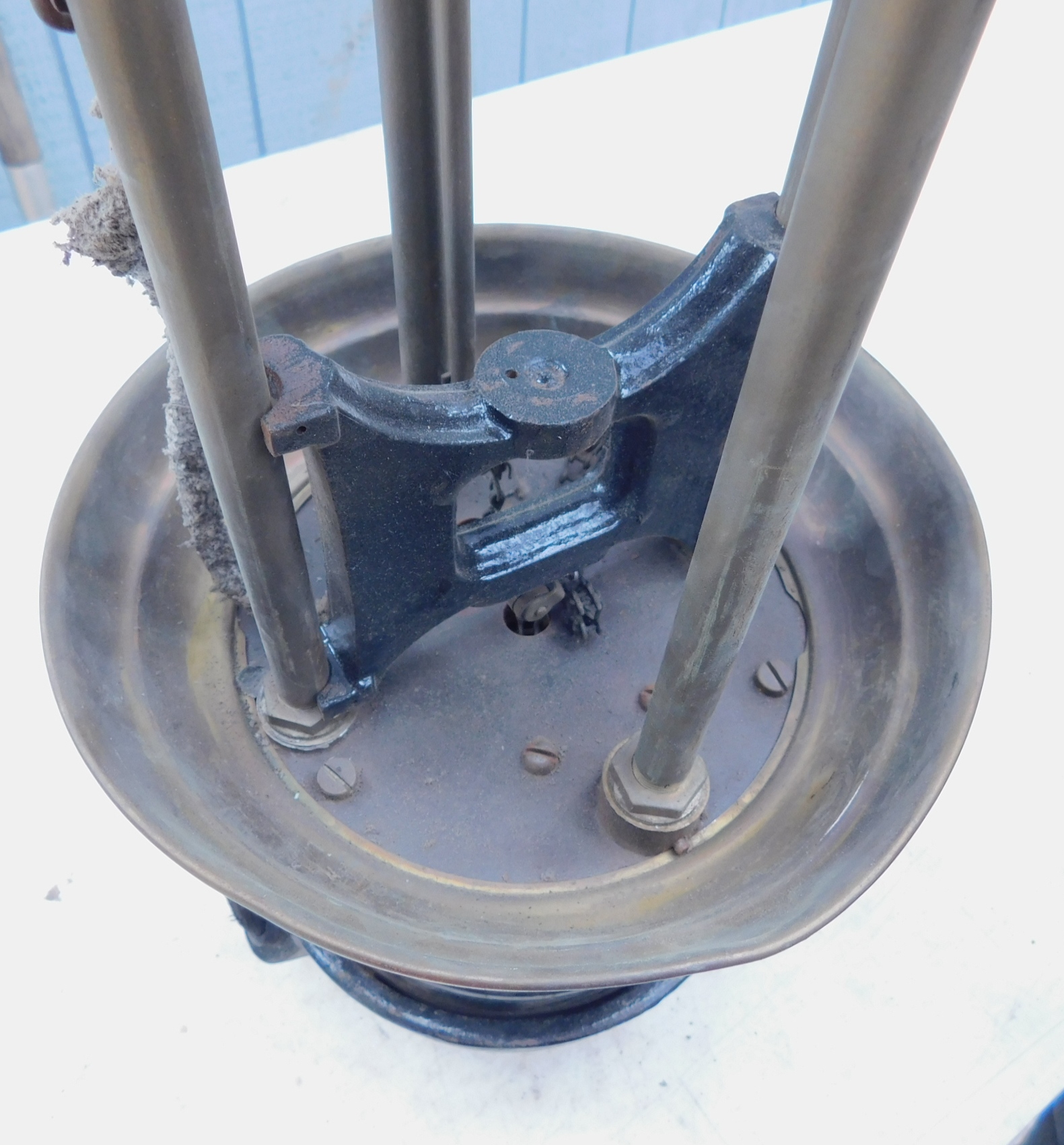

The ultimate goal is to get this baby operational through proper restoration and preservation of whats here. I can reach this goal but am looking for any old Helios Electric Company catalogs or part drawings to fabricate the broken or missing components. I know its a long shot that any paper material is surviving apart from a few general Helios lamp catalogs online but I thought id give this forum a go. Just a side note as well: If anyone knows someone who can do custom glassblowing and make a lamp globe such to spec as the ones shown please do give me their contact. I have business for them.

First image is of the four lamp group. The Helios unit is the largest piece on the far right.
Second and third images are of the carbon holder.
