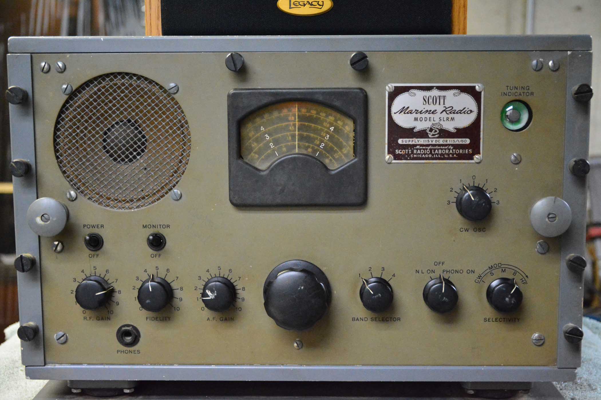

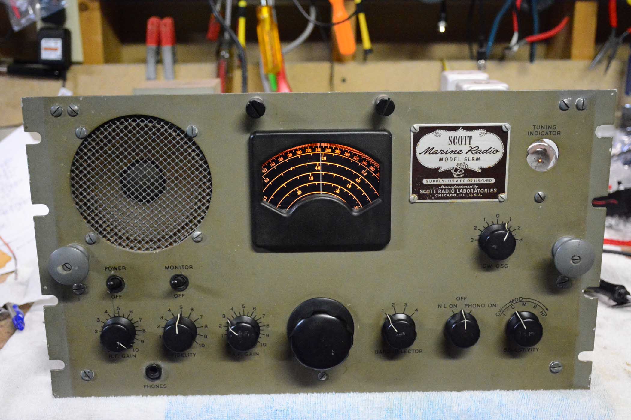

Bought this from Ron. Thanks Ron. Studied the parts list and discovered that all the coupling caps are mica and the bypass caps are bathtub type - oil soaked. Disconnected and checked a couple and they checked fine, same with the mica's. Decided to power it up slowly, monitoring the B+. B+ was fine and ripple was very low. The radio came to life without hum! Checked all voltages (the Scott manual is very complete) and all are reasonable but some are off a bit. Some resistors have drifted high, but not too far out of spec. The biggest problem I have is the brightness of the pilot lamp. This is an AC-DC set so no PT. The pilot is in the return line to the negative supply and it appears to be the correct lamp. Without the pilot light, the radio is dead. I may play with some form of LED to supplement the pilot lamp. I'll probably re-stuff the electrolytic cans just to be safe and take my chances on the rest, at least until problems develop. Sensitivity and selectivity (variable) is excellent. I found a couple of CW transmissions and tested the BFO - it works. With an external speaker, it really sounds pretty good. The output is designed to feed multiple speakers (like a 70 volt system) or a low impedance balanced line to drive amplified speakers throughout a ship. It uses 25L6's for the output.
The construction of this thing is amazing. No expense was spared. Every component is identified by number on the chassis for easy service by barely qualified techs in the WWII Navy, and for people like me. Great quality is as simple as tax money can make it!
I feel much safer using this radio as my enemies won't be able to zero in on my local oscillator transmission when I'm listening to the radio. After all, that's part of the reason this radio was designed.
Thank you Ron. Love it!

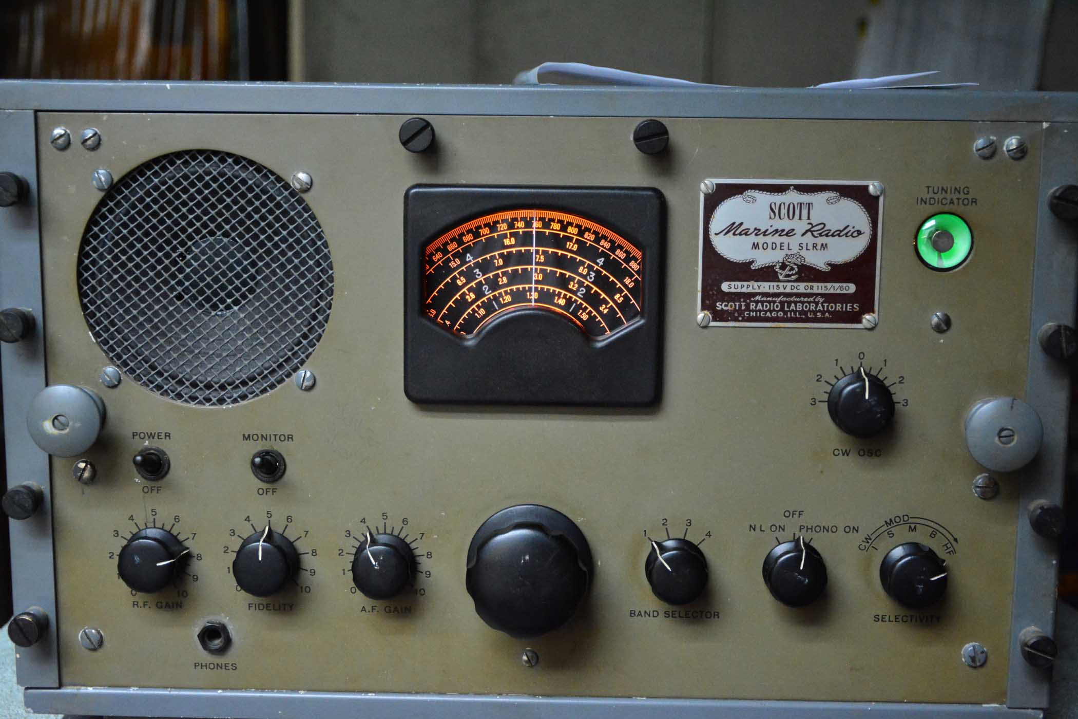

I replaced the yellowed and shrunken dial glass with a new piece of clear plastic. I need to figure out how to engrave the band numbers in the plastic to make it like the original. The original was cracked, loose, and very yellowed since it had shrunk and broke out of the pins that held it in place. LED's powered from the negative supply now back lights the dial making it easier for me to read. Compare it to the previous picture. My "magic eye" tube, a military 1629, died so I had to use a 12 volt tube with the rest of the pins cut off to provide continuity in the series filament line to get the other tubes to light. I have a NOS on order. I've also ordered new electrolytic's, all 60 mfd at 250 volts, to stuff the cans even though there is no hum at this point. I'll replace those and a couple of "dry electrolytic's that are bathtub style. Voltage measurements show no leakage in the rest of the paper bathtub caps, so I'll wait a while before replacing those.
This radio performs very nicely. Once I replace the filter caps, I'll re-align to peak it's performance and align the dial a bit better. It's not that far off, though. I'll also get the 4" pm speaker re-coned since it occasionally buzzes. The cone is warped a bit. Enjoyable project!

Yes, the original plastic made the dial difficult to read. Plus, the normal pilot is so dim and shines only on the top of the dial. The LED's distributed across the back side really brightens it up. I like it even if it is not original. Now if I could find someone who could engrave the numbers in the plastic....

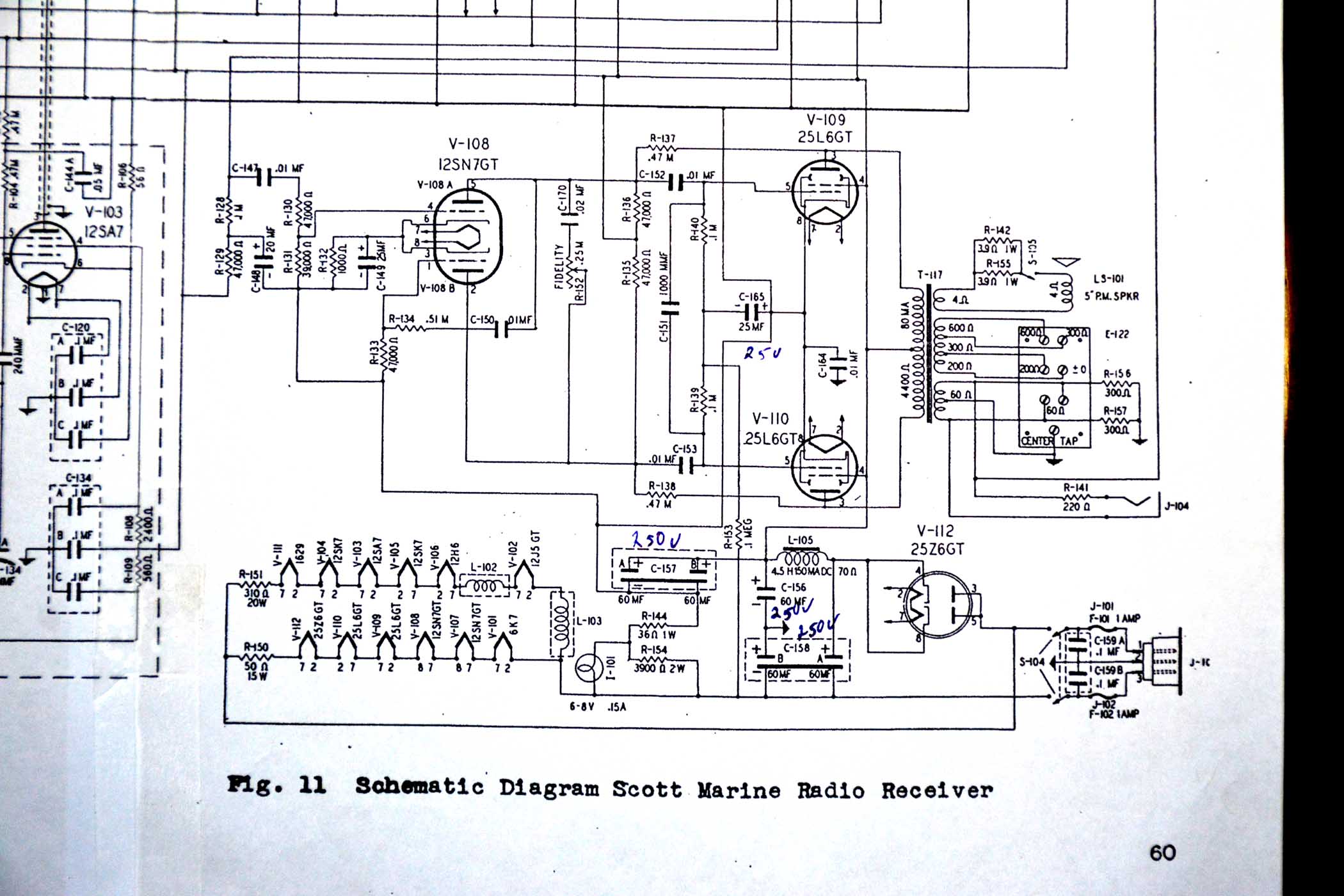

Going from my aging memory, I seem to recall that one of the filter cans in my SLR-H was an oil filled unit rated at 500V or more. If a 450V electrolytic is used here it will leak until it pops as will a tacked-on replacement. I do not know what the oil is in these caps - be careful.

That looks like a bit more extensive of a radio than mine. maximum DC voltage in this thing is about 120 volts so the electrolytic cans were rated at 200 volts. Most of the sections were 60mfd. I used 60 mfd Nichicon's rated at 250 volts. I purchased the caps with the longest life and highest ripple voltage capability. This radio uses a ground buss that is separate from the chassis ground. Chassis ground runs abut 7 to 10 volts negative compared to the ground buss (I can vary that voltage by changing the pilot lamp) and this provides the grid bias for the 25L6's. The ground buss is the negative side of C-157. The negative line is the neutral of the AC in. Notice C-158. The A partition is the first filter cap for the half wave rectifier. The B portion filters the chassis ground to negative line. One would think that chassis ground would be riding some small positive voltage above the negative line. It does not. Chassis ground is about .05 volts negative from the negative line, putting C-158B slightly in reverse polarity mode Very slightly. When I turn the radio off, that voltage jumps to about 20 volts reverse polarity and then slowly dissipates. I get a little concerned about what this reverse polarity will do to the cap over time. Interestingly, there was a 47k resistor across this cap that is not on the schematic, nor is it called out on the chassis as every other component is. I wonder if that resistor was added reduce the effect of the reverse polarity.
Any ideas from some of you EE people who can analyze the design better than I can?

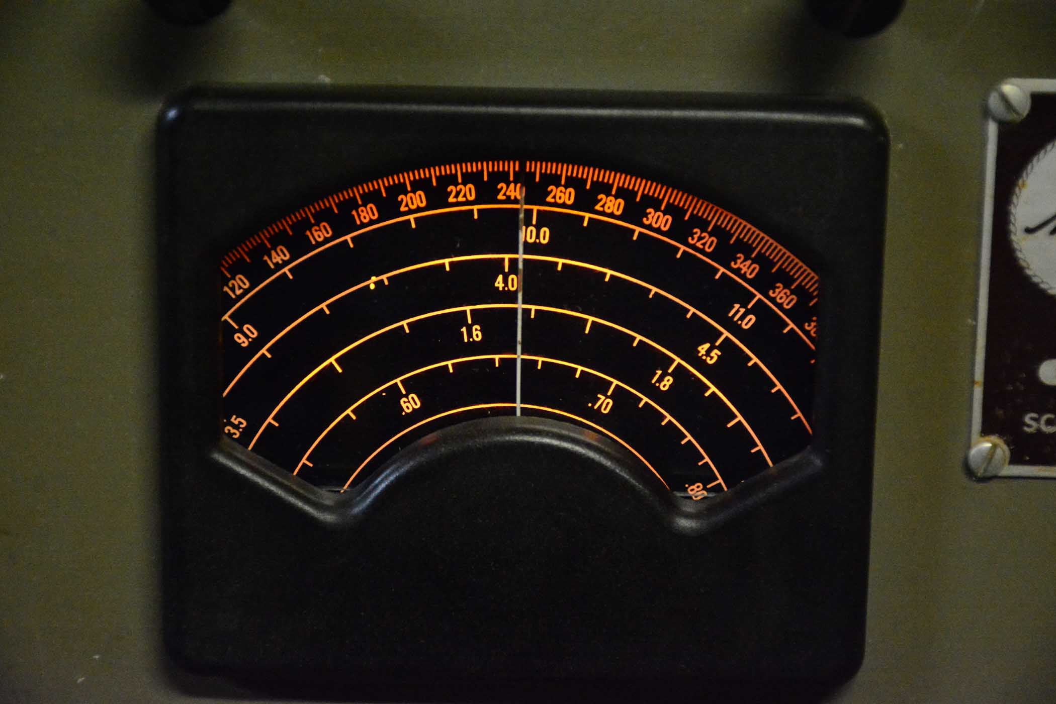

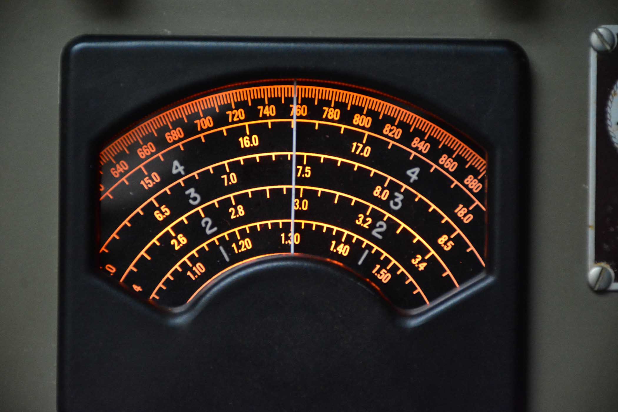

A fellow collector in the UK made a new dial plastic with the band numbers engraved as the original. Nice! Thanks Mike in the UK!
