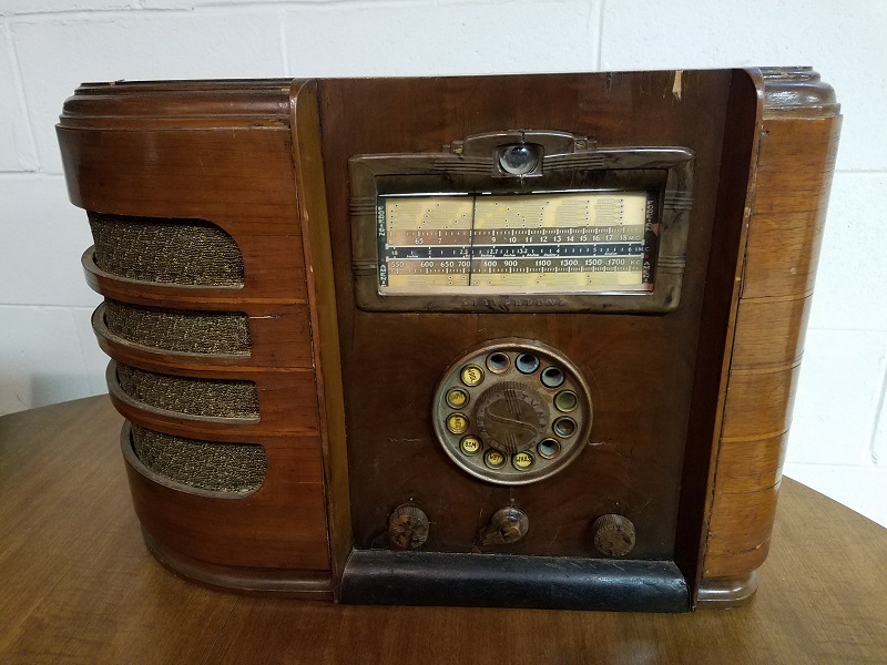

I purchased this at the radio meet two weeks ago...inheriting someone else's headache!  But the Ingraham cabinet alone is worth that I paid for it, so I don't feel too bad.
Anyhow here's what I have. The set was recapped by the previous owner. Grid cap wires were replaced, light sockets rebuilt. In other words, he spent some time on this.
It was missing a speaker, which I had so after hooking that up and bringing the set up on the variac, I was encouraged to see no current draw and all tubes lighting. But there clearly was a problem with the volume control, it was uncontrollable. So I replaced that with a new 2 meg control and at least the volume (and audio output section) is working. But I get no reception whatsoever on any band.

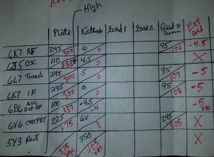

Going grid cap to grid cap I can inject a signal and get a loud buzz controllable by the volume control (ie, buzz gets louder as volume is increased) on the grid caps of both 6K7's, the 6L7 and the 6B6. Voltages all run 40 to 60 volts high, except for the plate of the 6J5 which is almost 3 times what it should be (it measures 288 and should be 110). Here's the breakdown:
The values in red ink are what I measure, to the left in black ink is what they should measure.
So I'm hoping someone with a keen eye (paging Dr. Terry) can give it a look and see what could be causing that voltage spike on the plate of the 6J5. Ohm-ing out the coils is next on the check list but there must be something else causing the high voltage.

So what did you replace the field coil with? I'm thinking that what ever it is it's too lower in resistance making your hv too high. The voltage @ pin4 of the 6V6 should be the hv @ it's highest you are almost 50v too high. Needs to be something around 1K. As for the 6J5 check the heater voltage and R-5 should read abt 30K, M on this set =K not Meg. Do check the osc coils for continuity. If that looks good replace the 6J5. Tech note grid 1 is the control grid, grid 2 is the screen grid, and grid 3 is the suppressor grid.

Not sure what you mean by "on the radio", Mike. Do you mean across the line cord? I checked all of the voltages listed on the schematic and documented them on the chart pictured above. Red ink is what I'm getting, the black ink is what they should be.

I did the math on the plate voltage on the 6J5 and it would appear that it's not drawing much current at all like 5 microamps, should be abt 5ma. From the chassis the the - side of the filter caps should have abt -15vdc. If is 0 then that would add to the high volt 15v. If you remove the cap on the 6B6 and touch the grid cap does it buzz really loud??
The number next to the cathode pin that doesn't have a "v" is indicating the cathode current not the voltage as most a tied to chassis ground so there would be no voltage there.
To get a better idea what the pri of the power trans whats to see measure the heater voltage (6.3vac) and set your variac accordingly.

Voltage shown on the radio is the voltage printed on the label. Say, 117V.
It's not the question of the rated AC voltage but the AC voltage applied now vs the AC voltage at which the measurements were taken then. Then there is input impedance of the meter now vs then.
