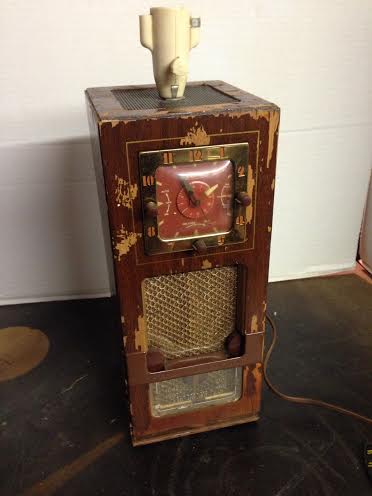

Is there a source for the wood grain covering material used on the exterior of these sets? The one that I have really needs the covering replaced.

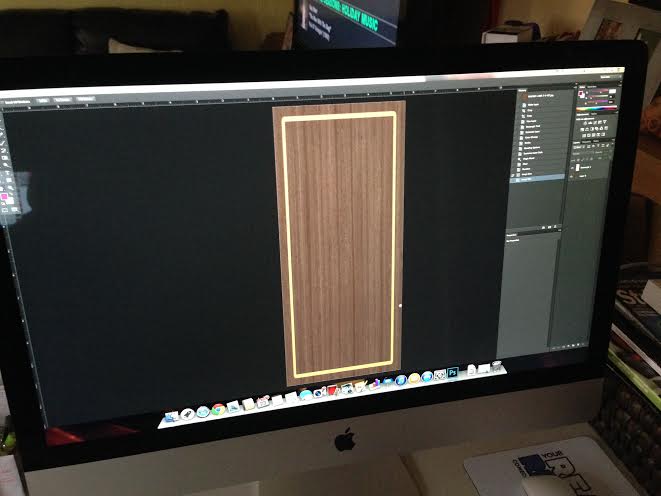

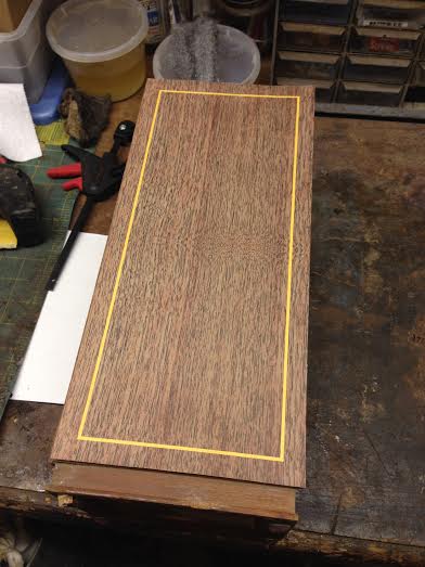

 Replacing the photofinish is fairly easy on these. I did a similar lamp radio a few years ago. All you need to do is find the veneer you want to use and print it on a good printer. Then just use adhesive and attach it. Last is to tone or clear as you would any radio.
The most important thing is to find a proper veneer "photo". I used google to search for a nice walnut grain.
