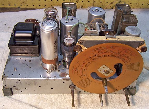

Hello. Wanting to remove this dial for safekeeping while I clean the tuning cap and chassis. I removed the rectangular clip on the front of the dial but the dial stills seems solidly adhered to the hub behind it. Am I missing something simple? Thanks.

Thanks for the video, Greg. That's how the dial on my 620 is attached but the 38-10 is different. Looking at it more closely I can see a thin layer of rubber, as thin as paper, sandwiched between the dial and the hub behind it. That rubber has effectively glued the dial in place. Rather than risk damaging the dial trying to remove it I will clean the tuning cap as best as I can with the dial in place. Thanks for the responses.

Does it have a flat clip like this?
If so the clip slides so that the exposed hole moves over the shaft. Use a needle nose pliers, sticking one end into one of the small holes, and the other end on the opposite side of the center shaft and squeeze.

Yes, Greg, that is what my chassis looks like and yes, I was able to slide off that front clip. As noted above the problem is that the dial is adhered to a thin sheet of rubber between it and the plate that attaches to the end of the tuning shaft. I have elected to leave well enough alone for fear of damaging the dial trying to remove it.
