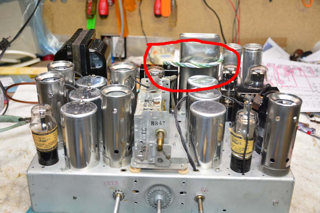

You'll need white, green, and green with white tracer. I used cloth covered green 20 ga. and white cloth covered 20 ga. I couldn't find green with a white tracer, so I just masked the green with tape, leaving a gap every inch or so, and shot it with white rattle can paint. It worked out fine.

Radio Daze for the white and green.  Rhode Island Wire for the wire with tracers.  Unfortunately, the RIW is 18 AWG so a little thicker. Neither is as thin as the original.

The gauge of the wire is important for the current it carries. Since the current is only a couple of hundred milliamps (max out of an 80 is less than 150 mA), even thinner wire would work. The hi voltage requires adequate insulation value. The RIW is only rated at 50 volts. I've tested it at about 600 volts AC with no ill effect. I suspect it is better insulation than the original with cracked rubber inside the cloth.

20 ga. wire is rated for up to 11 amps for chassis wiring, although I would never use it for more than 6 amps. The currents in tube circuits in our radios and amplifiers are far below that, usually well below 1 amp, so 20 gauge is actually overkill. More important is the insulation voltage breakdown. I have found that all the modern cloth covered wire I have tested made these days is fine for any voltages they encounter in our sets.
