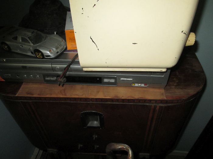

Could it perhaps be like my 201X, only without the inlay?
[Image: https://i.imgur.com/n5IWYhD.jpg]
Not so much the 200X has no inlay on the top nor is the edge routed. The inlay is on the edges.

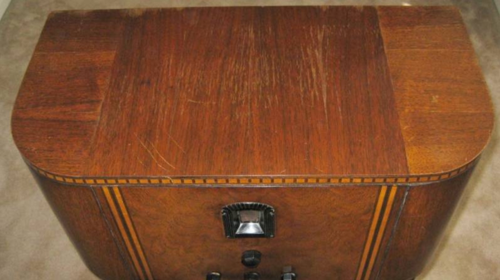

Here you go!
Source: https://www.radiomuseum.org/r/philco_200x.html
Tnx Much!
Though it would face front to back but wasn't sure.
