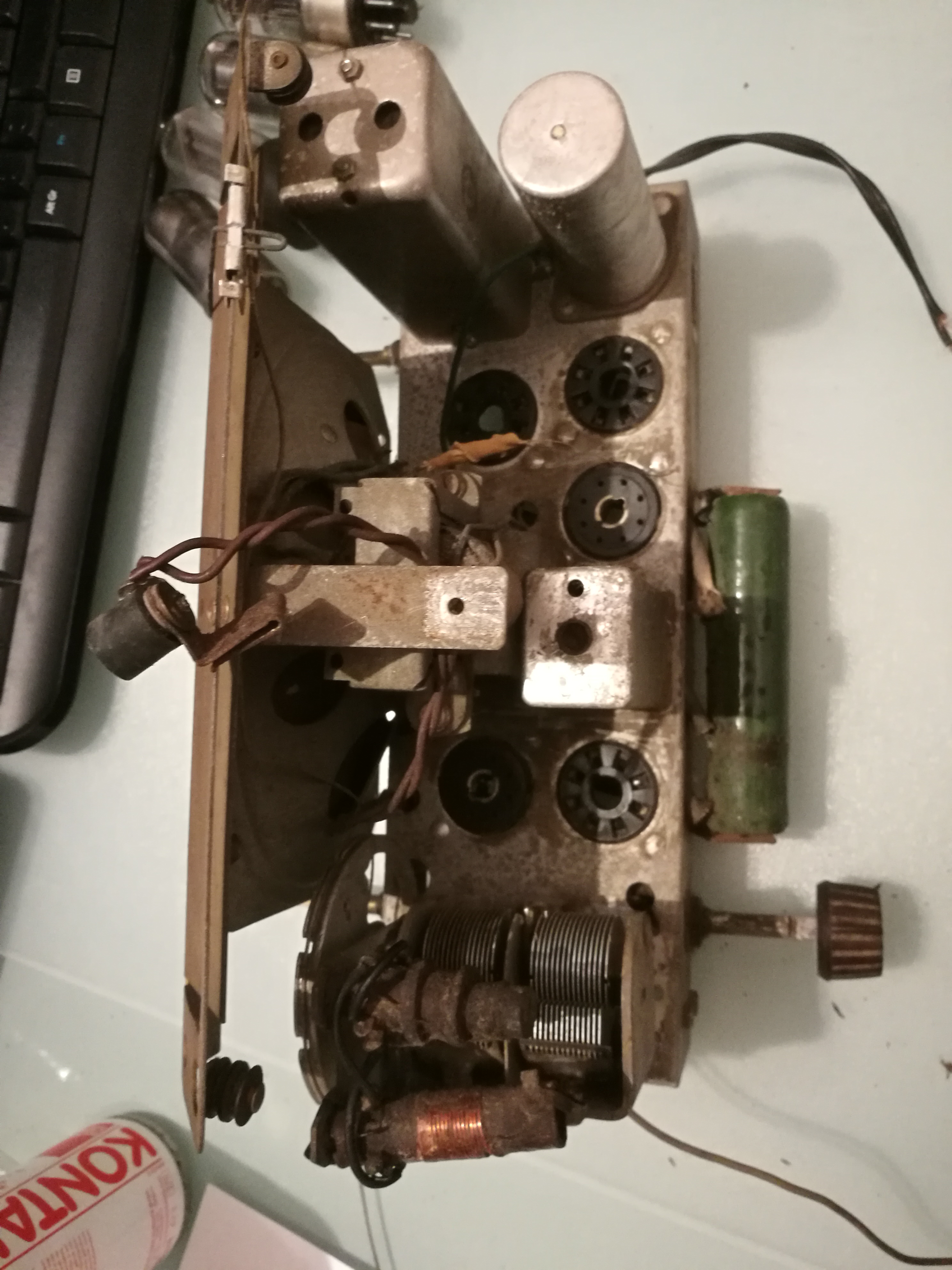

I'm trying to restore a Philco Tropic model B806 made in GB.
It's a complete mess. Although it is similar to model B2806 (LW instead of SW), I really would like to find the correct schematics. As it can be seen on the pictures it will have to go back to bare metal first and I feel I won't be able to put it back together without the correct service manual.
Any assistance is greatly appreciated.
All the best.
Joao

Thanks for the suggestions. I had a reply from Just Radios, no joy.
I'll keep looking around. My main concern is that it went through a previous repair attempt and even the filament connections are wrong. Some resistors look salvaged from another set (R15 for example) and the resistance doesn't match B2806's schematic.
I think I can manage if the only thing that changes between the sets is the tuning part, but will need to confirm that before stripping the B806.
