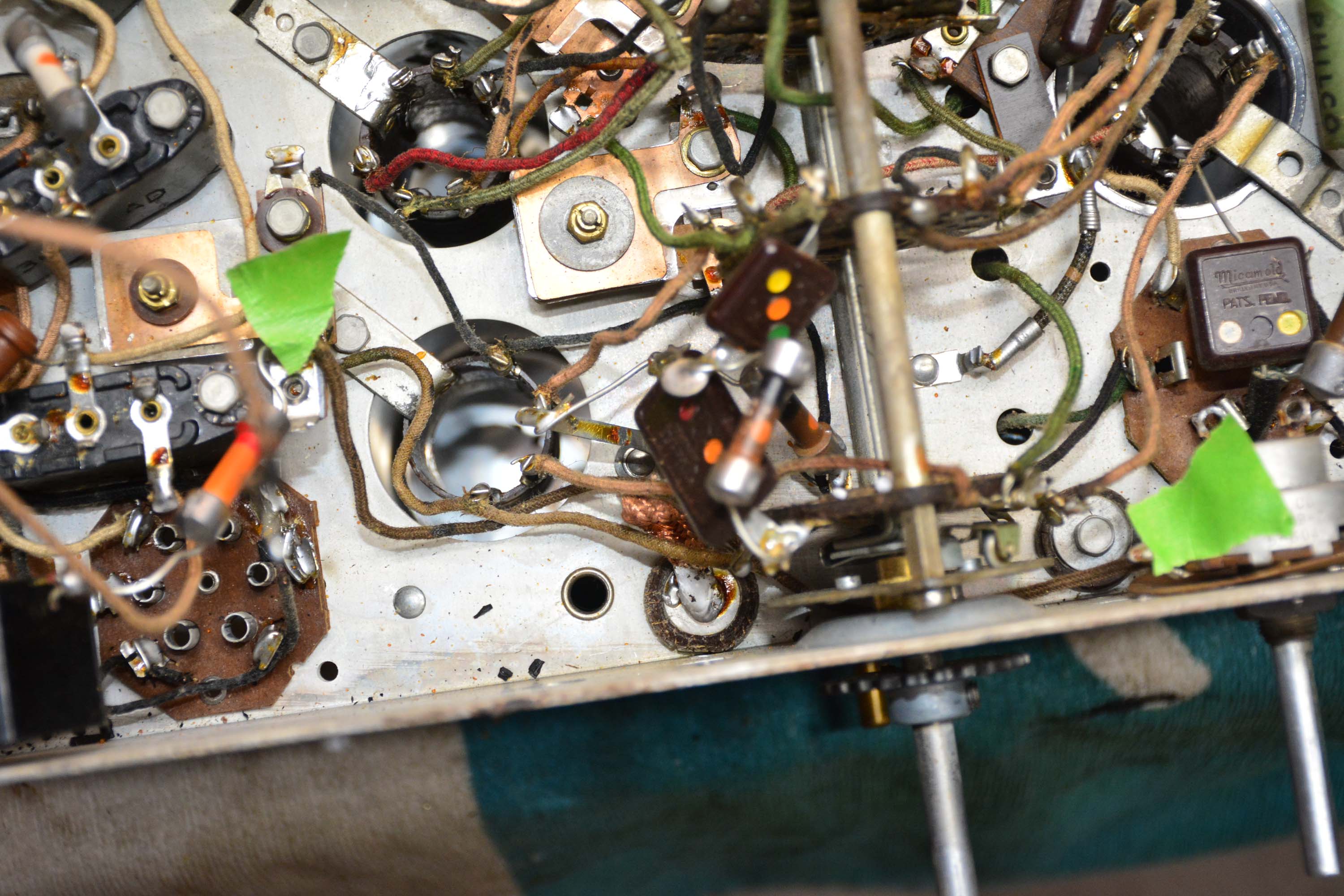

Here you go! Mike is correct. The braid is soldered to the head of one of the tuner screws. It takes a pretty good amount of heat to get the solder to flow. I use a 260 watt Weller D550. The grounded end goes to the ground terminal right near there.

I too used a Weller D-550 to resolder the braid to the tuning cap's mounting screws. It's very important that they are connected, without them the cap is floating (no gnd connection). You may want to add a wire to the third screw and connect it to the gnd lug that is riveted lug near it.

My 16B has 3 grounding straps. The one shown, one soldered to the rear screw of the tuning cap, and one on top of the chassis soldered to a ground tab under one of the mounting screws for the filter choke.
