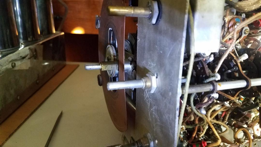

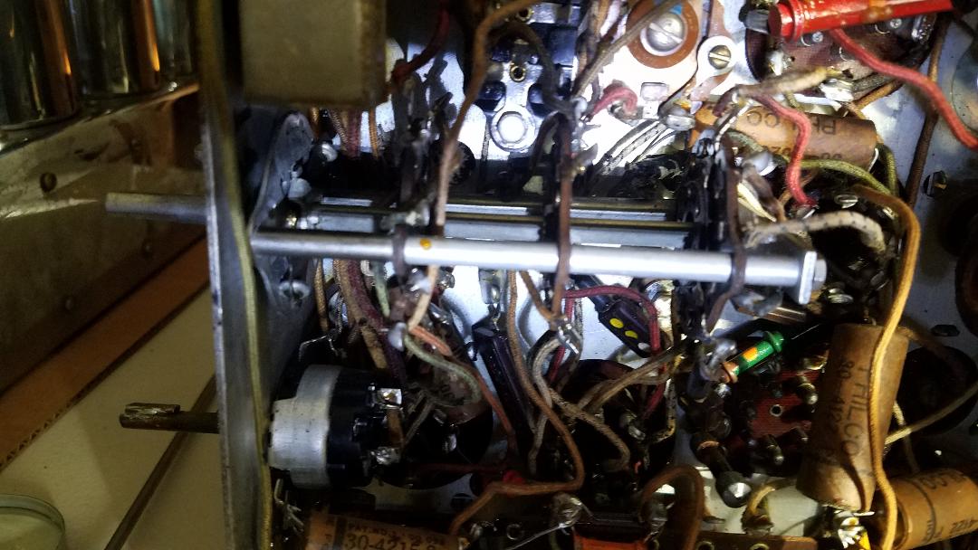

Hi all,
I just picked up one of the cleansest Philco 620F consoles I have ever seen.  The only problem I see in restoring it is... the bandswitch it frozen tight.  Before I do something to accidently destroy this new treasure, I need your collective wisdom.  How do I get it unstuck???  I imagine if there was grease, it's long since solidified.  So, what now?
Thamks in advance for your help!

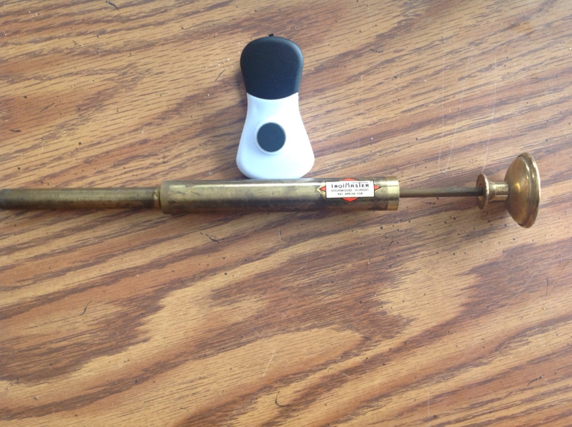

This is where a "TrolMaster" , a device that screws onto the threads of the shaft and allows you to force cleaner/lubricant past the shaft bearing, would be ideal.
Ron

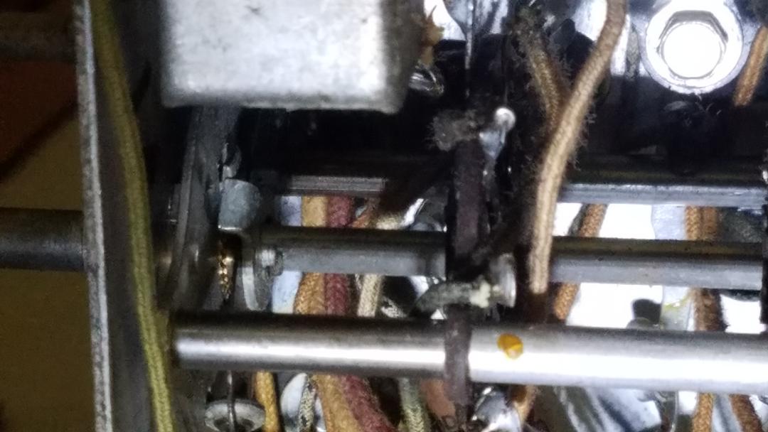

First do a careful up-close inspection. Wiggle-rotate the unit at different locations to bracket the very point where it is seized. Then put liquid penetrant on that point.
Be very carefull with it.
Unlike the switch in the Philco 60/66 which is a cylinder inside another cylinder, in these switches there is little mechanical possibility to really seize something. Possible but the ferrule is relatively short so with good effort it would probably rotate.
This is why before applying effort do make sure it is not one of the wafers that got really stuck, as if you try to overpower it it could break contacts.
Hopefully it is indeed the ferrule and some PB Blaster and heat (and then a lubricant) would do the trick.

Find what is stuck before doing anything:
https://www.russoldradios.com/blog/whats...can-happen
