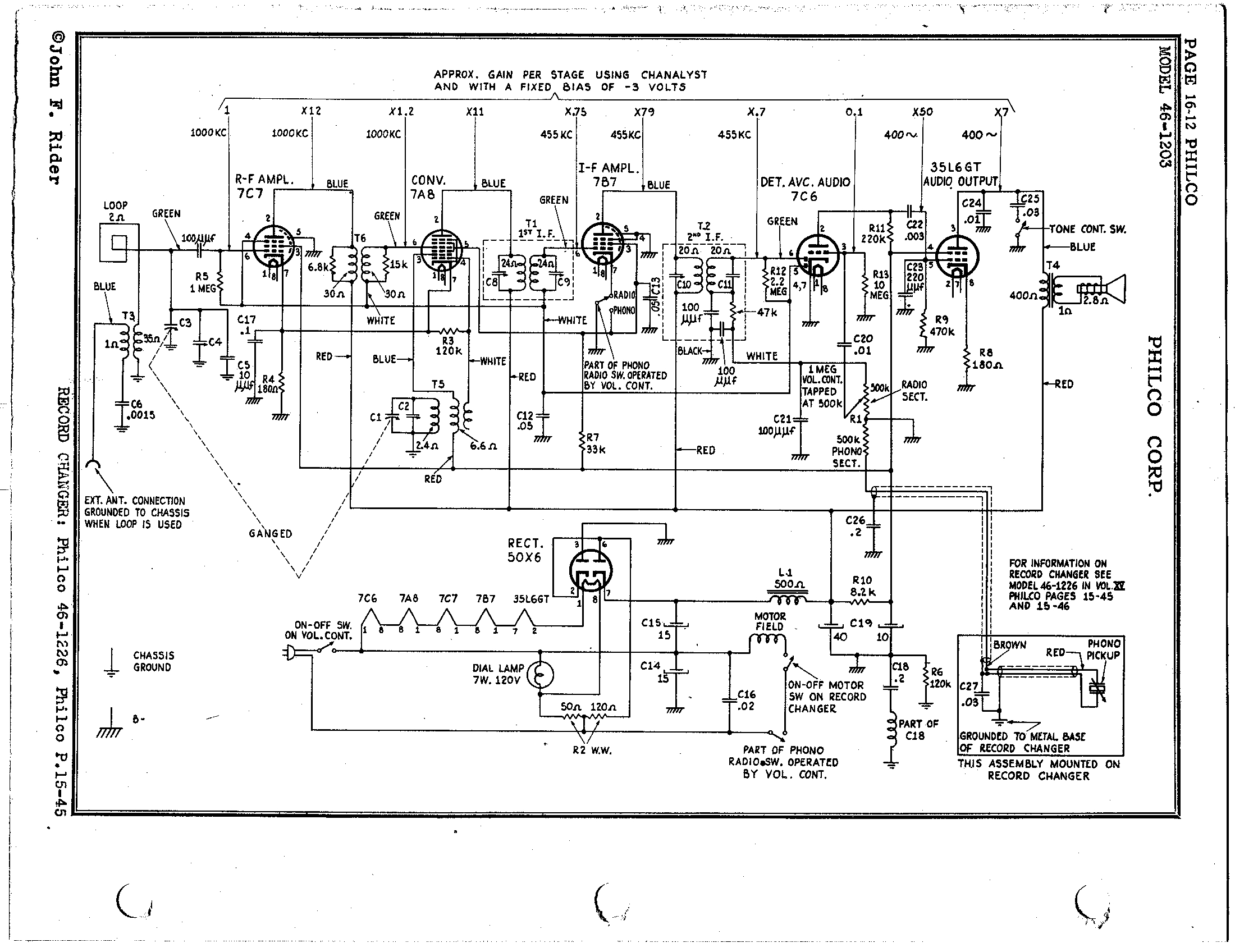

Thanks for the reply morzh.  It has been re-capped and it is working.  The radio is a 1946 Philco model 46-1203.  I have attached a schematic if that helps.
