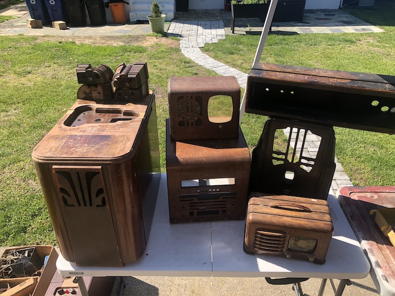

I have had these cabinet for way to long and this is the first spring I actually have some time to get these beauties rolling.
1. Philco 620 shouldered tombstone
2. AK 33 cabinet
3. Philco 503? combo unit
4. Philco Chairside 16RX
5. Zenith Toaster 6D525
6. AirKing model ?

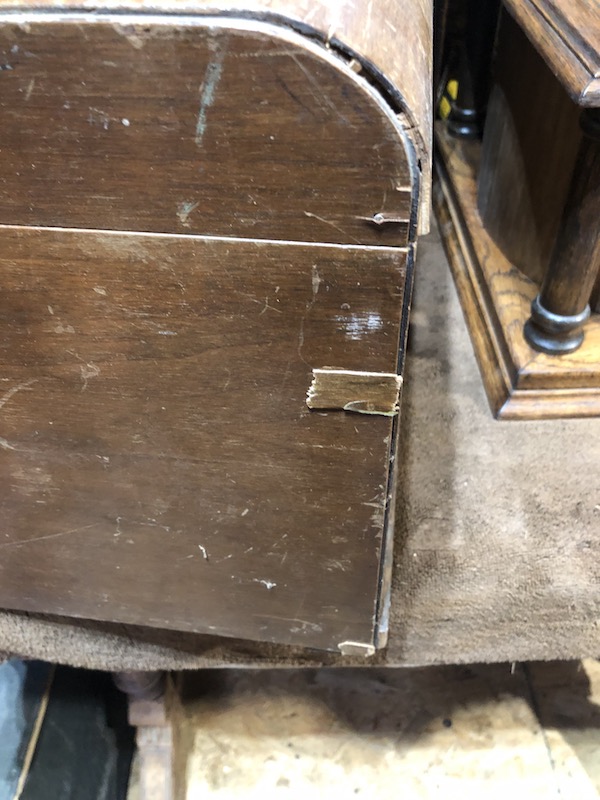

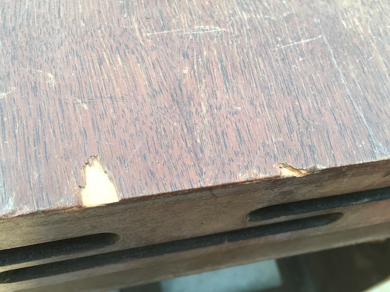

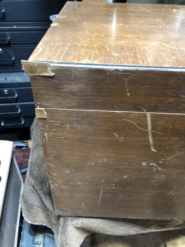

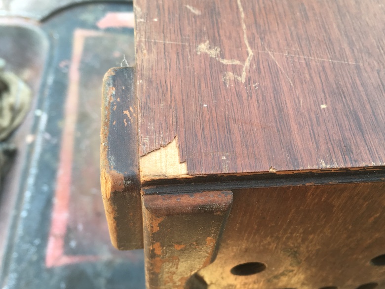

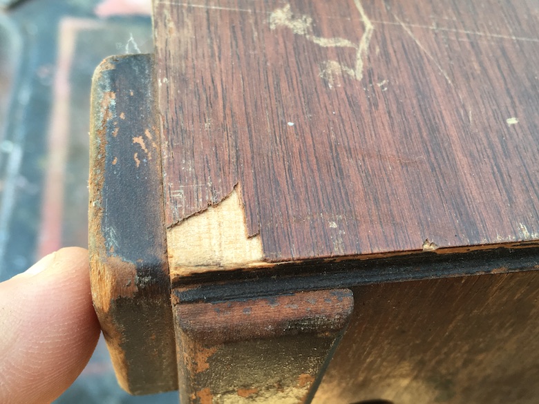

Veneer chunks everywhere!
Repair time...
Show me how to fix the veneer chunks! I don't knew how to do a good job.

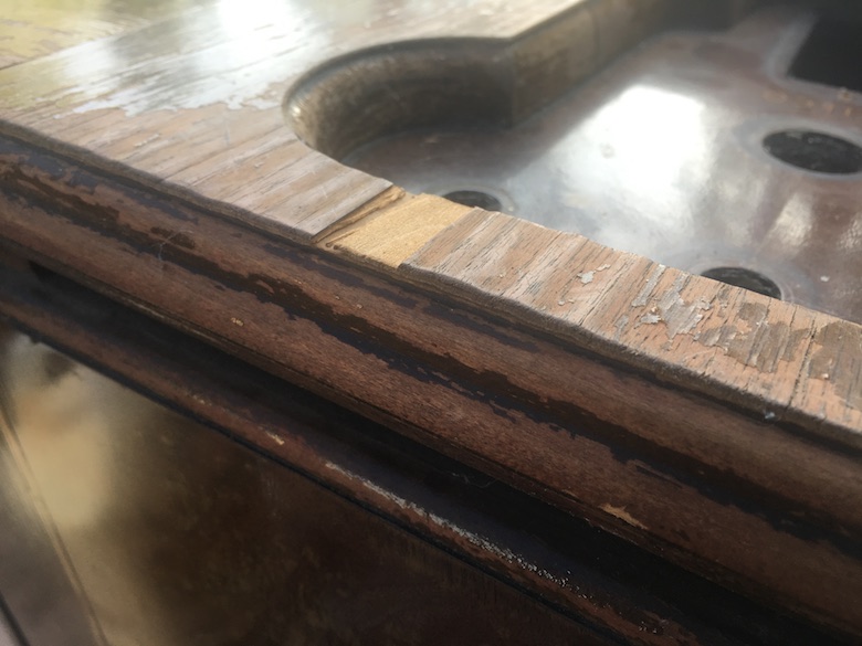

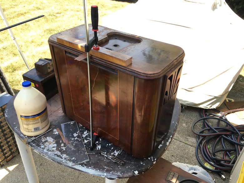

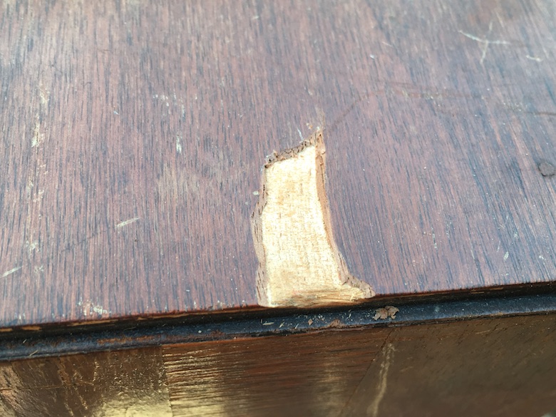

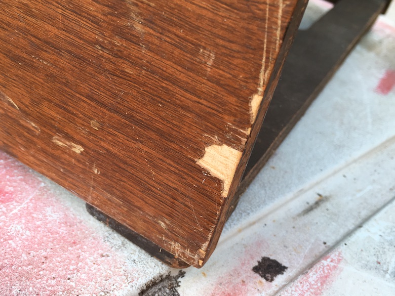

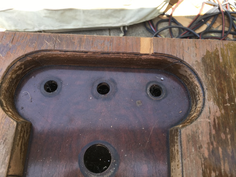

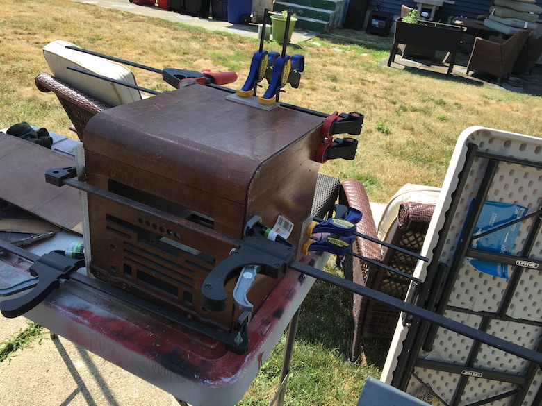

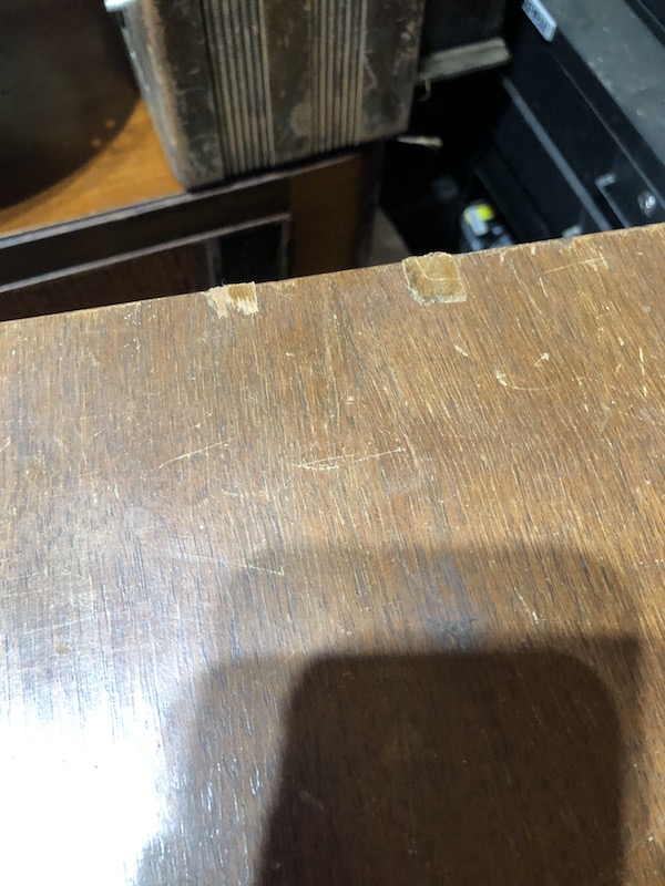

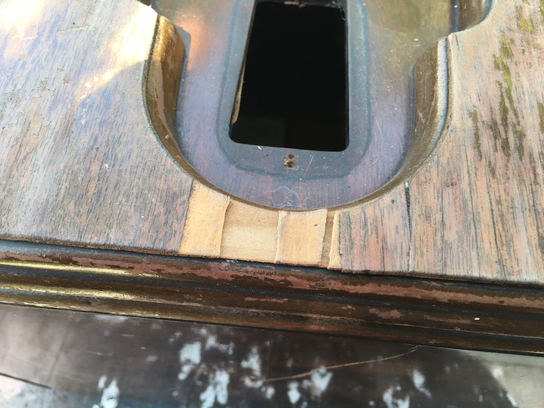

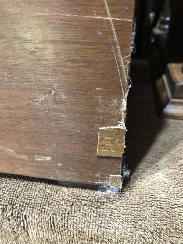

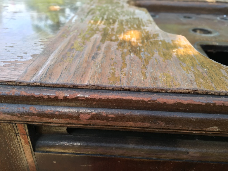

Veneering has begun.
Sams combo unit is most likely going to be re-veneered so I picked up a 4' x 8' sheet of strait grained Walnut.
I have repaired most all the chips and they are now going to be chiseled & sanded.

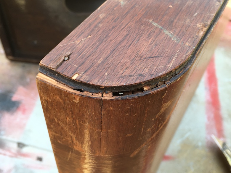

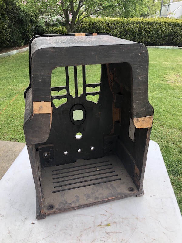

Mikes 620 cabinet is horrid. Everything is loose and separated. Must have been in a basement?? Every time I repair veneer that falls off another piece falls off.  Icon_mad

Icon_lol you a funny guy Mike.... Yes it is the only one I have. Things arent falling off but they are separated so I have to either rip them off and re-attach or inject where possible. No worries, She is going to be wonderful... Then she can warm up your chassis. Icon_wink
It's not that bad Sam and it is definitely worth restoring even with the issues. It is a rare set... Even I dont have one. Icon_evil
