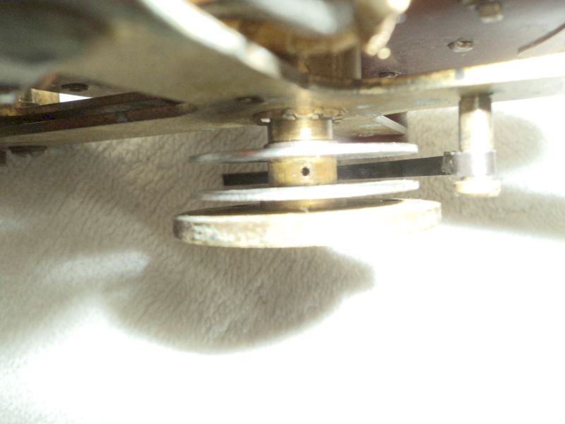

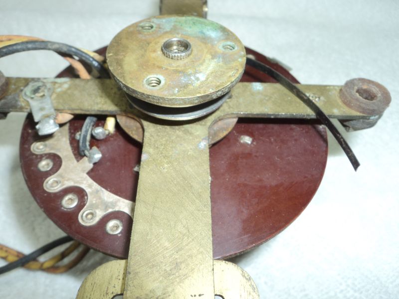

I am restoring my Philco 39-116, and the Mystery control.
In my Mystery control, the dial does not return, because the spring is broken and I only have a little bit.
Does anyone know its length and how it fits inside the pulley, as I only see a small 1mm hole.
See the pictures.

Chuck’s Philco Repair Bench has some detailed info on the mystery control. Don’t know if it discusses the spring or not. https://www.philcorepairbench.com/philco...y-control/
Hi.
Thanks Bob for the link.
I found a spring in ebay and now the _Mystery control work perfect  Icon_biggrin
