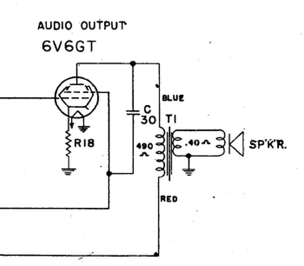

Here's the output stage in case anyone has what you need or more suggestions:

> transformer with a primary impedance close to the tube.
Something around 5-7K is good. An AA5 transformer is too low as it's around 2K.

According to the schematic it looks like one side of the speaker/output transformer was grounded to the chassis which means that the speaker would of been attached to the chassis originally it looks like (unless thats an older version of my radio), which doesn't make sense because the way my radio cabinet was made the speaker was made to be attached to the cabinet not the chassis, and the output transformer wires (or at least what I'm assuming is the output transformer wires anyways) there are two wires coming from the output transformer as opposed to just one if it were actually a case of the speaker and output transformer being grounded to the chassis like in my Westinghouse 182.

<According to the schematic it looks like one side of the speaker/output transformer was grounded>
Don't think it matters much. Should work fine either way with one leg ground of the secondary or not. Just make sure that you do not ground anything directly on the primary side of the output transformer.[Image: https://philcoradio.com/phorum/images/sm...n_evil.gif]

I double checked underneath the chassis and sure enough there is an output transformer there the thing that I was thinking was the output transformer but wasn't sure, was indeed the output transformer as the wires coming up fromt the bottom to the top of the chassis went to the output transformer, what's weird is that off the positive side of the terminal strip where the output transformer and the speaker wires attach to there was a small black wire soldered to it that led to the outside of the chassis and that wire isn't on the schematic, any ideas as to what that wire might be?

The black wire was probably for a second speaker external to the chassis. A 4 ohm speaker should work fine, whatever power is lost in the mismatch can be compensated for by adding a 4.7mfd, 16 volt ecap to the audio output tube cathode resistor or turn up the volume.

Also would that aforementioned 4.7 MFD 16V Electrolytic Cap be polarized or non-polarized, and could you mark on the schematic where that capacitor would go?

Spkr would be ok if it will clear the chassis. The ecap would be polarized and the + would go to pin 8 of the tube - to the chassis
