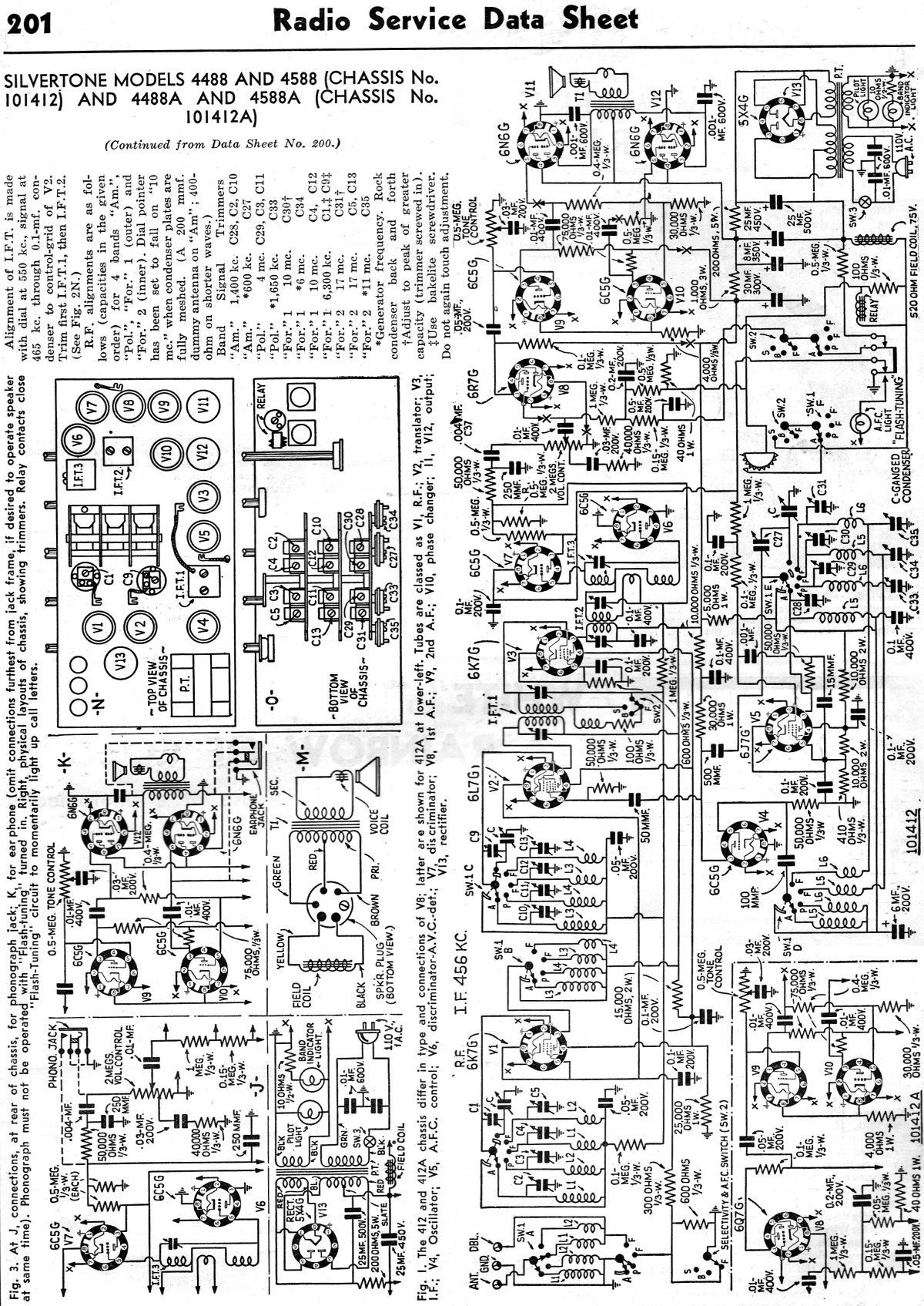

Here is a schematic (my set uses the bottom schematic, with a 6Q7 1st AF tube used instead of the 6R7 shown...Silvertone made some changes to these throughout the model year):
I've been working off of the Nostalgia Air schematic at this link on page 2 of the PDF file (again, the version on the bottom of the page, the 4588 A matches mine and the yellowing paper schematic attached to the side of my chassis).
http://www.nostalgiaair.org/pagesbymodel...017127.pdf
So there seems to be some kind of a short within the tuning switch or relays, as when the BROAD/SHARP/FLASH tuning knob is turned to FLASH, it just motorboats with stations coming in faintly. In this mode, when you turn the separate tone control, lowering the tone increases the speed of the motorboating. When you turn the tuning control the opposite

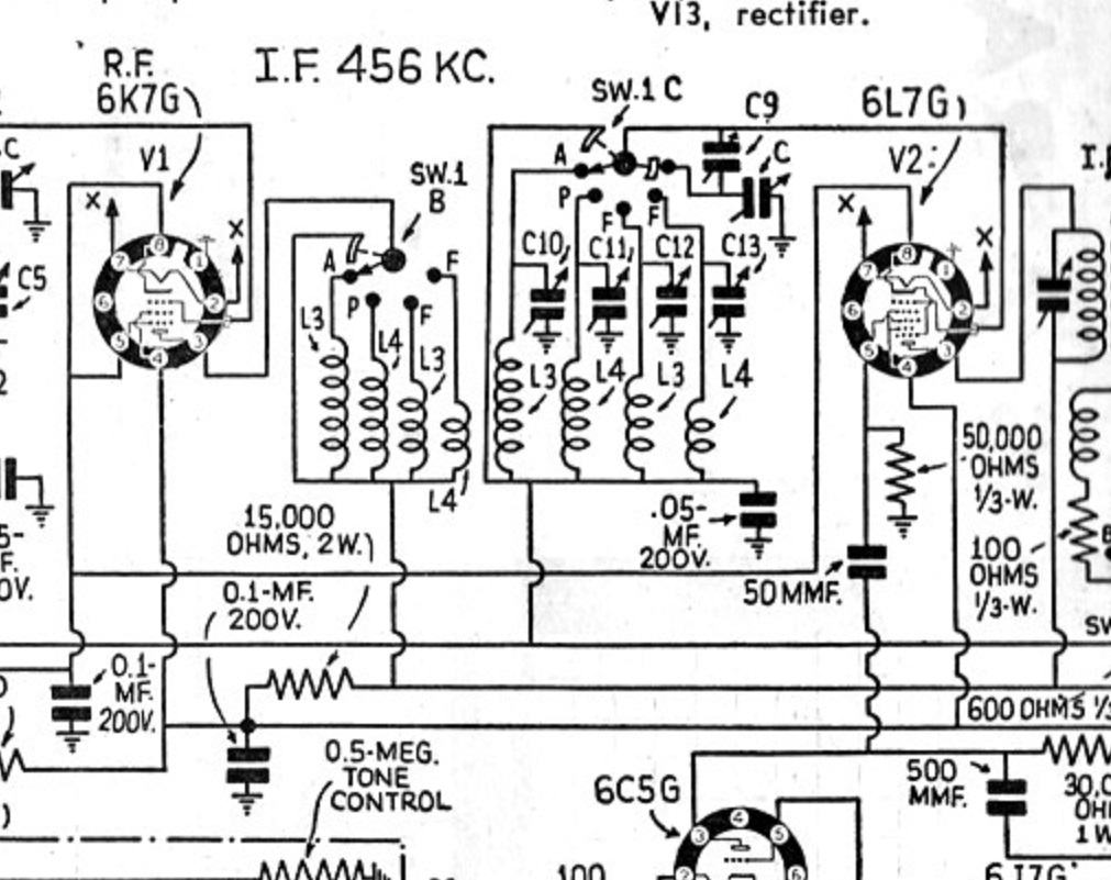

Lots of strange things in this circuit, to me anyhow. For one, there was no connection between pin 8 and pin 5 on the 6K7 RF tube as shown above. The set plays the same with or without a wire connected between them.
And I'm not getting any voltage...zero, zip, nada, on pin 5 of the 6L7 and there's supposed to be a small amount, about 7 volts. I replaced the 50 mmf cap, and the 50K resistor and verified they are connected correctly. I get 88 volts on pin 5 of the 6C5 tube below where one end of the 50 mmf cap is connected, yet on the opposite side of the cap, which goes to pin 5 of the 6L7 I get nothing. I wouldn't think a small picofarad cap would kill all of the voltage across it?
