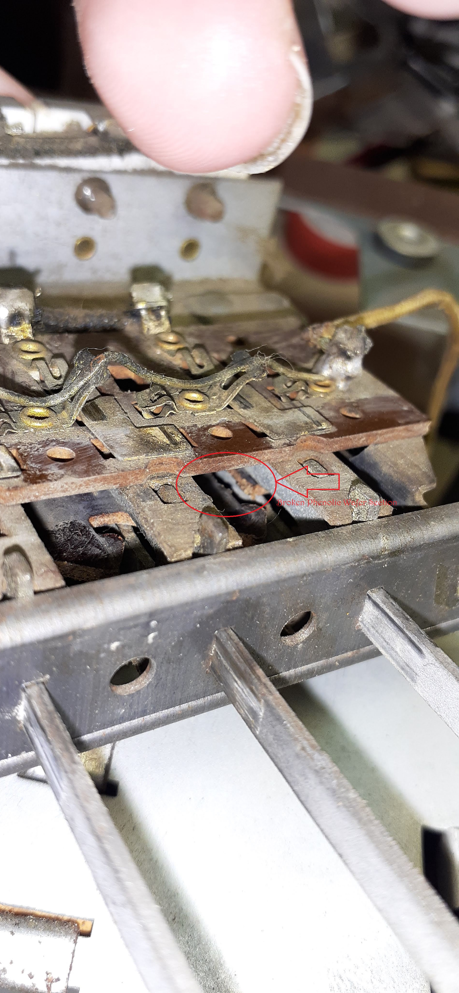

OK, so here's the dealio, the power switch is working its just very sticky (it engages like it should, but it disengages with a little force, which I think its because the pushbutton mechanism needs a good lubing with WD40 or something like that.
However the preset buttons though I think are a lost cause because the little phenolic wafer in there that sets the travel/locks in the preset buttons is broken (see picture below), and unless there's a way to repair that I think the preset buttons are just going to have to remain unusable unfortunately.

The area in the red circle is the broken phenolic board joint.
That's the phenolic board piece that helps control the preset push buttons, unfortunately because it's broken it don't allow the preset push buttons to function anymore, the power switch isn't affected by that phenolic board.
Posts: 16,510
Threads: 572
Yeah....that will take a replacing to do. Phenolic boards, especially those constantly moved, do not glue well at all. And that is, if there is something left to glue to.

I think he has pieces broken off that are no longer there, so there is nothing to glue with.
If he finds other parts to cannibalize - then yes, but then no gluing would be be necessary.
I was able to repair my Zenith tone ctl switch but then that is not moved often, and I since glued it once again. Think phenolic wafer.....many people break it when pulling Zeniths' chassis out of cabinets.....I had to gain my own experience

All the parts are there for the phenolic board it's just whether or not they can be glued back together and stay glued.
There's a spring and metal clip holding part of the phenolic board into place that I can't seem to get to come loose, that's what's holding up the works right now, and that spring is what causes the push buttons to spring back out when you push another button in.
