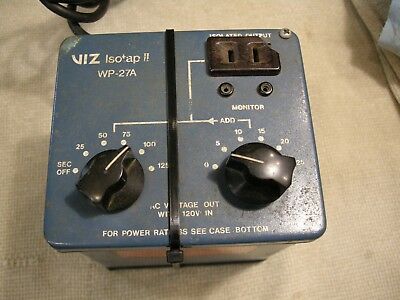

    Hi Link..I’ve been using a RCA Isotap 11 WP-27A that I bought over 40 years ago. I believe it goes by VIZ Isotap now. It is an isolation transformer with output from 25- 150 volts in 5V steps. All in one unit. Can be found on eBay or other sites!
Ron

and thanks for the VIS isolation transformer suggestion that would be a safer bet. i seen one just like it but the paint is in rougher shape on ebay.
im thinking of getting separate units an isolation transformer and the variac. i have other uses for just the isolation transformer half that i dont need the variac part for.
not sure what to do though. i should be able to plug a variac into a isolation transformer and it work safely making sure to pair the two with the same VA rating. its a little more costly though.
